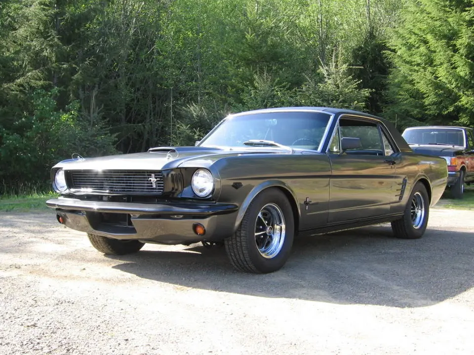

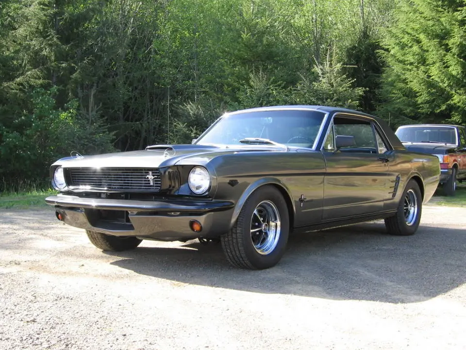

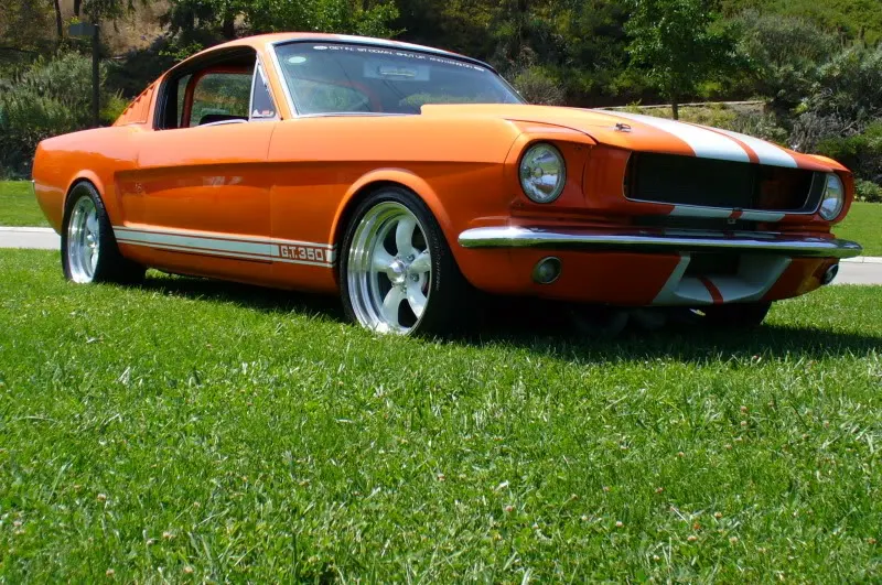

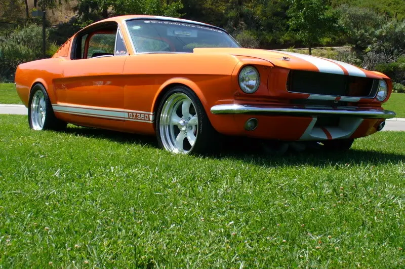

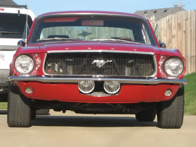

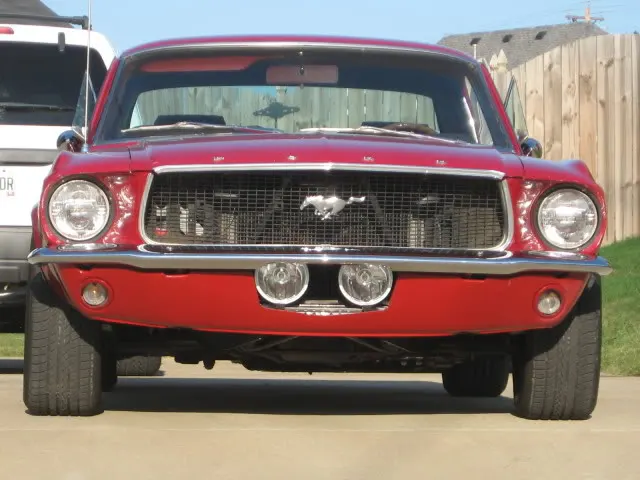

I had good luck with a repop valence, it fit fine and I had a trans cutout done to it. If I do another (want to add brake ducts) I'll probably buy the OT and do trans cooler cutout and brake ducts.
Jon
I should have taken a pic without the driving lights I was testing to see if I liked the look, pulled them out and will probably put them in/behind the grille.

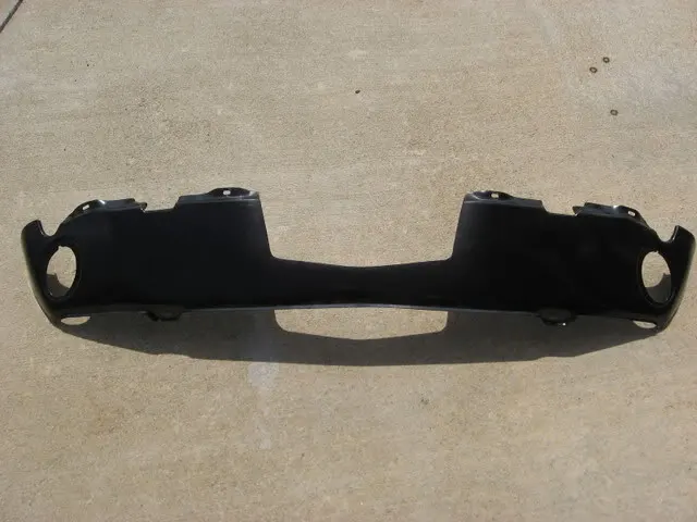

Well im not taking another chance on a re-pop, it had a bad bend in it, it was nearly and inch off on the drivers side, since it was only 35 bucks the body man said it would cost me more for him to try and fix it instead of just get another one. I'm not going to modify a steel one if i get it, it does look nice, but I don't have any time left, this guy has had my car for 8 months now and im ready to get this thing back. If nobody comes forth with any good info about the plastic or fiberglass ones then im just going to get the OT steel one.

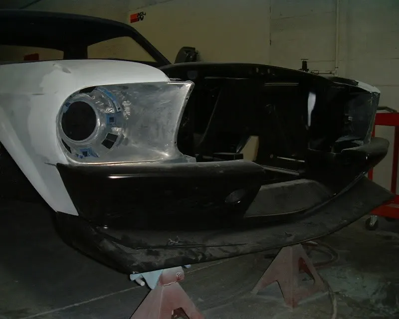

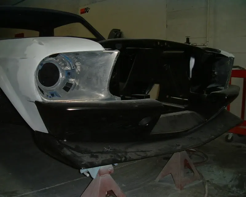

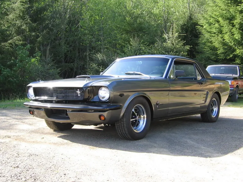

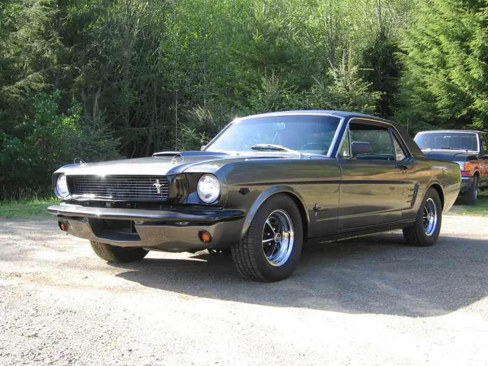

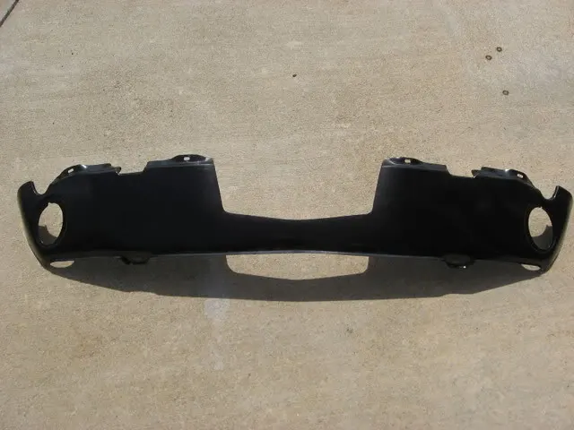

I got mine from mustangs unlimited. Required some work, but wasn't to bad. The fenders and head lamp buckets were repo, so not sure which one was out but I fixed it on the valance.

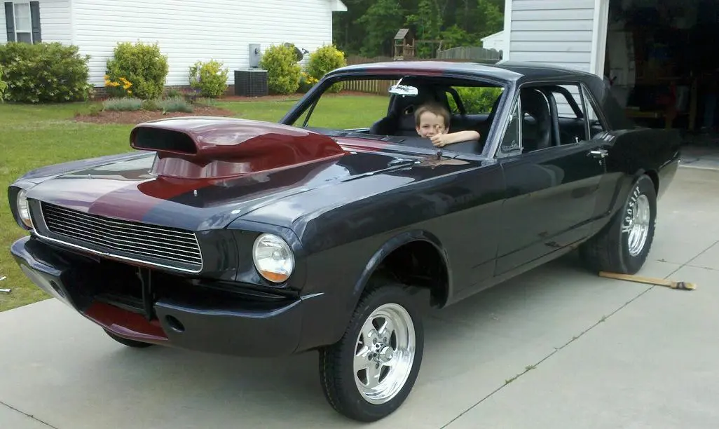

i bought a plastic one a number of years ago, but i have yet to try and fit it up. i believe i got it through autokrafters. it does seem though that it should fit reasonably well when compared to another fiberglass one i got many years ago that was on a car.
