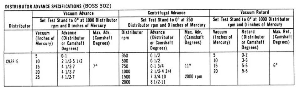

Please tell me if I'm reading this info correctly:
Given that the curve is specified at "distributor" RPM and "camshaft degrees" all the numbers are actual supposed to be "double" what is listed, when standardly testing with a timing light on the crankshaft, due to the crankshaft turning twice for each turn of the cam and distributor? I am assuming that all timing on most engines is done by crankshaft rotation reference? IE: 7 degrees maximum vacuum advance at 20 inches vacuum is actually 14 degrees and maximum centrifugal advance is 22 degrees at 4000 engine RPM?

Thank you sir! It's nice to confirm assumptions before/instead of just acting on them! I would also "assume" that we would ignore the vacuum retard specs, unless of course we were dealing with a concourse calibre vehicle that actually had one of those goofy dual diaphragm distributors?

that depends. are you building a super or turbocharged engine? if so the use the retard function. run the boost line to that diaphragm and you get an automatic boost retard feature.
