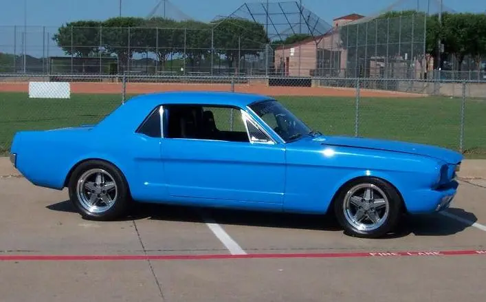

My car has 16x7's on the front with a 225/50 and it only rubs pulling up into a steep driveway. I lost how low I lowered it but it's prob about 2-2.5" drop.
