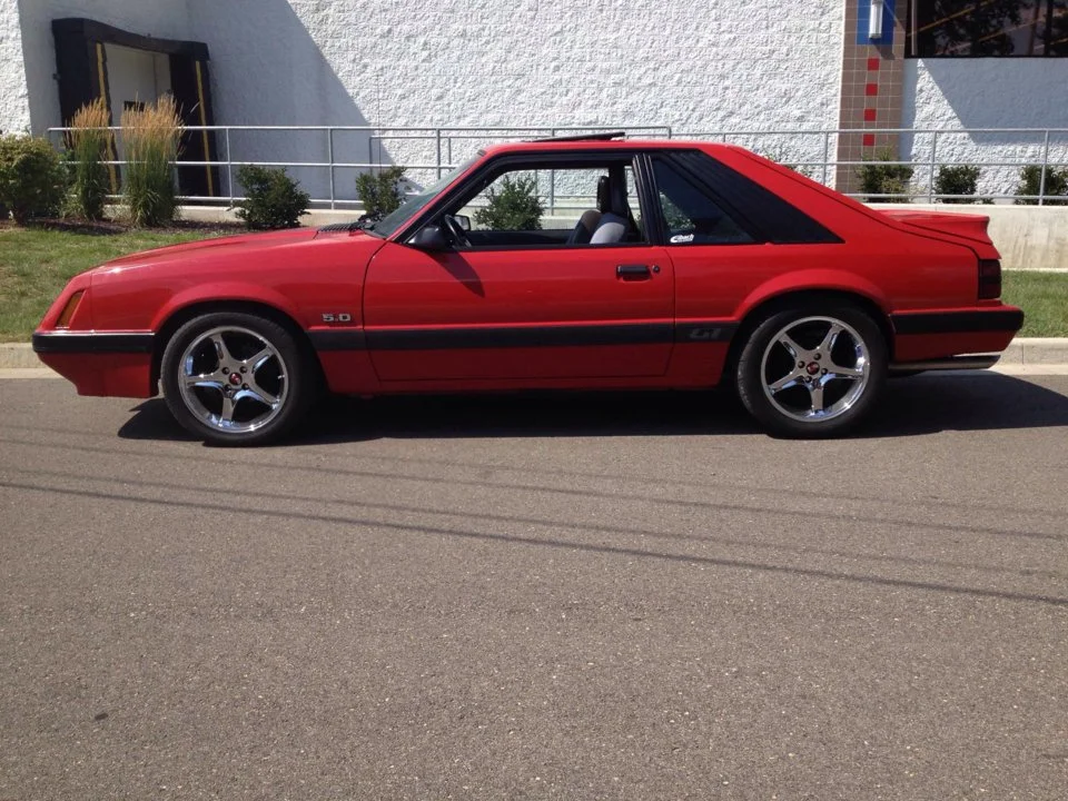

Ford B springs WILL give your car a rake.

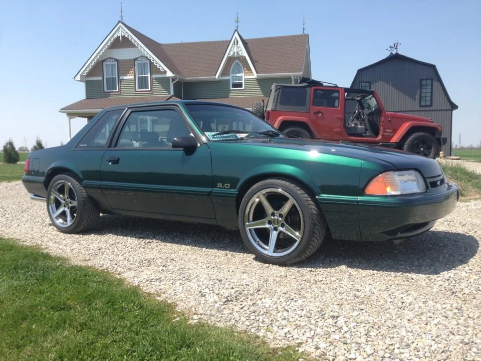

I'm not sure on the 16's rubbing but I'm running 17's on my 86 without a problem. Here's how it sat with eibach pro kit,mm cc plates, and UPR bump steer kit. 245/45/17-275/40-17 in rear.

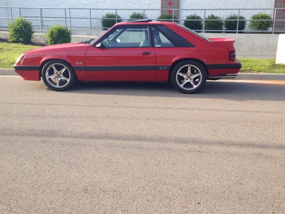

This is mine with the coilovers in front. I actually like the "raked" look and have team z drag springs in back. These are slightly lower than stock. Front tire is turned in pic so looks weird. I can adjust the front up and down And set the ride stiffness. I have almost 400 miles on new setup and love it.
