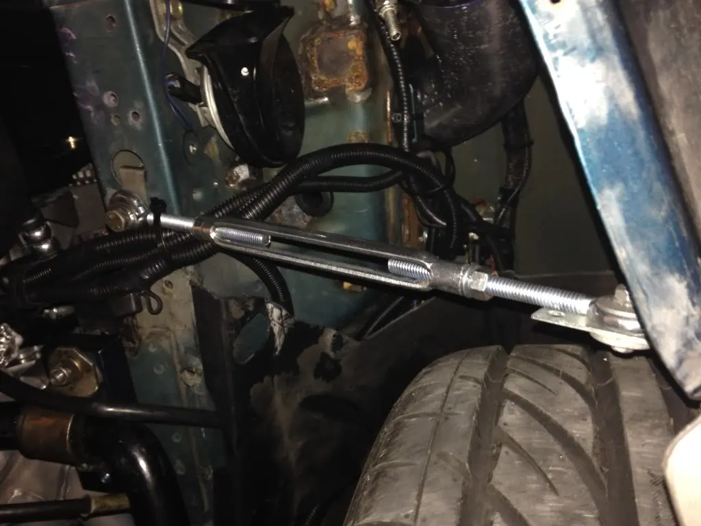

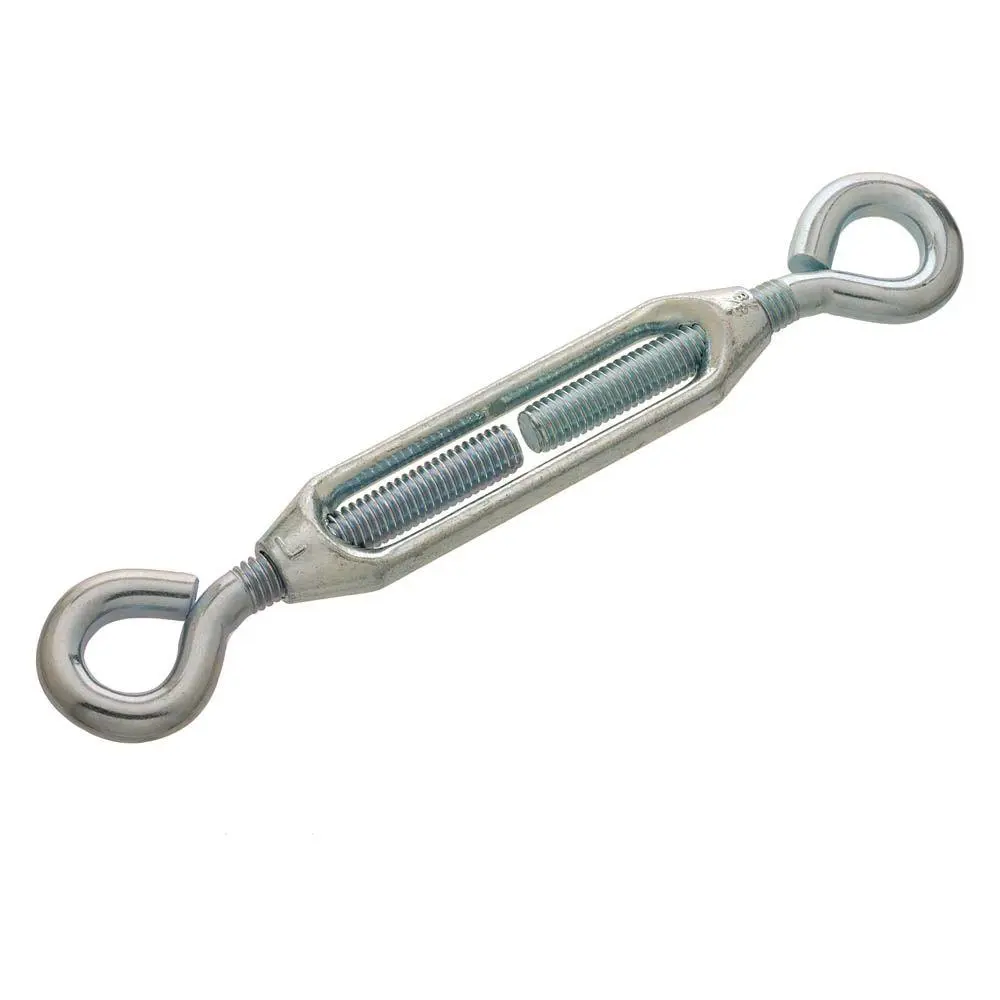

There's a mod where you put one of these between the bottom front of the fender and the frame. It pushes the fender out a little to help with tire clearance.
It's attached at the lower corner behind the ground affect on the metal part if the fender ( before wheel opening ). It then bolts to the frame. Two "L" brackets are also needed. Combined with trimming the gt ground affect it should give you the clearance you need. Various size turnbuckles are available at Lowes and Home Depot.
I may look into this. Do you have a link to a article for the mod? I've already had the fender lips rolled, but it is rubbing in the wheel well at the bottom front, on the ground effect liner area. I expected I might need rack limiters but this happens at maybe half turn.
