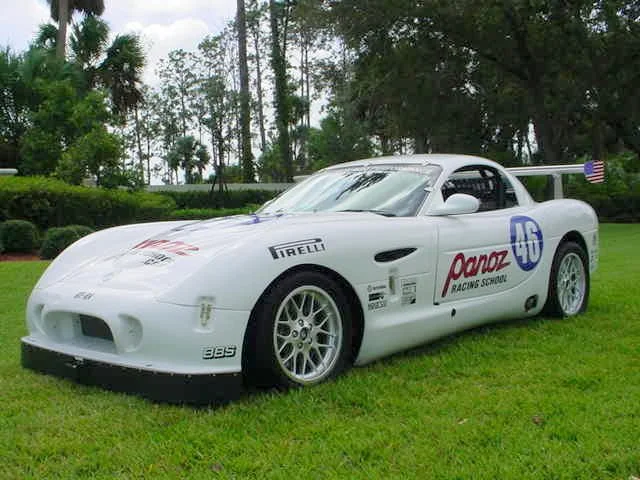

Well things have taken a turn... I'm getting a Panoz GT-RA for a track only car.

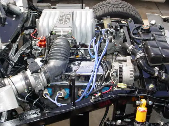

It's powered by a 5.0 w/ a K&N, headers, and straight pipes... they're around 250 crank HP.
Can anyone tell what I'm getting here? I'm assuming it's a stock 5.0 so I have a few questions:

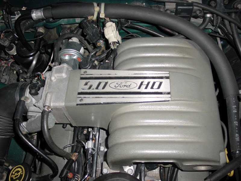

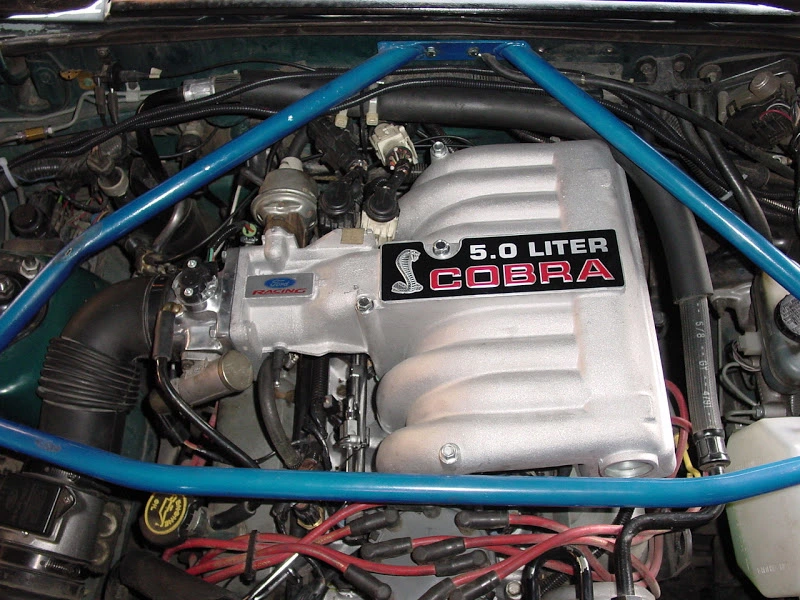

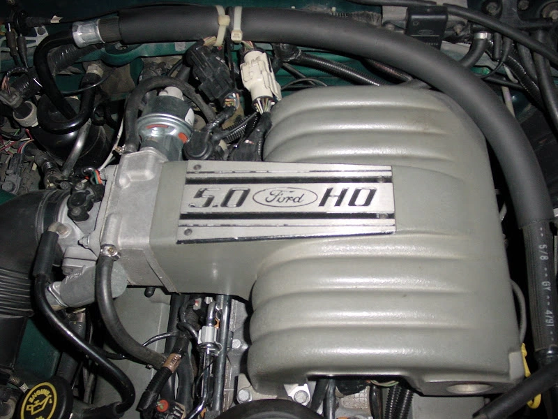

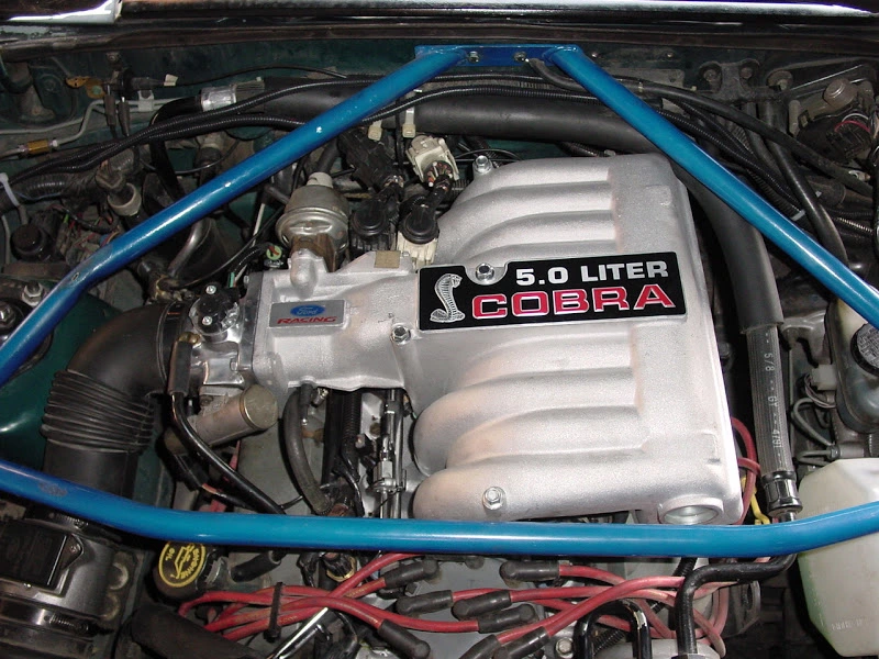

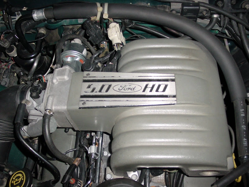

That is not a stock intake. It looks like a cobra intake with the ports staggard like that, but I don't think it's a cobra either.
Stock
Cobra
Stock
Cobra
good point, i didn't even notice that. it's an explorer intake. pull a valve cover if you can. if they're gt40p heads, it'll say 'GTP' if i remember correctly.
Why would you go to all the trouble of removing the upper intake and pulling a valve cover to check if they are GT-40P heads?
There are 2 ways to distinguish the GT-40P heads without removing anything.
There will be 4 cast in vertical bars on the end of the heads with the accessory bolt holes (regular iron GT-40 heads have 3 cast in vertical bars). The other way is just to look next to the spark plug holes by either the #1 or #8 cylinders (looking at the exhaust port side of the heads, all the way to the right), if it is a GT-40P, it will say "GTP". Regular GT-40 iron heads say "GT" in the same location.
1. Is that a stock intake manifold?
2. Are the 5.0s iron blocks? The ones in the Mustangs?
3. Is it a 4-bolt main?
4. How much power can I get out of H/C/I?
1. That is an explorer intake. The Eplorer/GT40/Cobra intake uses the same gaskets for the runners so they look similar. Note the "5.0' plate on the intake. It look identical in shape to a stock 5.0 intake's plaque. This is how I know it is an explorer intake and not a cobra (gt 40 looks much different than either).
