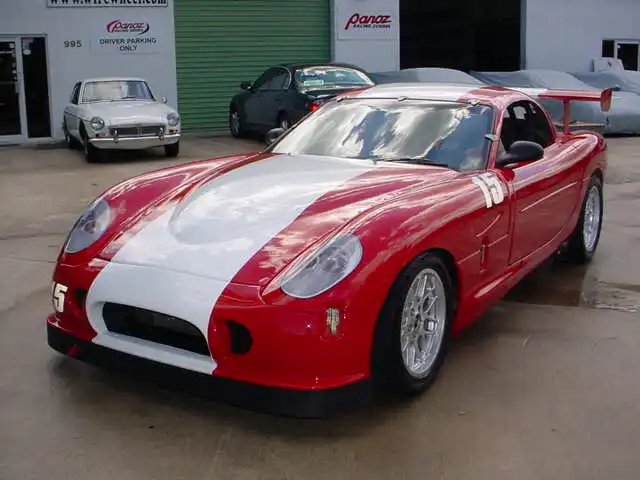

Thanks Ed... turns out the car I pictured isn't the same as all of them. The one we have on hold is a plain jane stock 5.0 :( I'll most likely rip it out this winter and add a stud girdle and top end... shoot might just go w/ a 331 from the get go.... ugh the idea here was to not spend more money, but 250 crank hp is crap and gets me 10lbs per HP.
Just check the year and condition of the shortblock before you tear into it. You would be surprised what can be done with those lil 302 engines. ;)

Closed the deal on the actual car today... this is one of a few leased by penske and re-painted for promotional work. The body/paint is 10000x better than the other school cars.
Here's the stock stock stock 5.0
