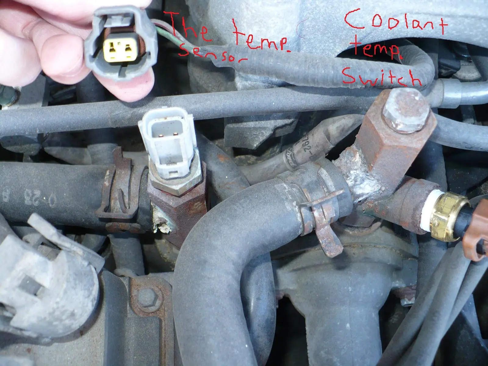

As far as where the temperature sensor's are, here are pictures of mine and where they are on my v6 3.8 '98. I just replaced the switch today because my horsey mobile's previous owner put straight water into the you know what. Well, after new head gaskets and water pump, this is where I'm at. even the sensors were effected by it, and for a while I had the wrong sensor in the wrong spot.
Even if yours doesn't look like this, you may still be able to tell the sensors apart. If you find these plug like things on your mustang, then there's probably only two of them. I only replaced the one on the right, and that one had an end that wouldn't fit the plug you can see on the left. Even if you mess up, I did too. I put a different sensor, which probably belongs in the left one, still need to try that, into the right spot you can see in the picture. The only thing I could notice is that the temp. gauge went especially left when I started the car, and did not work. It didn't blow up or anything...I had the sensors mixed up because the one they gave me didn't have any grooves on the outside, so it didn't matter what plug I tried it on.
The other difference I noticed was the coolant temp switch seemed to have a cylindrical end while the other odd ball one I got had a cone shaped end. I don't even know if the cone shaped one is the temp sensor (on the left) or if it isn't even for my '98. All I know is I put that temp switch in and now my gauge actually works for once and my check engine light's off. Hope this helps some.
