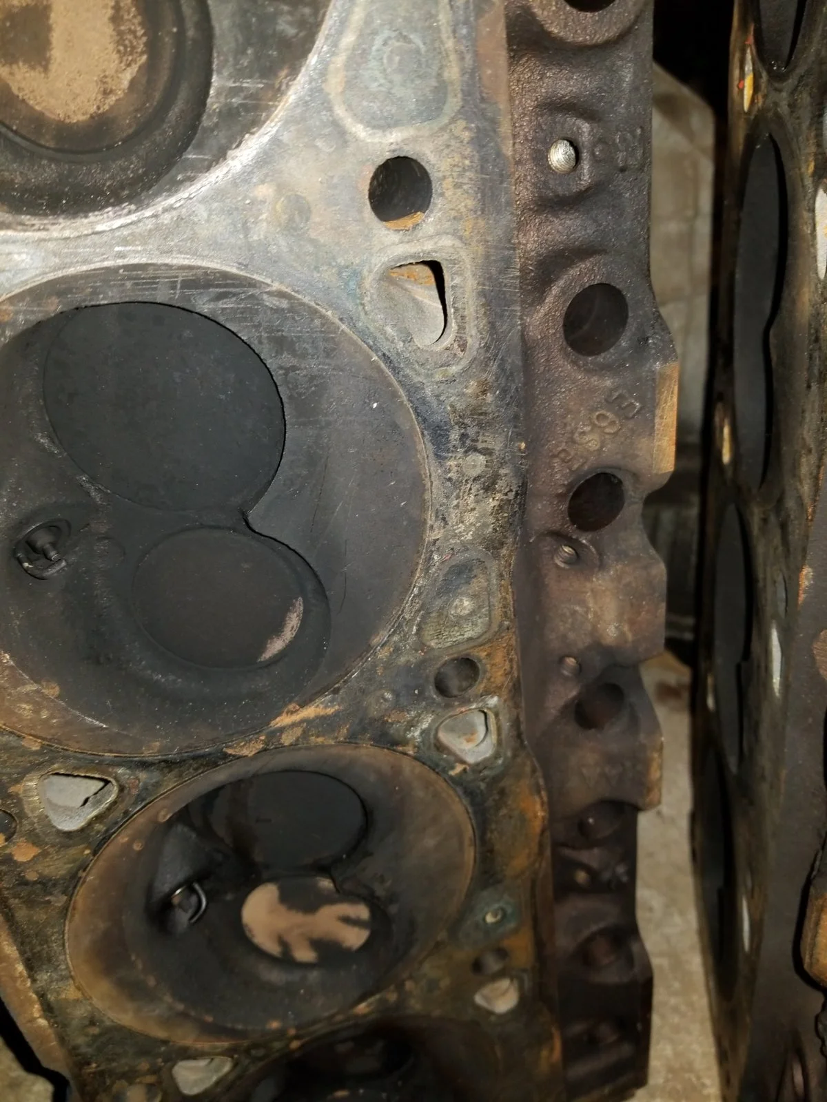

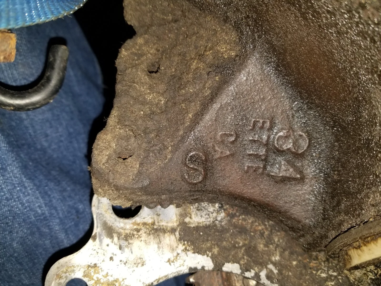

I do know the camshaft numbers should be right behind the camshaft gear.

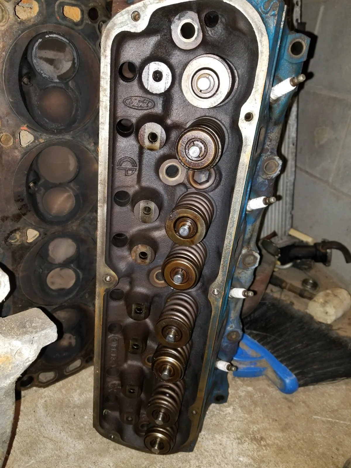

The gt40 heads flow a lot better than the mustang e7 or truck heads.
I've seen people use gt40 heads with short Accel header spark plugs and 90 degree plug boots with BBK headers on mustangs.
A stock mustang engine had 225hp....the gt40 heads, intake, and aftermarket camshaft should get around 300hp relatively easy.
