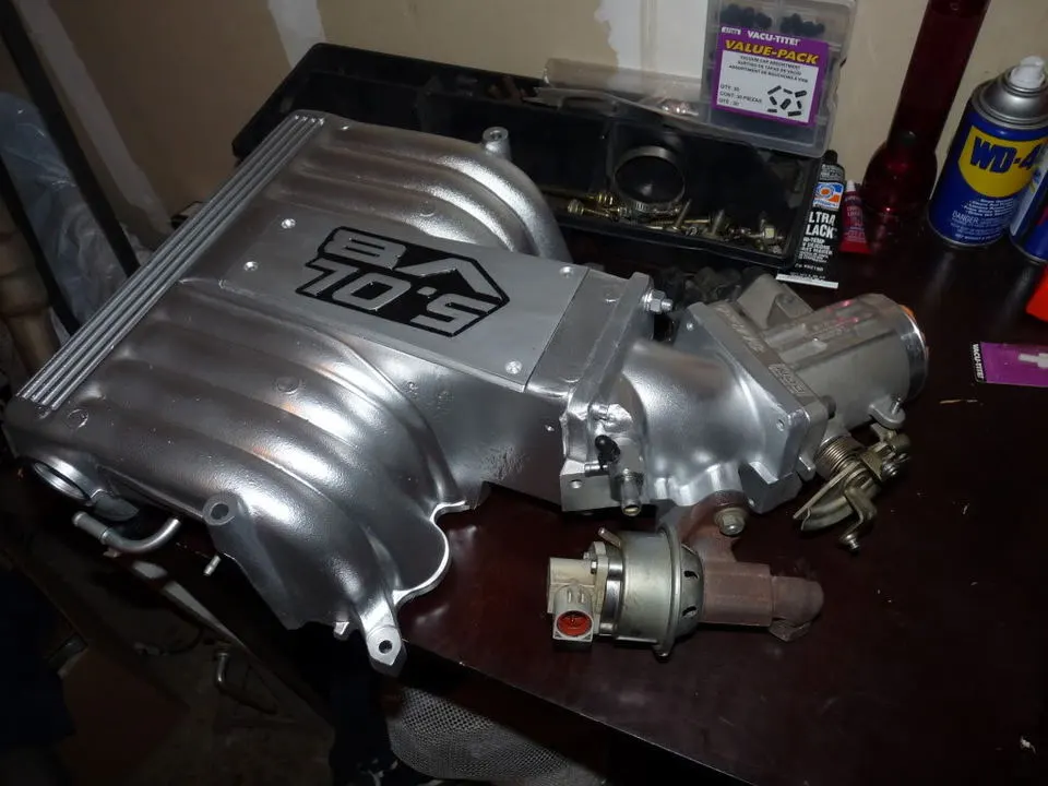

what does the thing im holding go too

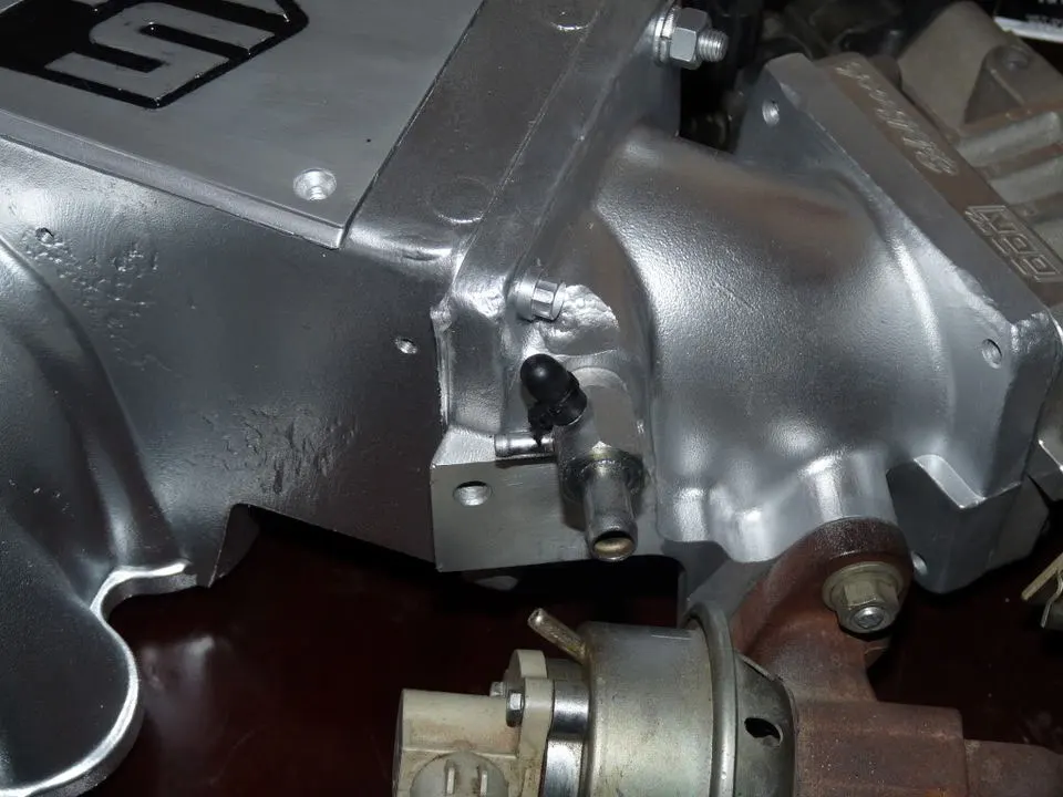

and the second picture is where i have the thing you have on your tb adapter
The place you put the t in the second pic is the place where the ait sensor goes on a fox body. I beleive it needs to be plugged on yours. I imagine it would get vacuum there though. Where is the other end of that hose going?
The first pic, im not sure about. If I had to guess I would say its a vacuum solenoid for the egr or smog. Thats just a guess though.
The solenoid is the EVAP purge solenoid. The solenoid just dangles there. The line going towards the passenger side goes to the charcoal cannister. The line going to the driver's side goes to the intake.
where does it go on my intake. since i changed intakes i don't know where i could go now. Do i really need it, can i plug it.
