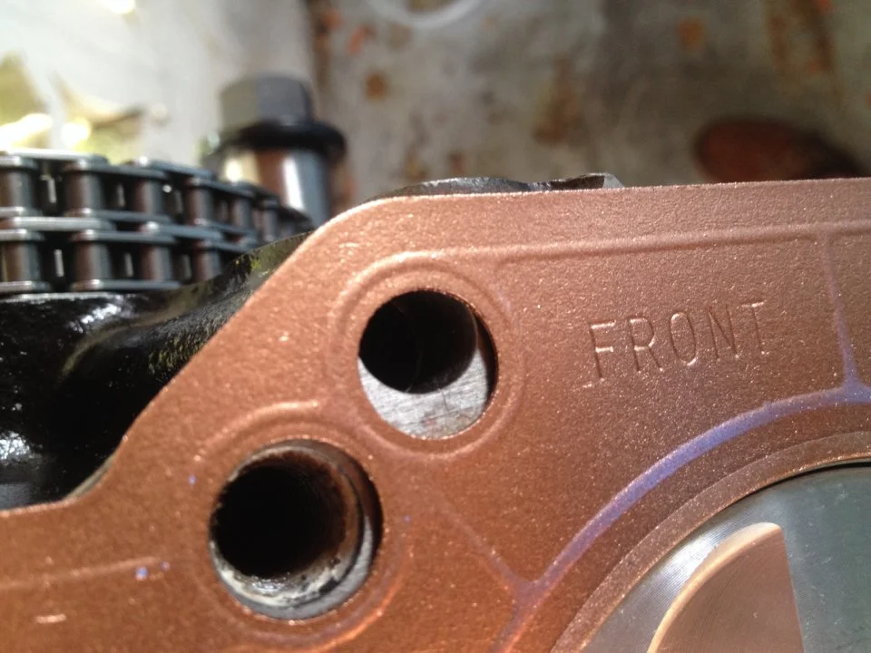

As a novice when you come across a problem you ask the pros for advice . I'm recently putting together a 347 block . Last night when I place the gasket (felpro1011 -2) on the block I notice that the oil return hole was a bit covers by the gasket . I place the gasket on the aluminum heads and they fit perfect . Is this normal on this blocks ? Thanks for the input !

like this?
Yea I'm leaning as I go two lol it just like this pictures you send me . Is this normal ?
looks to be....i "think" they do that for a reason,prob to balance the pressure....but im a back yard mechanic so dont take my word for it....lol.....my oil pressure is great though and i have no issues anyway
Me neither, I just slapped em on and torqued the head down.... I have 55# of oil pressure hot idle.

Thanks guys I was worried I had the wrong ones .
