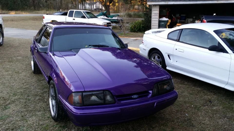

I have a 93 mustang with following mods 331 w/t5 tranny still fuel injected. E303 cam edelbrock performer heads 1.6 roller rockers msd 6al, gt40 upper and lower intake, 24lb injectors, bbk cold air with calibrated maf, car has chip tuned by Tony gonyun but been awhile. my problem is a few months ago was making a pass at the track and had a back fire. Since then car has run very poorly have done a compression test and leak down and everything seemed fine. So I turned to timing and found that it was very low at almost 5* initial timing. After adjusting up to 16* my total timing will advance up to 35* at Rev to 3000 rpm but immediately drops back to around 28* and stays. car still feels really sluggish could my problem be a bad distributor or possibly a bad tune? Tired of throwing money at parts trying to fix the problem. With the spout connector in when holding the gas at 3000 rpm the total timing should peak around 35 to 38 and not fall back correct?
Replaced tps since problem started. A friend suggested that it could be the gear in the distributor badly worn. But on an efi car the computer controls total timing so I am thinking it's got to be in the tune. Just wandering if anyone else has ever seen this problem
