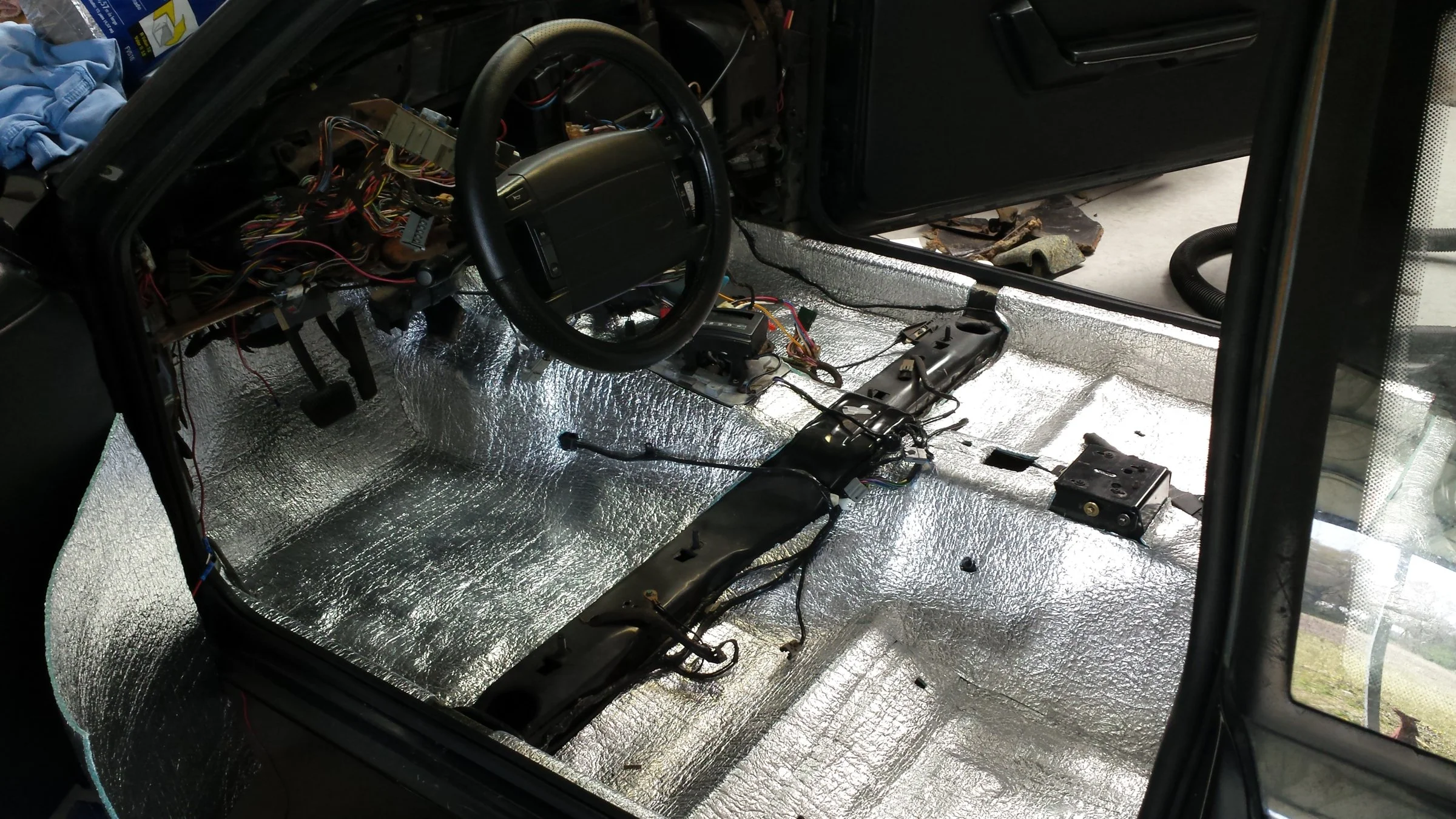

Our 92 SSP coupe was a noisy mess when I bought it. I installed Fatmat and Insulation from Carinsulation.com, to the roof, doors, floor, and trunk. The improvement was totally worth it.

This is my next project when I run out of projects
doing alot of research on sound deading and they recomend a cdl tile over 25% of material (adds weight and reduces vibrations) followed by ccf (closed cell foam) over the tile to act as a buffer or gasket followed by mlv high density foam which is the true sound deadener
