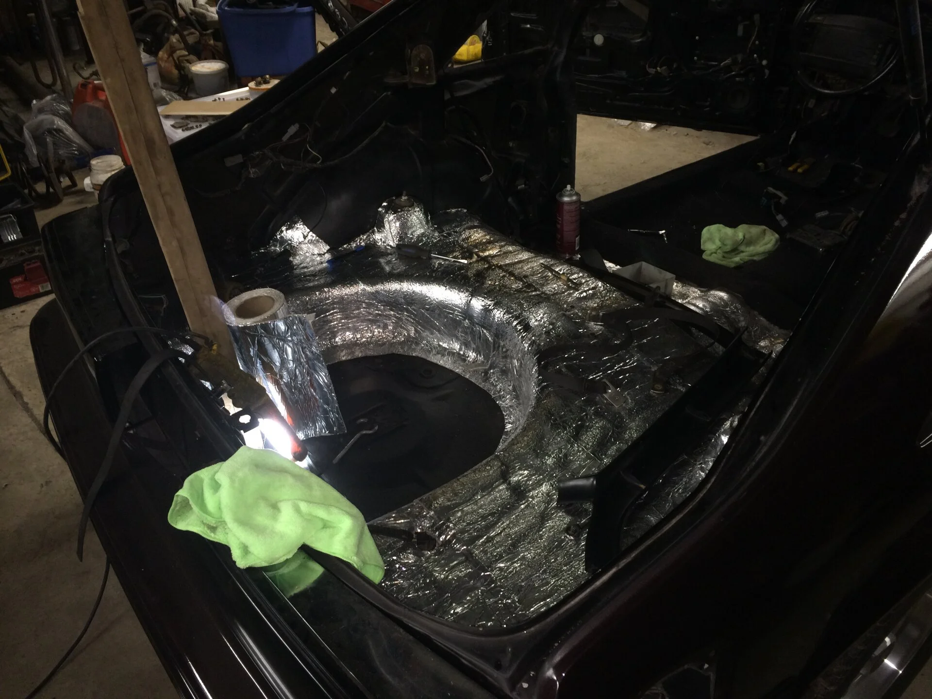

Bossed said:
Fatmat and Insulation from Carinsulation.com,
Hi, how much of the fatmat was needed? Looking to buy some. And is it just the fatmat product?
KRUISR
Apr 16, 2015
1,863
999
143
Feb 9, 2021
#26
  • Feb 9, 2021
  • #26

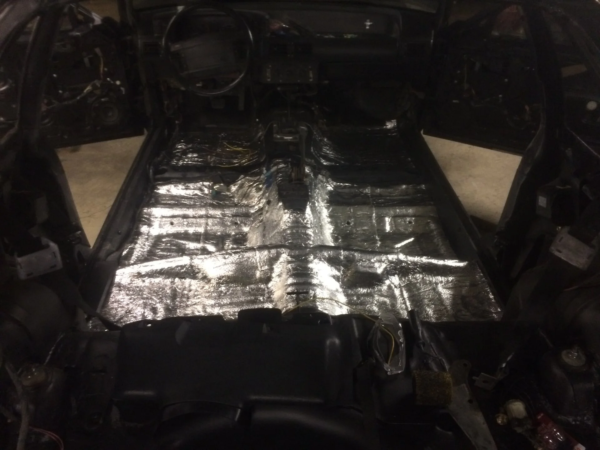

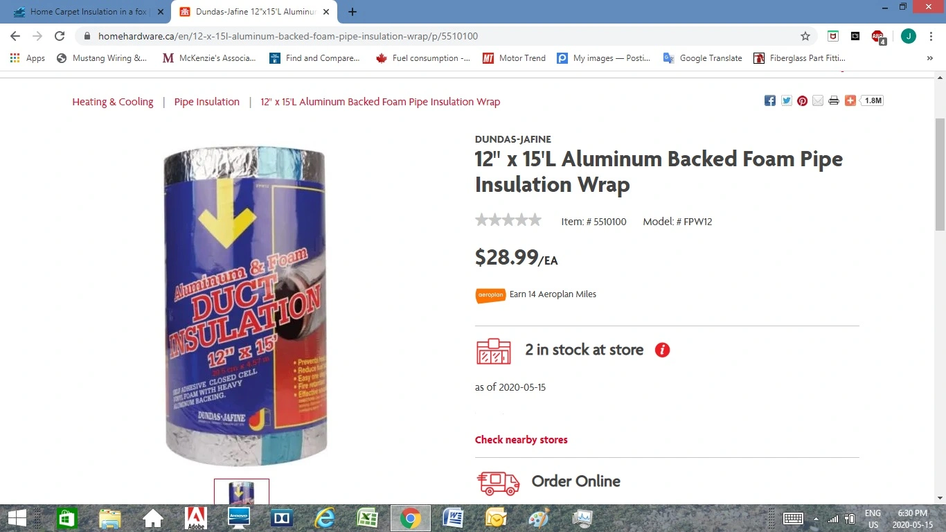

I used something I picked up at local hardware store...
I think I used 2 - 2.5 rolls. I covered entire floor, roof behind the sunroof.
Just an alternative to specialty "sound mats" out there.
I did the exact same. I did 2 layers; way cheaper than dynamat and it made a night and day difference.
