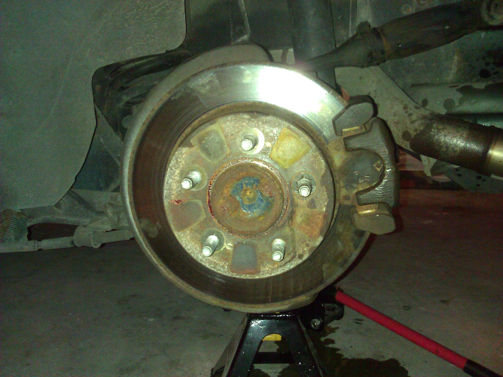

I am attempting to put new rear pads and rotors on my 94 GT. I removed the 2 pins on the calipers, but the caliper will not come off the rotor. ( Parking brake is off ) In every video and tutorial I see online, the calipers should come right off. What gives ? All I knew I had to get was the caliper tool for compressing the caliper after I remove it to put in the new pads......I cant find anything to tell me how to unstick this crap. I don't want start banging things around.....but this crap is stuck on good.

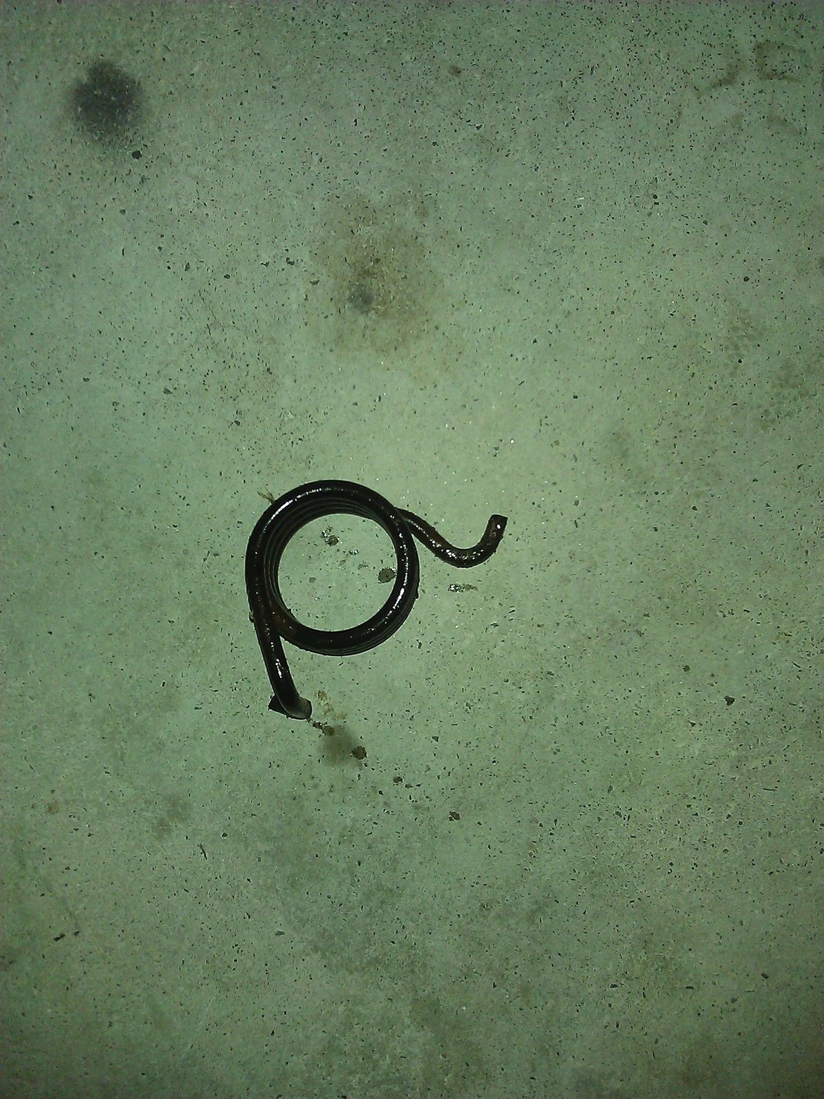

I also had a DERP moment and accidently popped off the following spring. I almost killed myself trying to get THAT back on.

You'll need two vise grips and brute force to get that e brake spring back on.
As for the caliper, try a pry bar or flat head screwdriver between the caliper and bracket.

Well, since you're replacing the rotors too,you can remove the two 15mm caliper bracket bolts and remove the caliper and bracket together.
A little prying will not hurt anything.
When you go to remove the rotors, don't forget those lock washers on the lug studs.
If the rotor is stuck to the axle shaft, a few whacks to the back side of the rotor will free them up.

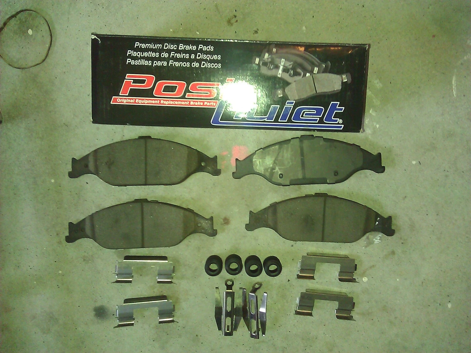

LOL everything went great one I took off the brake Mst. Cyl. cover. I got the replacement pads for 94-04 GT/V6 from latemodelrestoration.com I was going to sell them for half. $20 plus what shipping would be. Heres a pic.

I still have not gotten that spring back on. I tried hard last night and could not get it. Hoping someone has a secret here......

Two needle nose vice grips, one on each end and brute force.
94-98 front gt/v6 pads are different then the 99-04 gt/v6 pads.

That's what the item description says on their website. didn't fit the calipers, that's why I'm not keeping them. I thought it was for stock calipers....... guess I wasn't paint attention. A could look at the website to see the pads there....idk if anyone here might need them
I've seen a suggestion that zip ties may help. Have a friend help you; one of you compresses the spring as much as you can, and the other tightens the zip tie. Repeat this process several times until the spring is compressed enough to install.
