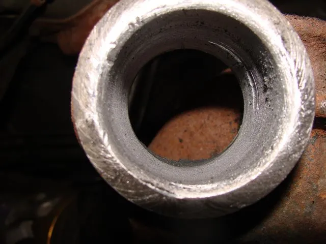

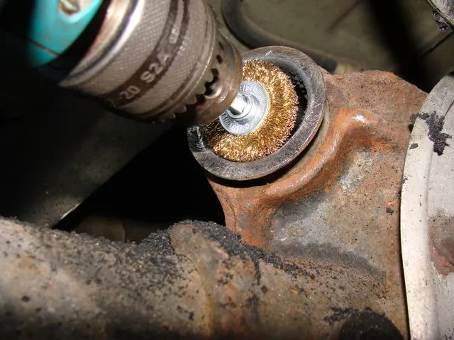

Yea, without using torches.
I simply knocked out the pin, then used a wood hole saw to get most of it out then used a brush drill bit that was the same size. Cleaned it up in a jiffy.
I believe I posted a thread about it.
Or pm me and I can email you some pics of what I used, I document everything I do.

After the hole saw
Using this bit really cleaned it up quick

Don't be shy with the grease, the more you put the better...it's sticky, but works well

I'll definitely give that a try for the other side. That looks like it'd b much easier than what I just went through on the other side.
I'm going to have to buy a hole saw. Any idea what size that is that you used?
