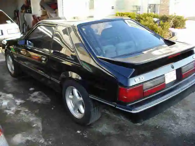

not 100% but the ponys are a 7" wide wheel? also the fact you have a SVO. but my 93 coupe i have 17x9 wheels all the way around and lowered. i just put 285/40/17's on the rear i have no quads and i get no rubbing at all. i have 3/8" spacers on the front with 245's only because the tires rub my coil overs. so unless the fender wells are diffrent on your SVO and my coupe you should be able to run a 9" wide wheel.my drag wheels are 26/10/15 slicks and they dont rub at all on the rear either,even with it squatted off the line. peace

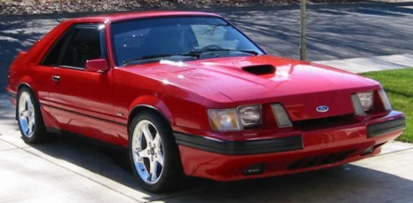

I'm not sure how low your car is, but I fit 18x10 and 285s in the back of mine, and it is lowered (see my sig). I might even have a little more room for more tire? The only time I ever heard a tiny bit of rub, was on a really tight angle on a hill where it stuffed the wheel into the wheel well, and one other time when taking a very hard, sharp turn too fast!
The '99 - '01 Cobra wheels look and work good on an SVO. They're 8" wide.
Buy Ford Racing Parts!
Not my car btw
