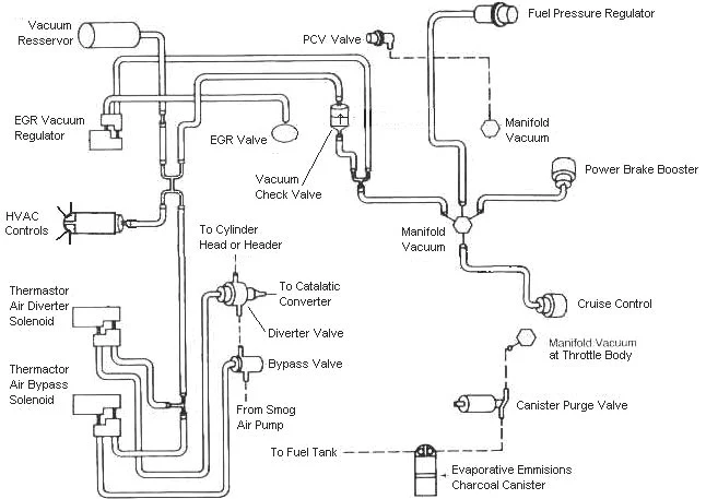

ive pin pointed the sound to the side cover of the upper intake manifold but i have taken it off and put new gasket and rtv the **** outa it to no avail... i can almost swear it is comming outa the side cover but i have sprayed it with every fluid and doesnt change the idle. how many vac lines come off the intake and where do they go to? I have one to the FPR one to the VAC tree and one to the PCV and then one is just blocked off.. is there anyone im missing?
See the following website for some help from Tmoss (diagram designer) & Stang&2Birds (website host) for help on 88-95 wiring and lots more…
http://www.veryuseful.com/mustang/tech/engine/
Diagram courtesy of Tmoss and Stang&2birds.
