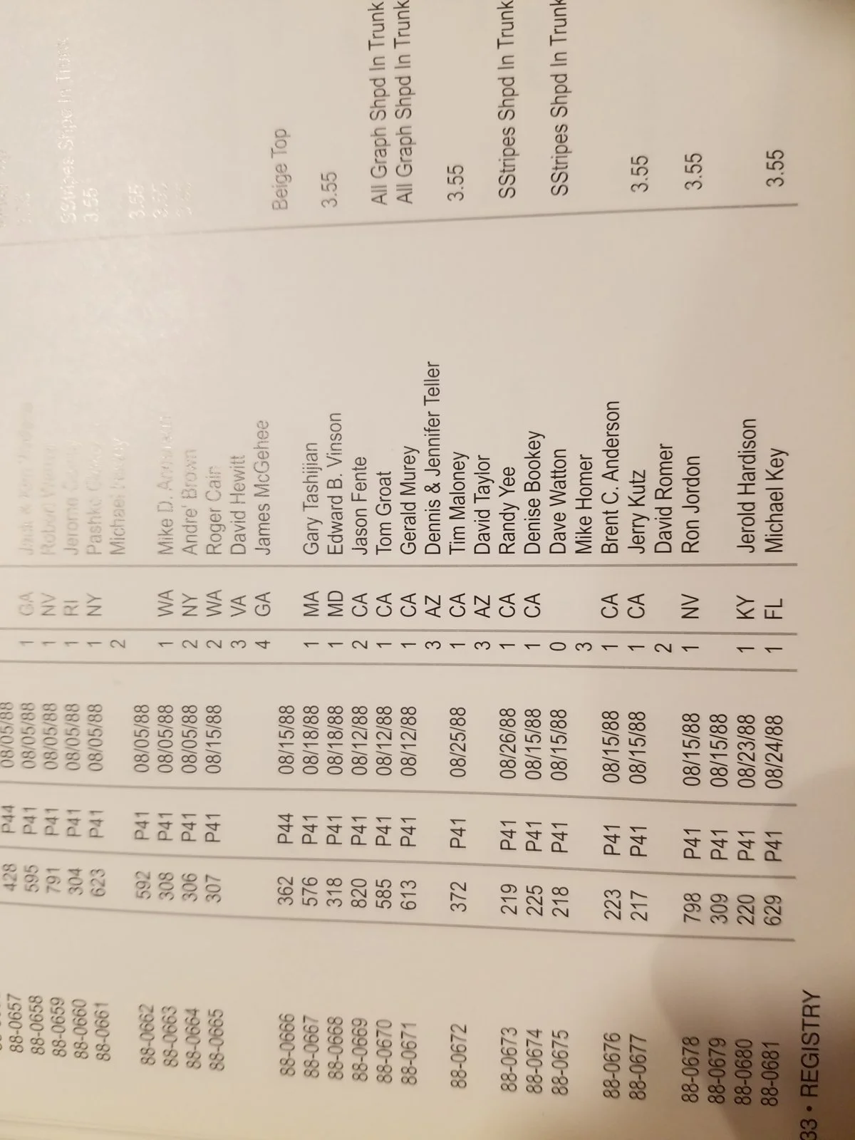

I looked this car up in the saleen book.
vin looks right
Appears to be originally a California car which would explain the mass air
Doesn't say stripes shipped in trunk, most that had it that way do have that listed.
You will likely need someone that knows how to read the info better to know if it was originally an auto.
I rotated the pic and saved it, i'm better with a wrench, so someone fix it for me.

BTW, code 41 just means it's a hatch.
If it's an original auto car the gear would say as option 3.27 or if it says nothing they would be 2.73's.
The stereo should be a pioneer.
The speedo should be a 170mph (made of unobtanium if it's missing).
