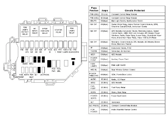

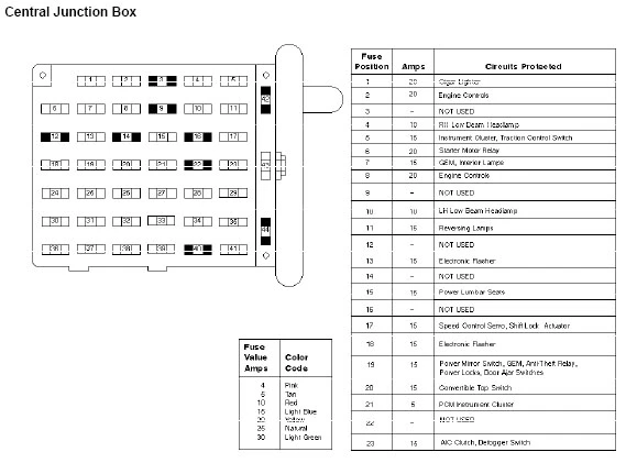

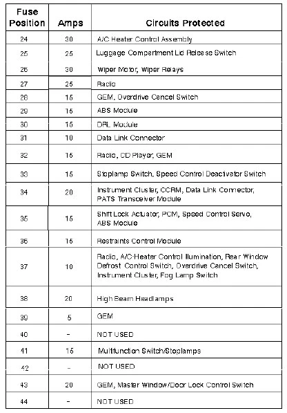

I have a draw on my battery and the previous owner of my car lost the fuse box cover so I can't tell what fuse is what. Can someone please take a digi pic of their 01 cobra fuse box cover and email it to me? :bang:
I just checked and there's nothing on the cover that tells you what fuse does what. It's just a plastic cover with no markings. If you have an owners manual for an '01 Mustang look at pages 131-134 for info on the fuses. I tried taking pictures of the manual but they aren't readable, the print is too light.
Hopefully these will help. They are from the 99 service manual, but I'll bet it is identical.
