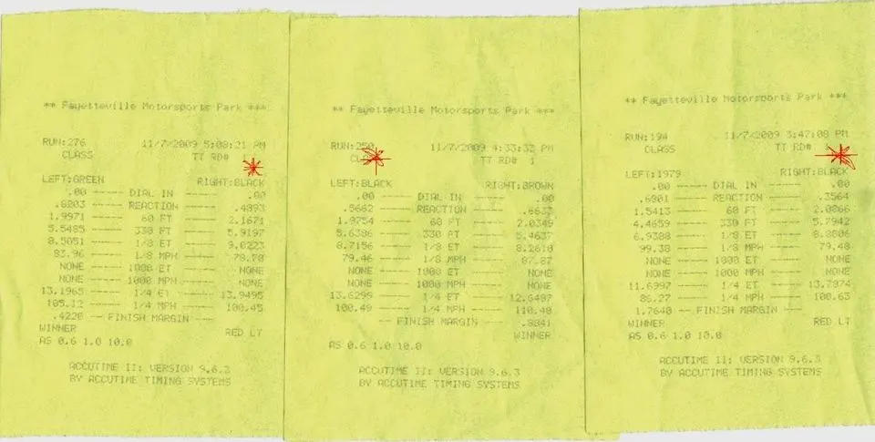

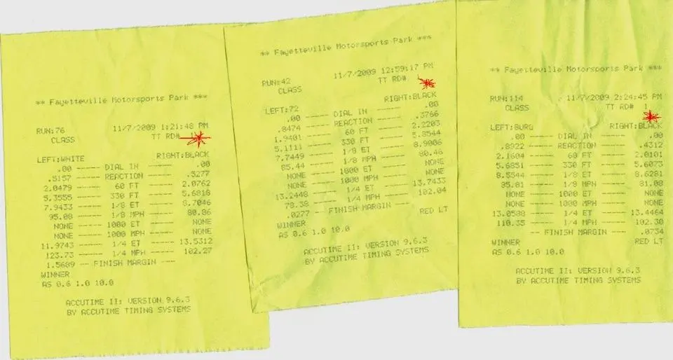

And here it is!!! So I took the ride down to the track, ran three times with my bbk plenum/ 75mm tb, Got my best run ever today, 13.4@102 w/ 2.0 60ft. and then ran the the stock plenum t/b setup and the best run I could pull had an even better 60ft, 13.6@100 w/ 1.9 60ft. So i ran 102mph with the bbk plenum and only 100 with the stock, so i guess the plenum does something on a N/A car, 2mph is a lot at the track we all know that. Also have video of all runs, will post soon. Tomorrow doing the dyno tests.
Runs with bbk plenum
Runs with the stock setup

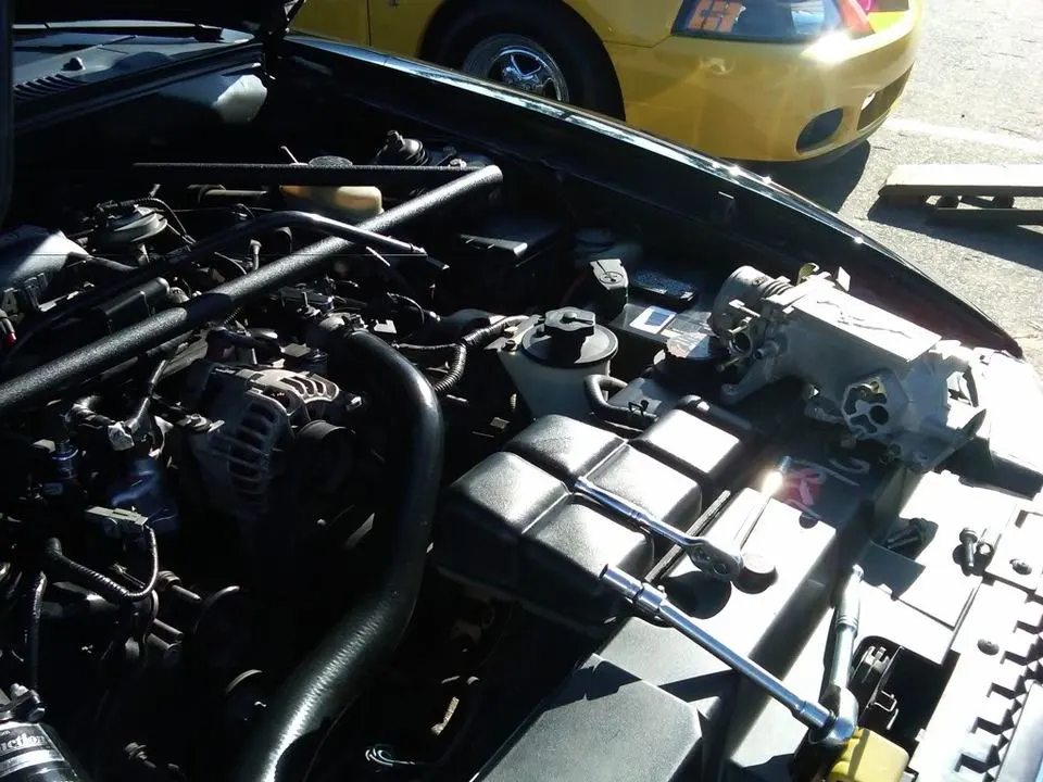

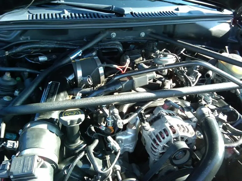

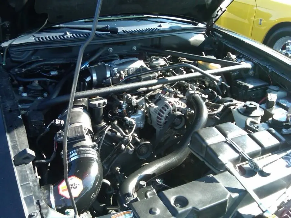

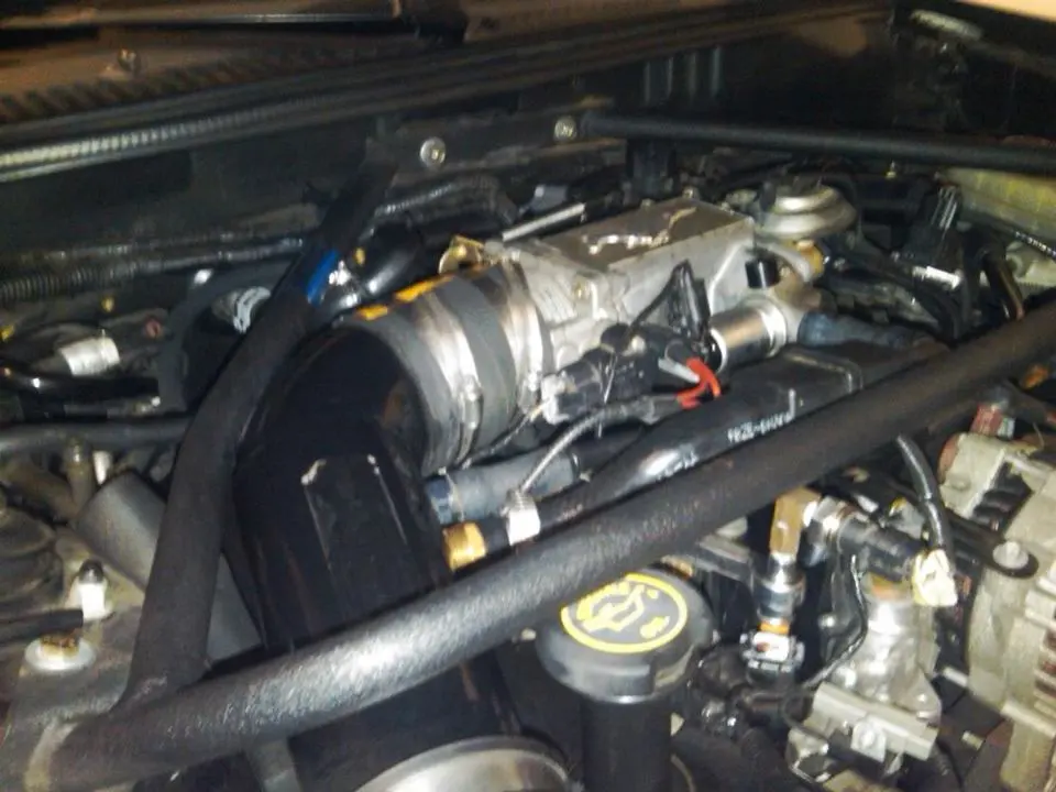

Pics of the install @ the track
