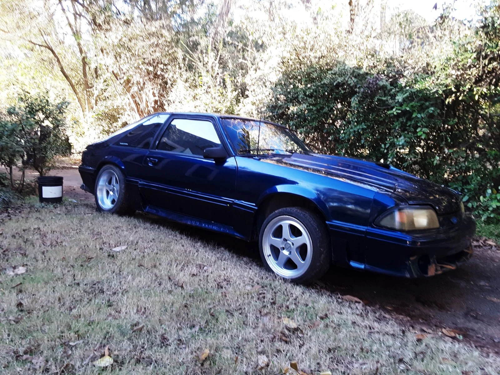

Engine Plz help ready to set car ablaze
I literally don't know what else to do the cars been in the shop still not fix replace the starter and flywheel 3 times in six months... works the first day then bam it starts all over again starter bolt backing out starter flywheel grinding... I have adjusted it taken off put it back on tightened bolts down before trying to start it only to get grinding plz help idk what to do and I'm ready to set car on fire and watch it roll on down the drive way
