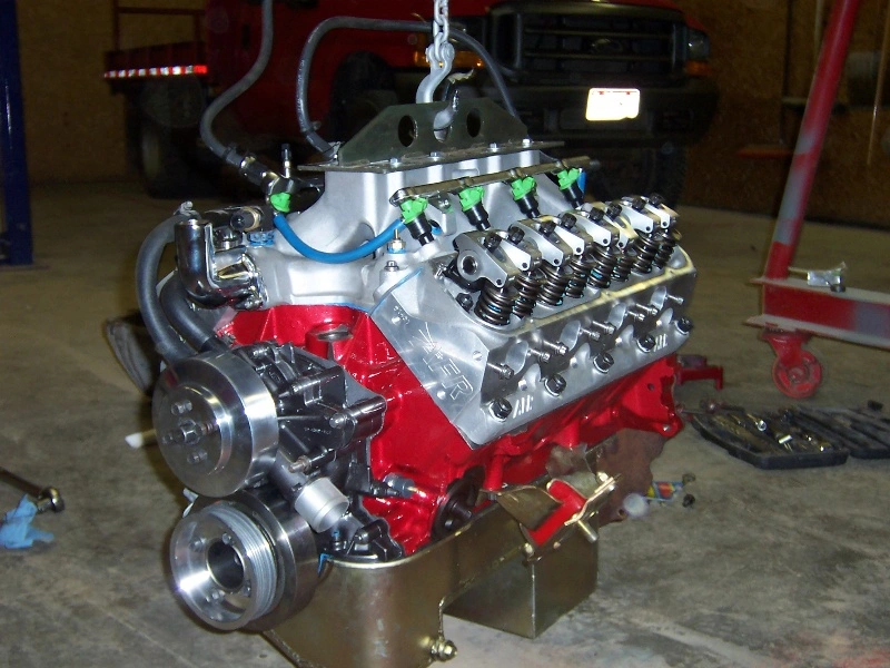

I had some problems with my Mallory fuel rails leaking originally
I just used a crap-load of teflon tape on the threads (being careful not to get excess inside) and I got it to seal. So far, so good.

Stock fuel rails? Check. :)
I also had a ground problem with mine since my battery is in the trunk. I ended up running a ground straight from the battery to the starter.

Low 5.0 thanks for the pic, lol. I feel better now!!! :) BTW, I had to turn the one "nipplet" on the stock rail, passenger side so it would not hit my intake but I guess that is ok...and where did you get yer hose? Was it hard to put on?
NEXT PROBLEM: The Crank pulley sticks out about 1/4" too far...do I have it reversed? andy ideas..:shrug:
The hose came with my intake. It wasn't hard to put on, but it does require a good bit of elbow grease. I think I stuck the rails in a vice to hold them steady, then the hose just slides on.
