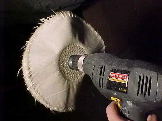

what kind of wheel did you use to buff? I have a proffessional buffer and a dremel

Brian, I took a plastic cup filled with tap water and cut the sandpaper into little 3"X3" squares. I dipped the paper into the water and then started sanding in one direction as to not create swirls. I'd sand it a while, then wipe it clean with a paper towel. Once I was done wet sanding, I dropped some of the plastic polish on the lens and smeared it around with my finger, then I took a ~8-10" SOFT buffer wheel attached to a multispeed electric drill and started going back and forth on the lens with fairly light pressure. I then used a polsihing cloth to wipe it clean. Lastly I put a coat of wax on them. That's it. I too thought sure it would make it worse, but to my surprise it made it look brand new. Like I said I used 2000grit, and I continually dipped the paper into the water to keep it wet. After wet sanding the plastic is definitely scratched and hazed over, but as soon as you hit it with the plastic polish it comes right back to being completely clear. The plastic polish has a Stock # of 750 on the bottle on the back to the right of the bar code.

Here's the drill/buff wheel I used. Its really soft...

Ohhh, it's one of those polishig wheels. . .Last time I tried using one of those, I went to press the wheel into the compound and more compound eneded up on my face, the garage walls and the ceiling than on the wheel itself.

Zero- yeh, I had the same experience with them as you did. I never used them either until recently when I went on a polishing spree and did my front calipers, alternator, and inlet elbow. My basement is a MESS. But in using this wheel on my headlights it didn't make a mess at all, but I applied the product directly to the plastic then hit it with the wheel. It splattered somewhat, but nothing too bad.
