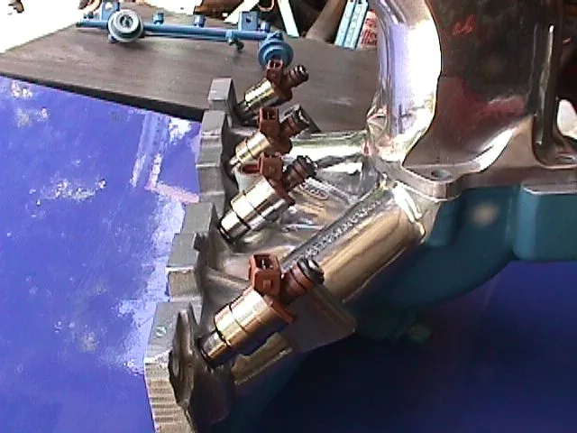

I used a little sandblaster like you can get from sears and northern tool, then my diegrinder w/ wire brush, looks good and it was fast - might be worthy tools for you guys to consider.

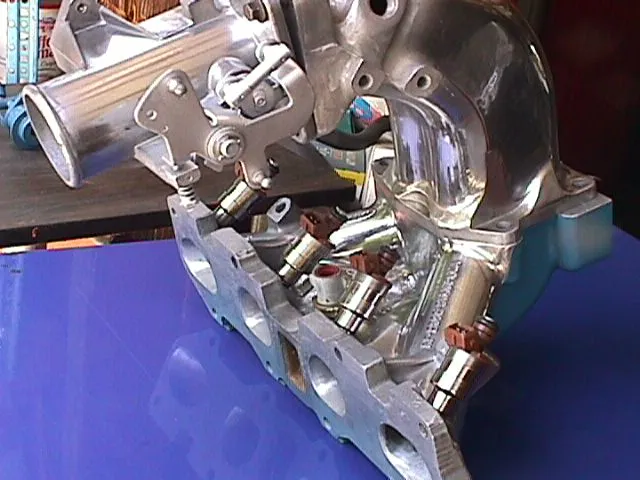

I don't know how bad those cover are to beging with but I used everything I could get my hands on to help. I used a Diegrinder, Dremmel, and hand sanding on my upper intake. It still took a crap load of time but those intakes has some really deep pits in them. When came time to do the lower I sprang for a powder coat :nice: I got some before and after pics on my web link in sig.
The valve cover I got was a pretty bad casting. I don't know if they are all like that or what, but maybe that explains why they are powdercoated from the factory.
I initially used a wire brush to attack the powder coat, it just laughed at the brush and started to melt and push around. So I used some Citrisrtrip form Home Depot, letting it sit overnight. That cut it GOOD.
I used some 60, 100, and 150 Norton foam sanding blocks, then used a 120 and 160 sanding wheels made by Columbian. I am going to use the 160 wheel one more time then wet sand some more with some fine grit.

I now sand w/ 100, 120, 180, 220,320 and then use a nylon wheel on a electric drill which seems to do the final sanding 600-800.
I then buff with Tripoli and do the final polishing with White Rouge.

When I did my aluminum drive shaft I went strictly with Tripoli to buff with, and then White Rouge to polish the drive shaft all with a buffing pad on a electric drill and absouletely NO sand paper or ALUMINUM POLISH ... Ever piece is different and every casting is different so what's your point!

I am getting a die grinder for my A/C soon and I have another VC that I can polish. I was thinking of doing this is there more to what you did or all that you already said is all that you did?
