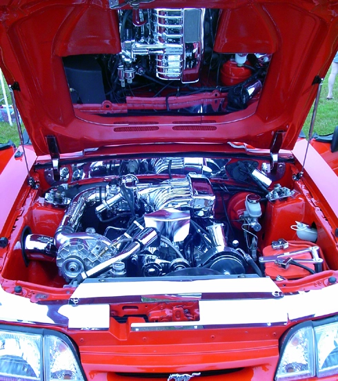

Been through it as well. The more you do, the more you have to do. It's like everything else in the engine looks like crap next to the nice peice. Before you know it you do the whole engine. I went with painting a few things to set it off a little. Like I just polished the tops of the valve covers. Here is a picture of my old motor back in 1998.

And just because I'm a picture whore :shrug:
