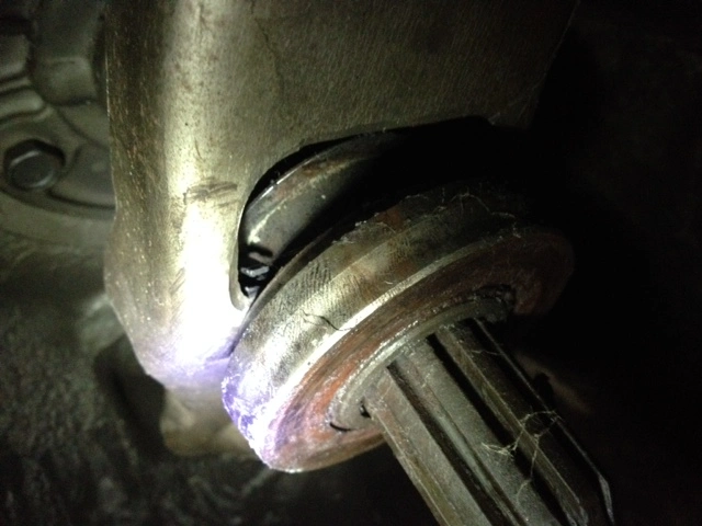

clips that's what I meant. I pulled out my spare and took a pic. behind the fork there is 2 clips
