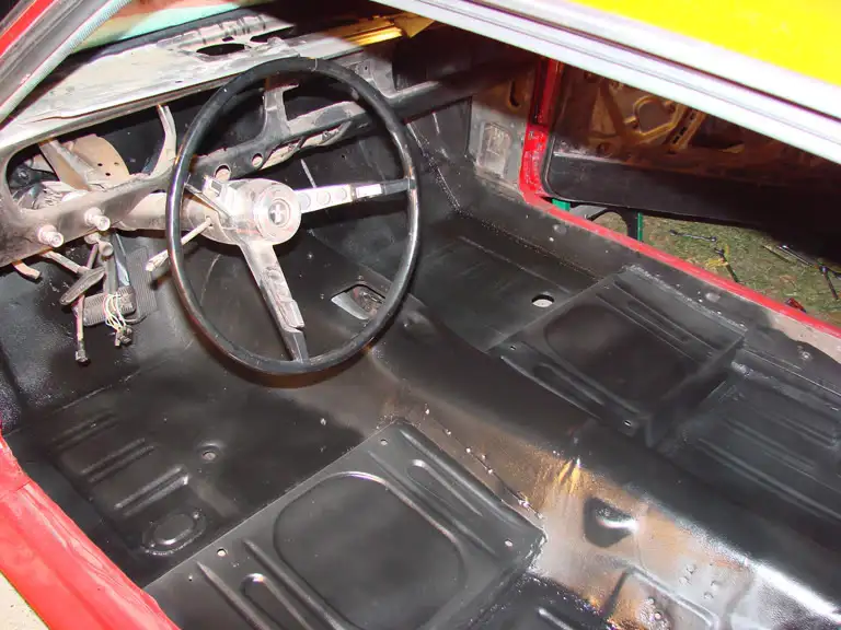

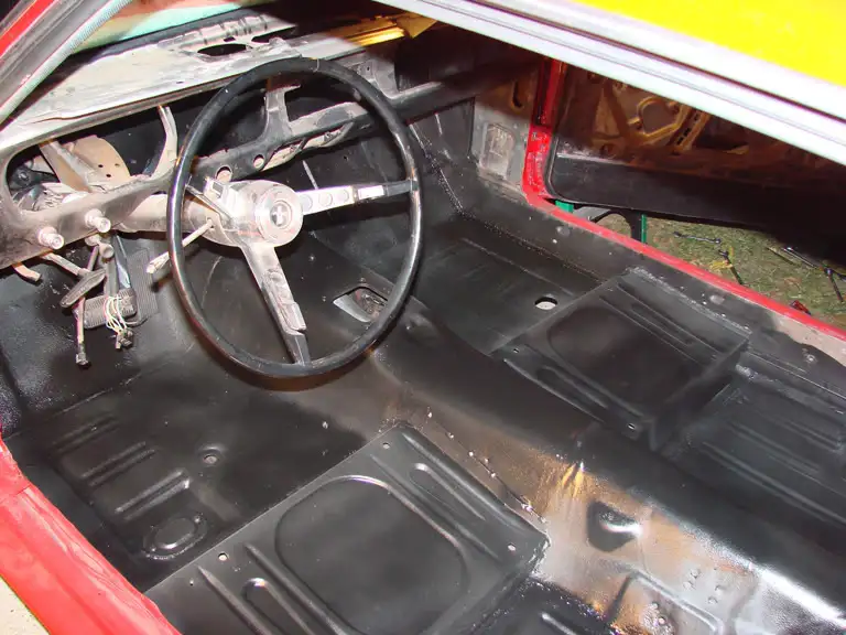

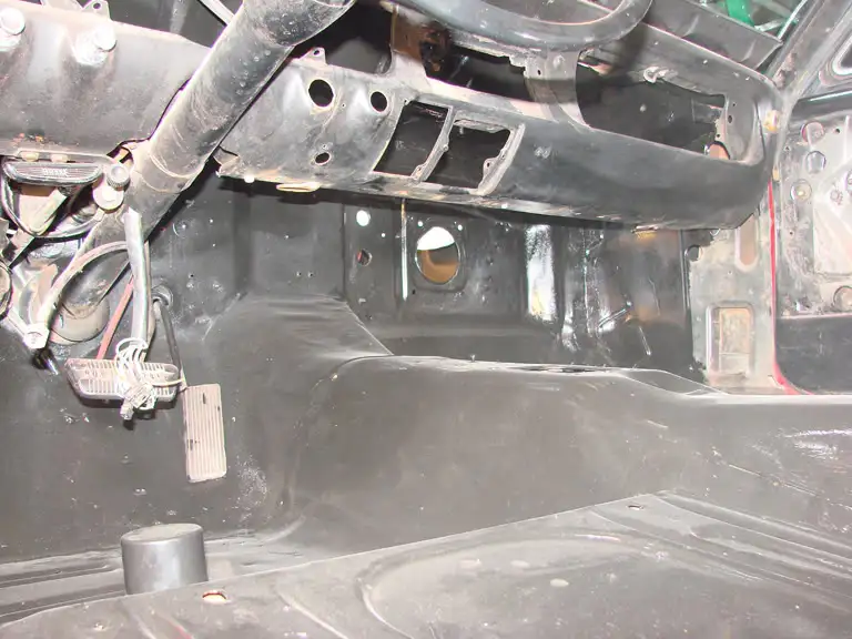

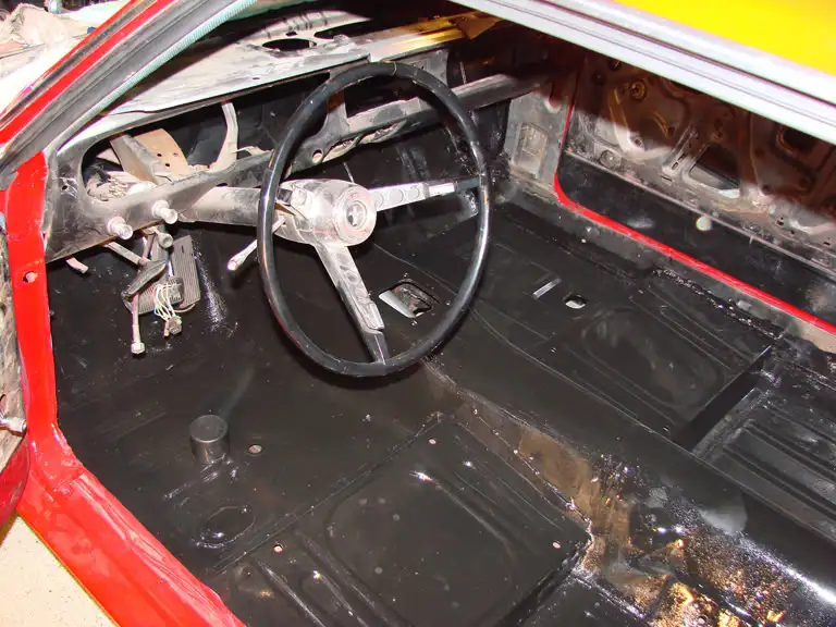

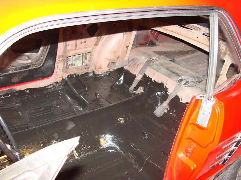

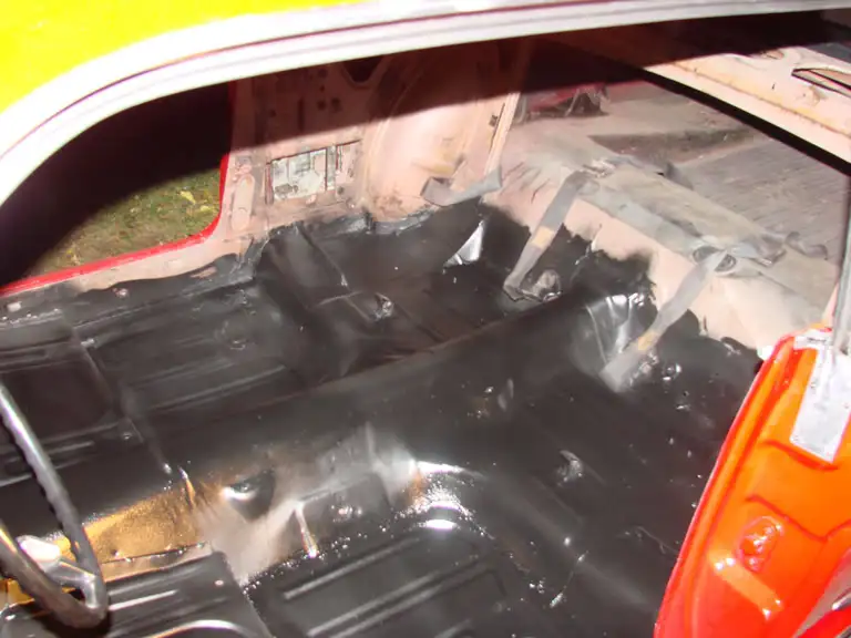

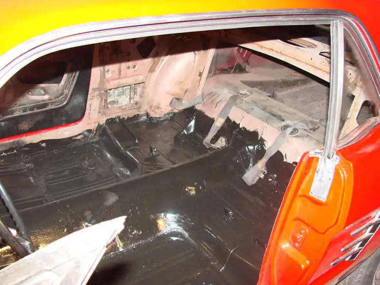

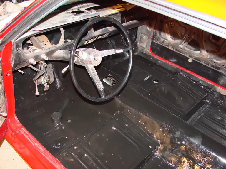

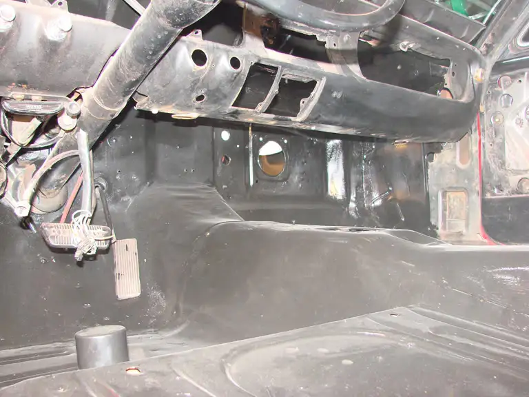

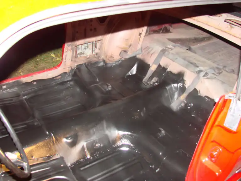

i swear by it.it's tough as nails and lasts forever.
what i do is coat my floors with por 15, then spray undercoating (rubberized sray that is a sound deadner) which helps seal in the por 15 even better.
i have pics if you would like
POR15
with undercoat

I've used POR 15, I'm quite a novice at any sort of repair and I was able to do it successfully, its is an easy to use project and it does produce results. Unfortunately I didn't have a compressor so i used a brush to put it down, it made it a little harder and it didn't come out as smooth as the ones above, but I used Second Skin's products (sound dampening) on top of it and it makes such a difference.
