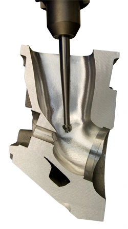

The AFR heads are CNC ported as shipped. It is very doubtful that you would be able to make a consistent improvement to them. CNC machining uses a multi axis computer numerically controlled machine to port each port to maximum flow and every port flows the same amount of air and has the same port volume.
See 5 axis CNC Cylinder Head Porting Machine. Digitize and CNC port Intake, Exhaust ports, and Combustion chambers. to learn more about CNC cylinder head porting. It is truly amazing what this process can do.
If the still picture isn't visable on your PC, see the movie version - CENTROID CNC Video CNC Cylinder Head porting video with 5 axis CNC milliing machine. All I can say is WOW!!!
If you want to play around and port some iron heads yourself, see diyPorting.com for lots of good information
