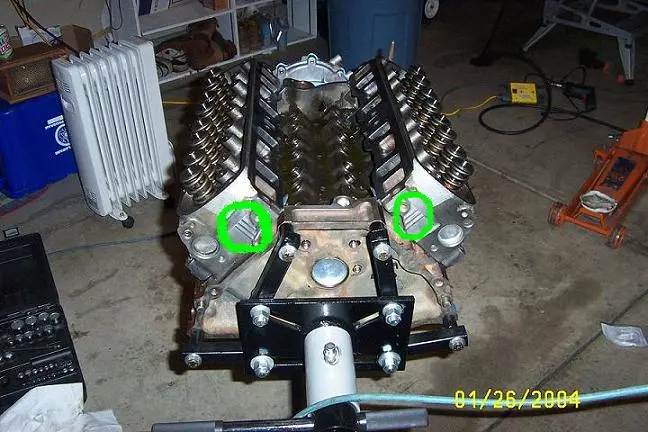

GT-40 heads have 3 bars on the front/back of the head, GT-40Ps have 4 bars. GT-40Ps flow better but have a weird spark plug angle, which vastly limits the header choices.

Here are the 3 bars you are looking for.
The "P" heads also have a "P" cast in the lower front corner of the passenger side head (if they happen to be bolted on a motor when you check) next to the valve cover rail. The spark plugs stick out nearly at a 90 degree angle to the head.
