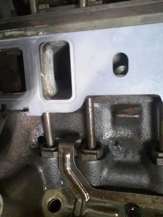

ok, not new here to this stuff but new on here. i did a headgasket on my 86 gt and while i was at it i hogged out the exaust and intake ports on the crappy E6 heads heres a pic to give an idea, the intake side is almost as big as the gasket hole...wondering if ill gain any extra ponies here?

leave the port entrance alone - looks like you worked on the pushrod pinch area which is where the flow is in this section of the port. Do a good job on the Short Side Radius (SSR) and the bowl blending and you've got a nice home ported head. You can get more flow from widening the bowl in the right areas, but you'd better know where the water is.........
