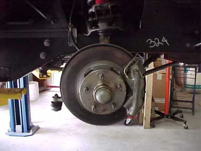

It would help if we knew what year your car is. This is the 65-66 brake, the 67 was almost the same, the hoses were slightly different, as were the pad springs. The Fairlane also used these brakes. It's a fixed-caliper, four piston brake.
The 68-73 used a floating caliper, single-piston brake.
