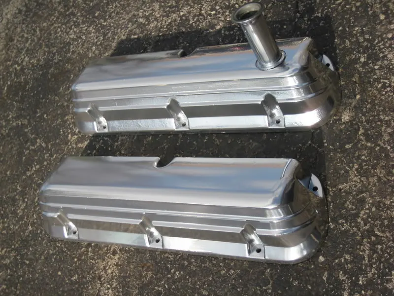

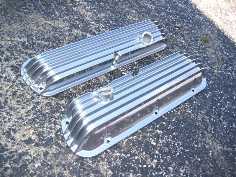

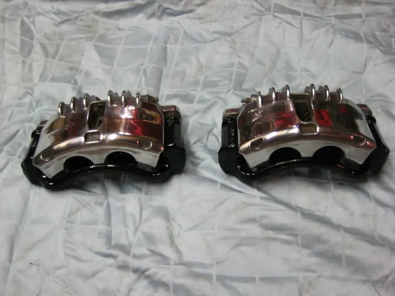

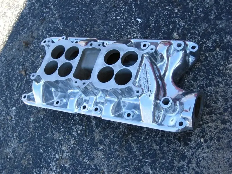

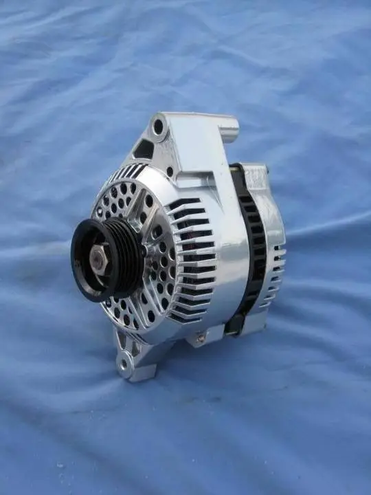

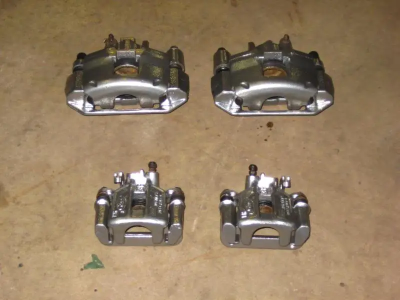

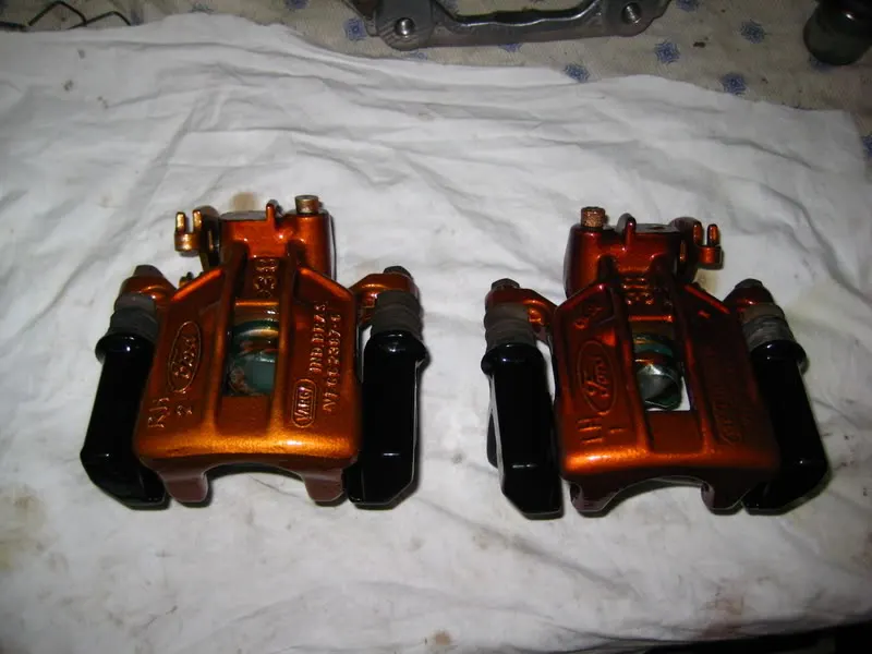

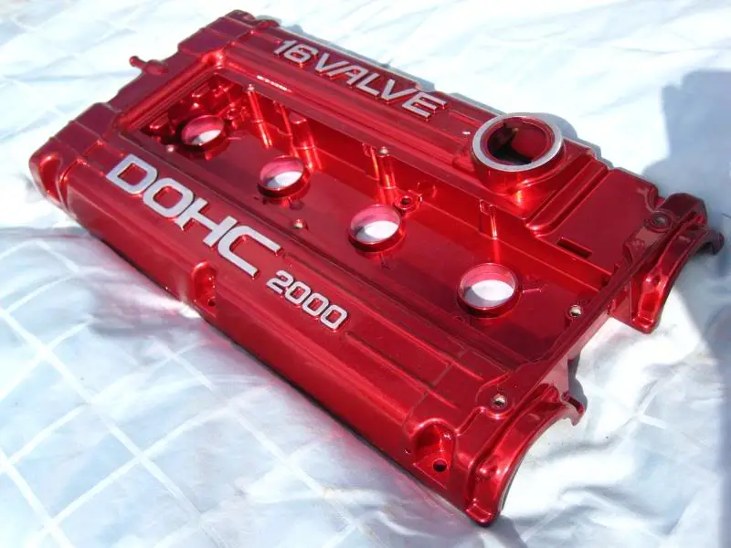

I powder coat for a living and started out with the EW hobby gun, and it's not as easy as one would think. It is 95% prep though - media blasting, degreasing, pre-heating, etc. Get on the following forums and read, read, read!
http://forum.eastwoodco.com/forumdisplay.php?f=9
http://www.powderbuythepound.com/forum/index.php
A few pics of my work:
Hey you asked for pics, so I pic whored!

caseywan said:
That's exactly what i wanna do with my stock valve covers! I'll probably be stuck with rattle can though as i'm too cheap to pay for powder coating. I've had good luck with Rustoleum rattle can stuff though.
C
caseywan
Apr 7, 2006
157
17
Chicago, IL
Apr 14, 2008
  • Apr 14, 2008
Yeah, I had a good 5 hour of labor into those, would probably charge $125 to do another like that.

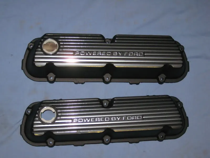

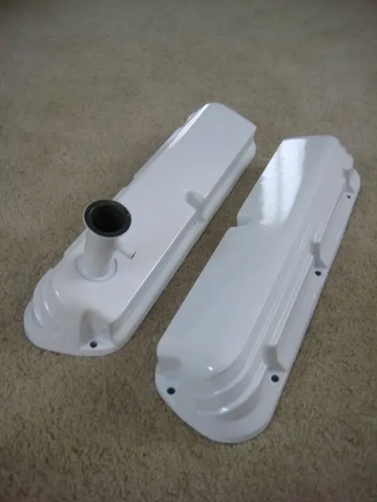

man, can you give me a few tips on how you did those valve covers. I got the same set and i was wanting them to look like that. Or i was going to silver vein them.
C
caseywan
Apr 7, 2006
157
17
Chicago, IL
May 17, 2008
  • May 17, 2008
Well, I sandblast nearly everything I do, so that was first. Then I coated them with a "chrome" powder and cured. Then I laid them flat shot them with a fine textured black and painstakingly wiped the powder off the fins with a small foam paint brush that I dampened with water - yeah, it took a looooong time. Then cure it.
