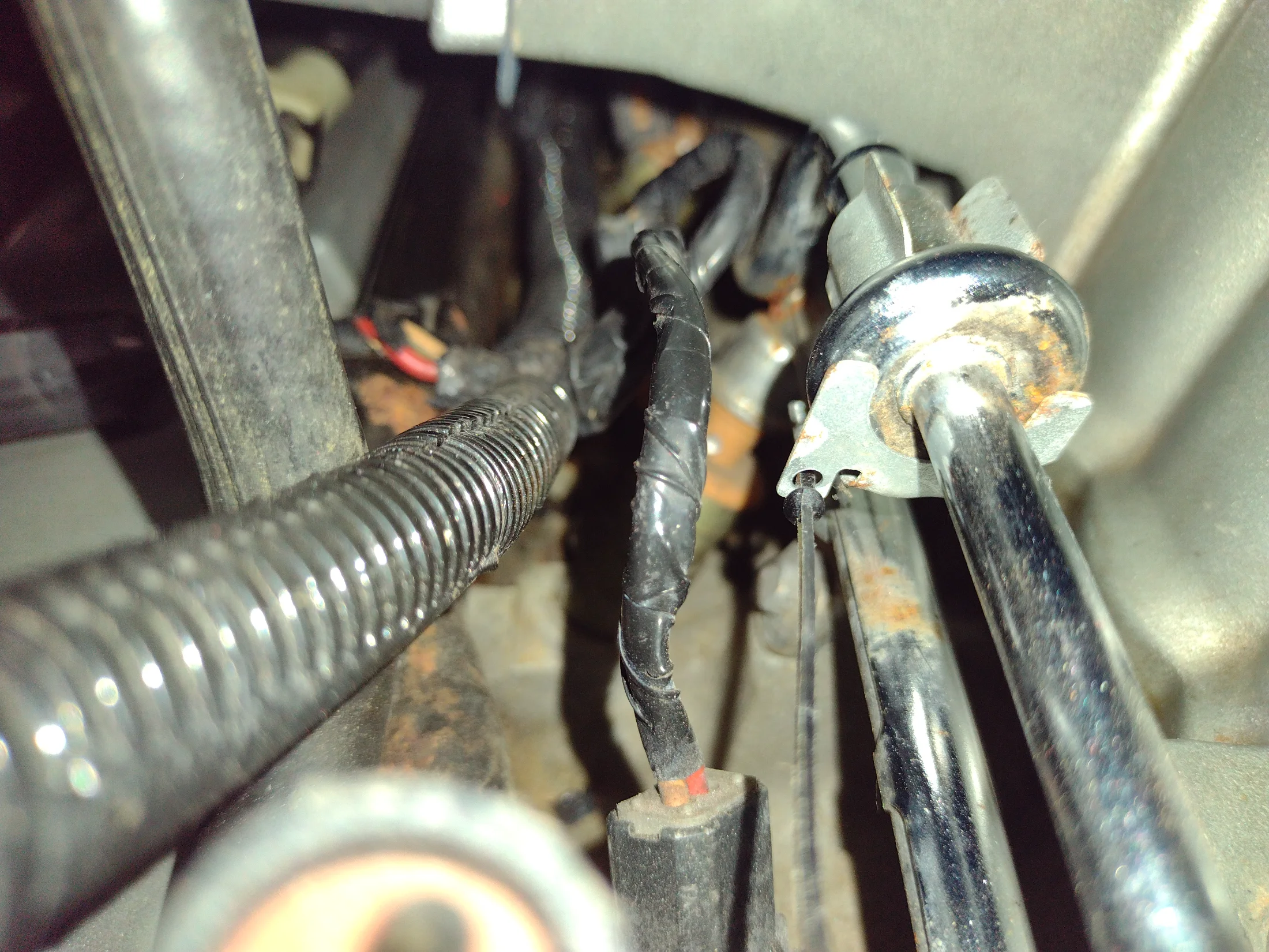

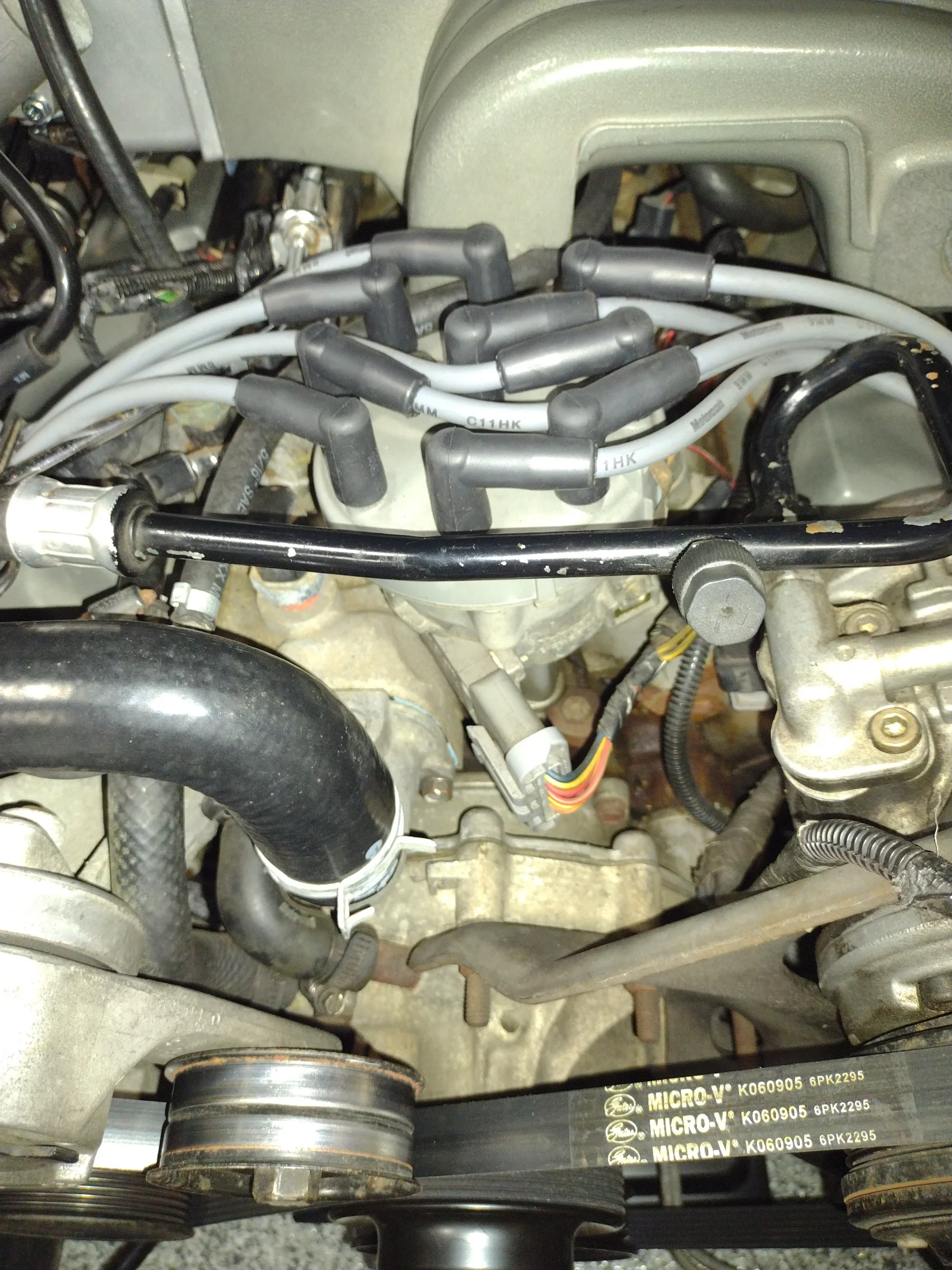

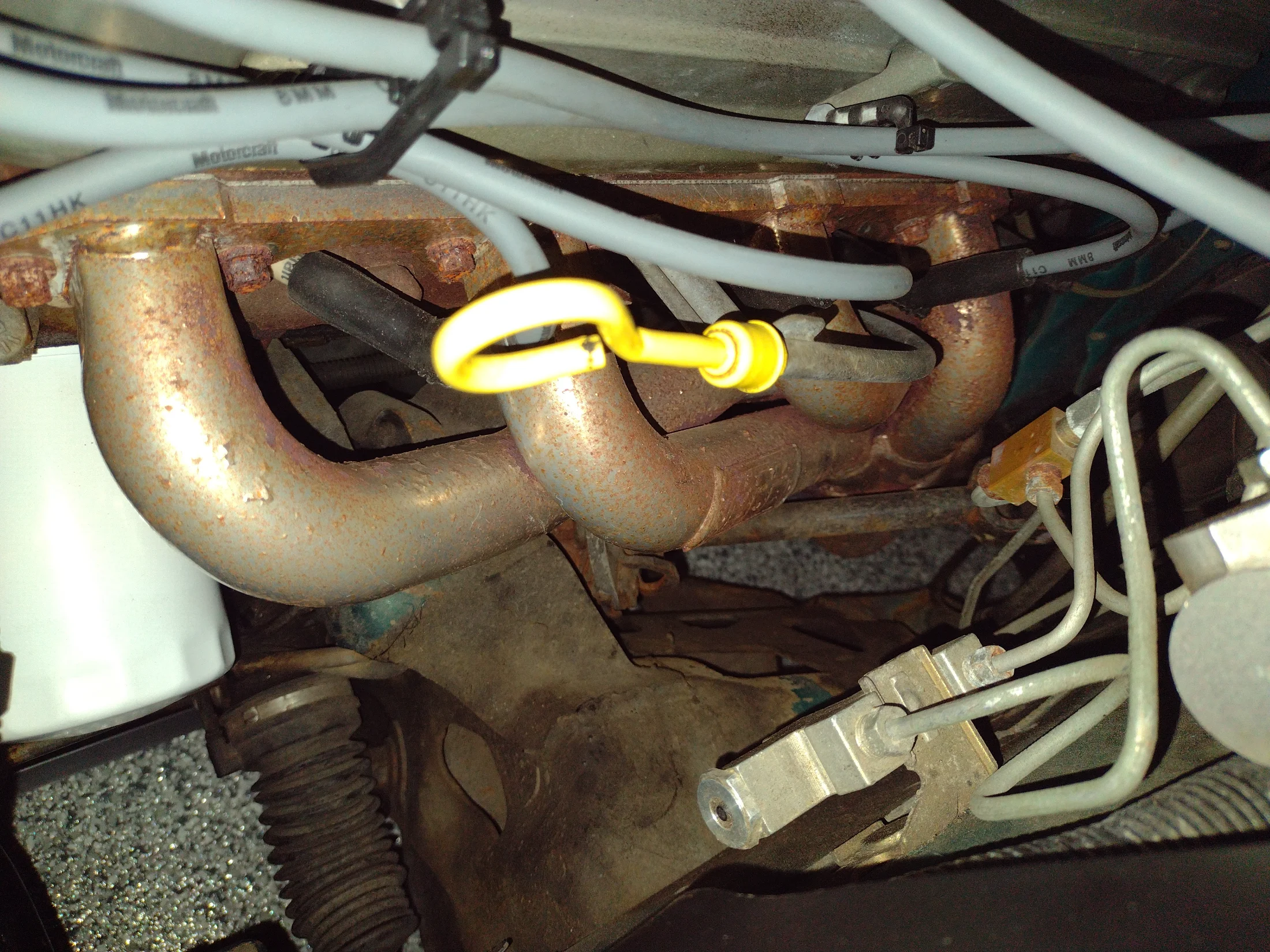

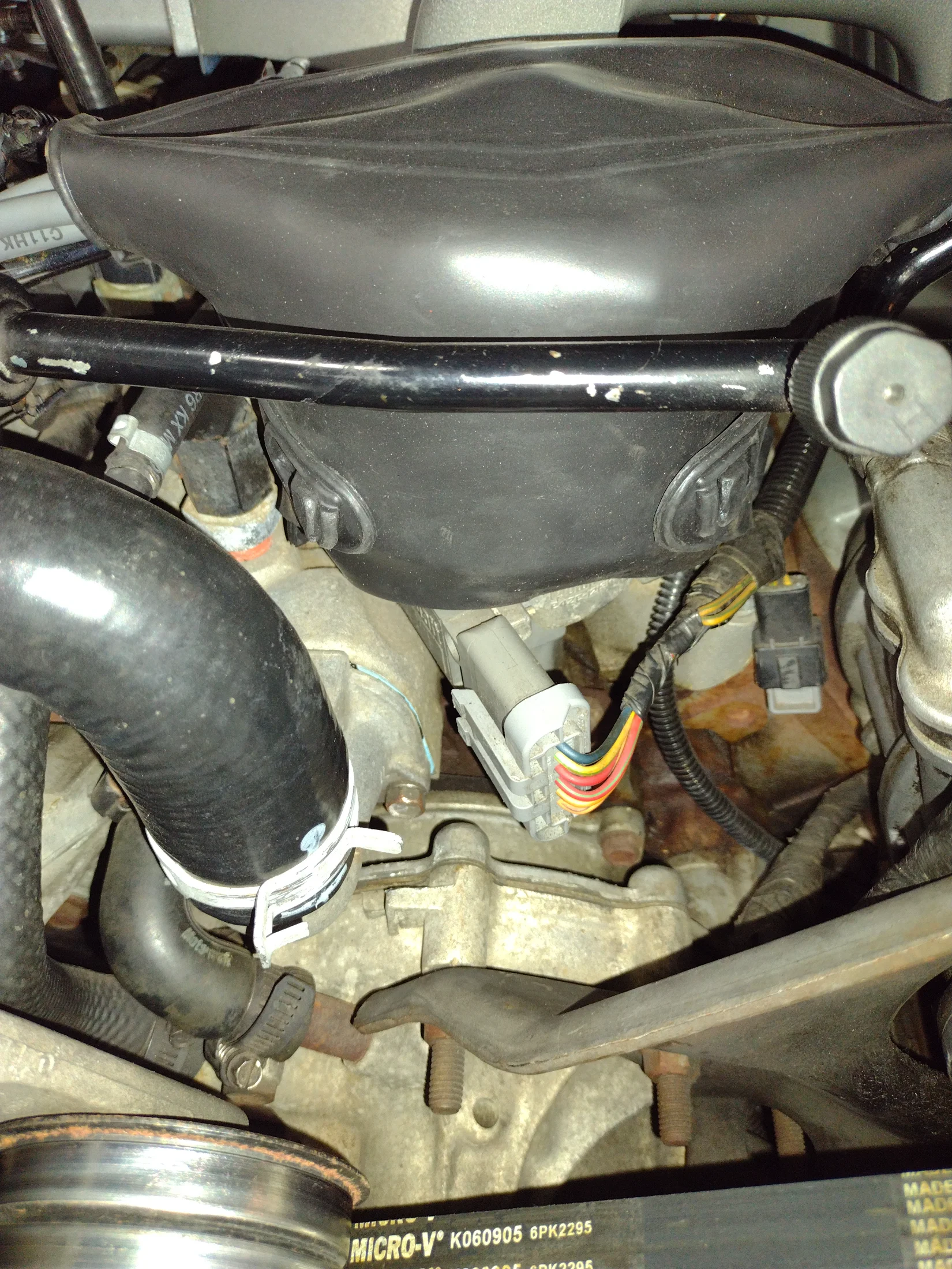

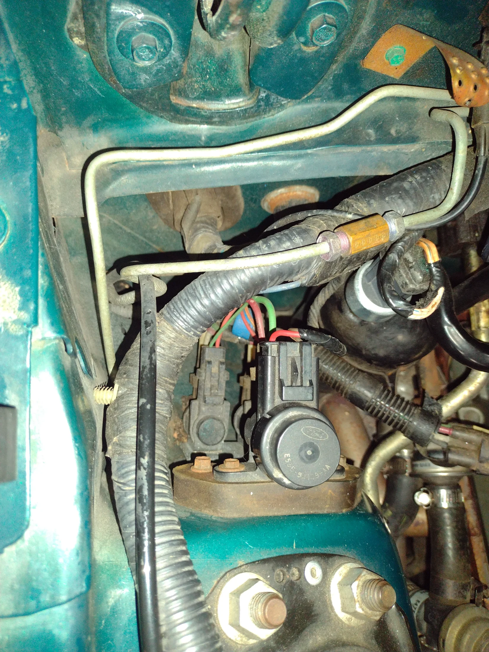

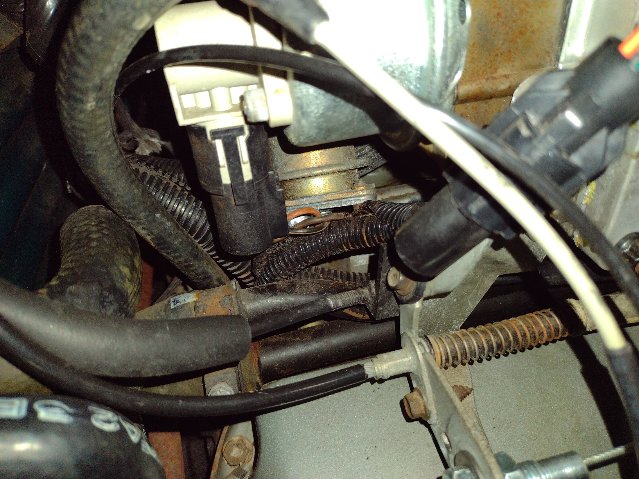

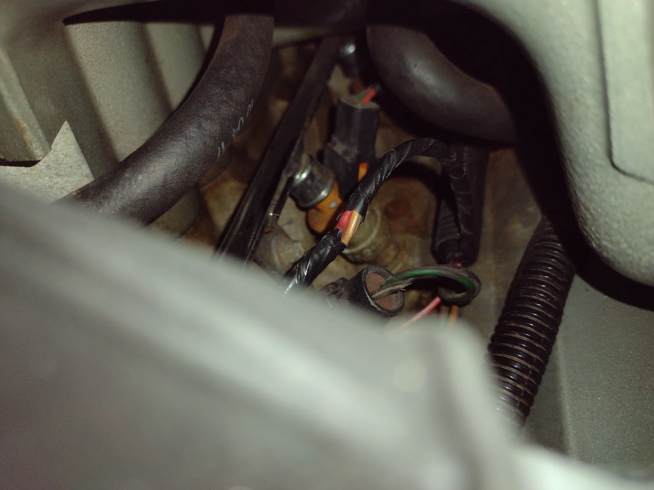

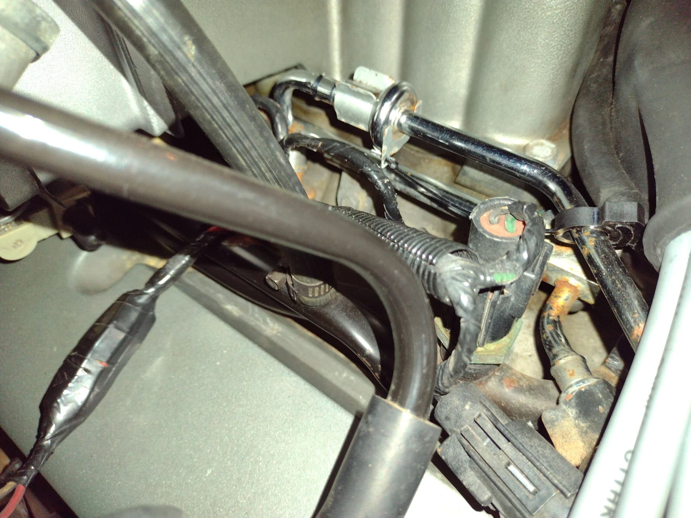

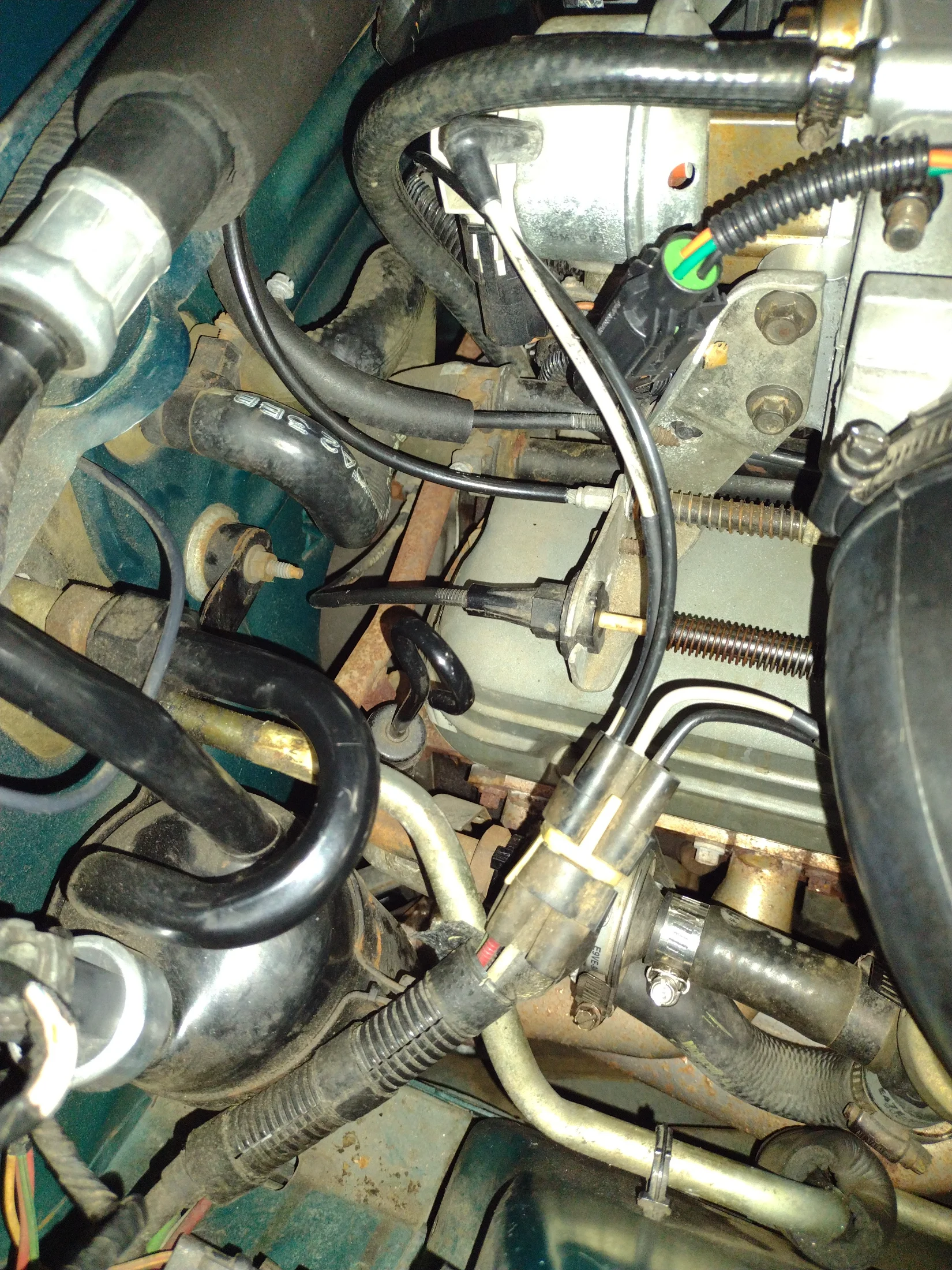

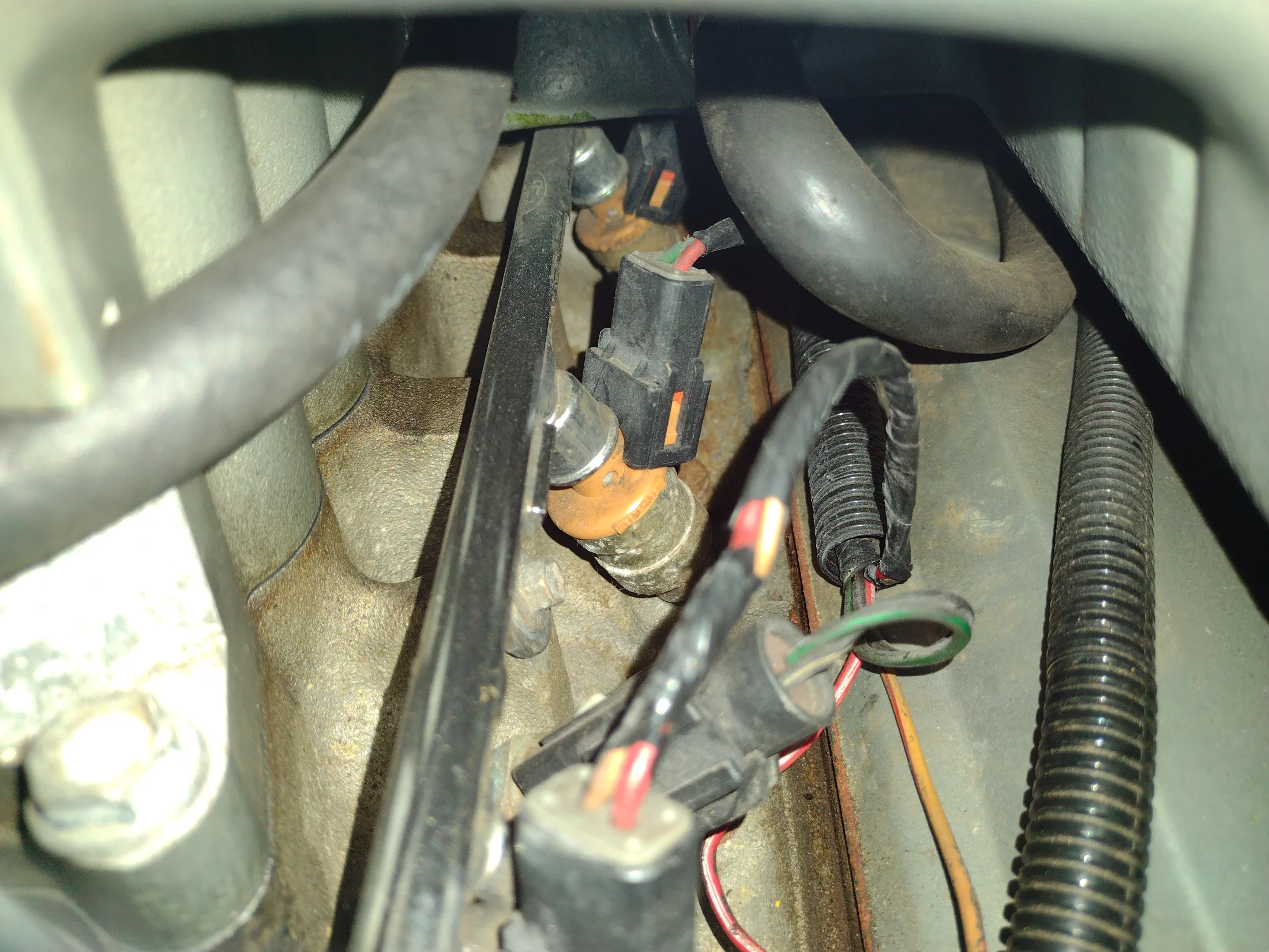

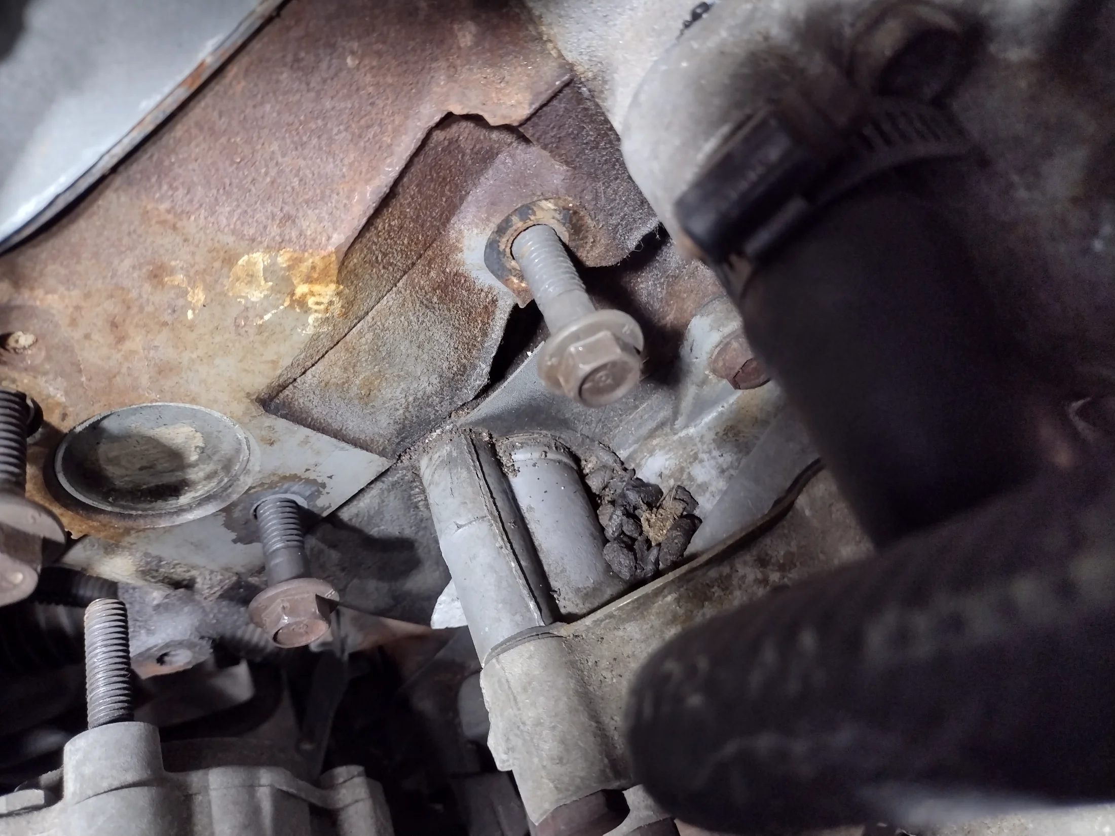

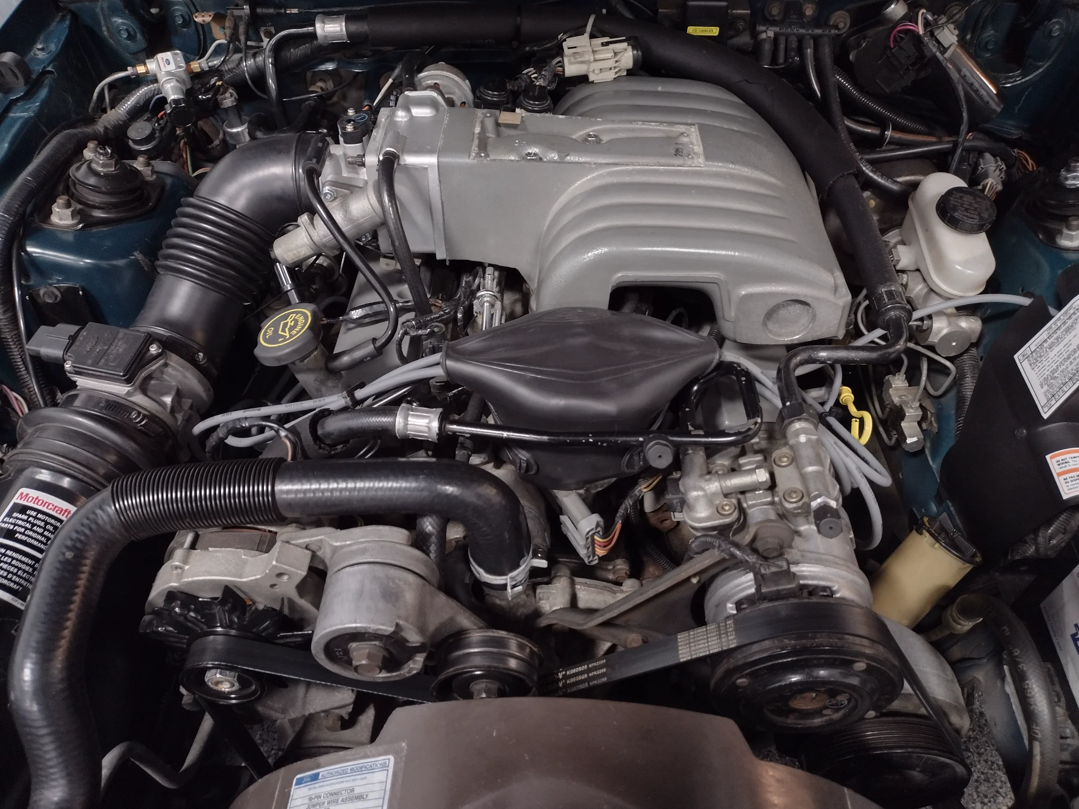

Hey everyone,
It's winter storage time here in Minnesota. I can't stand how bad the engine bay looks on this "low mileage" 90 7 up convertible....
Verified mileage on Carfax and auto check does show it's correct. Around 36k original miles. The problem is, 6 plus owners came from New York.
The engine parts show a lot of corrosion. I plan on working on it over the winter. I have a spare upper and lower intake manifold that's going to get powder coated. The upper I planned on matching the valve covers.
New remanufactured injectors, hoses, heater core tube, thermostat, ect.
I was thinking about adding a accufab 65mm throttle body if it works with the stock MAF.
I may also get some brackets powder coated.
Anything else I should look for?
I'll keep this thread updated as I make progress.
Edit: I even found some old mouse turds...car runs good otherwise.

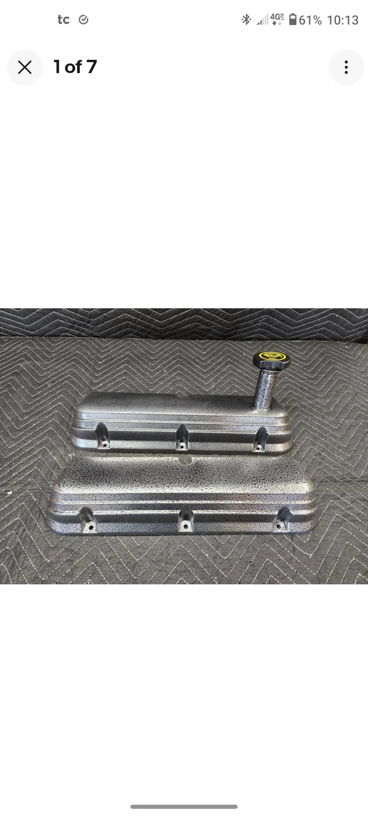

I'm not fully understanding what you are shooting for here.
If it's a excellent condition stock factory original look, don't mess with finishes.
An accufab will look out of place in that engine bay for sure and provide no performance gain.
It only takes a few minor changes to make an engine bay not look original.

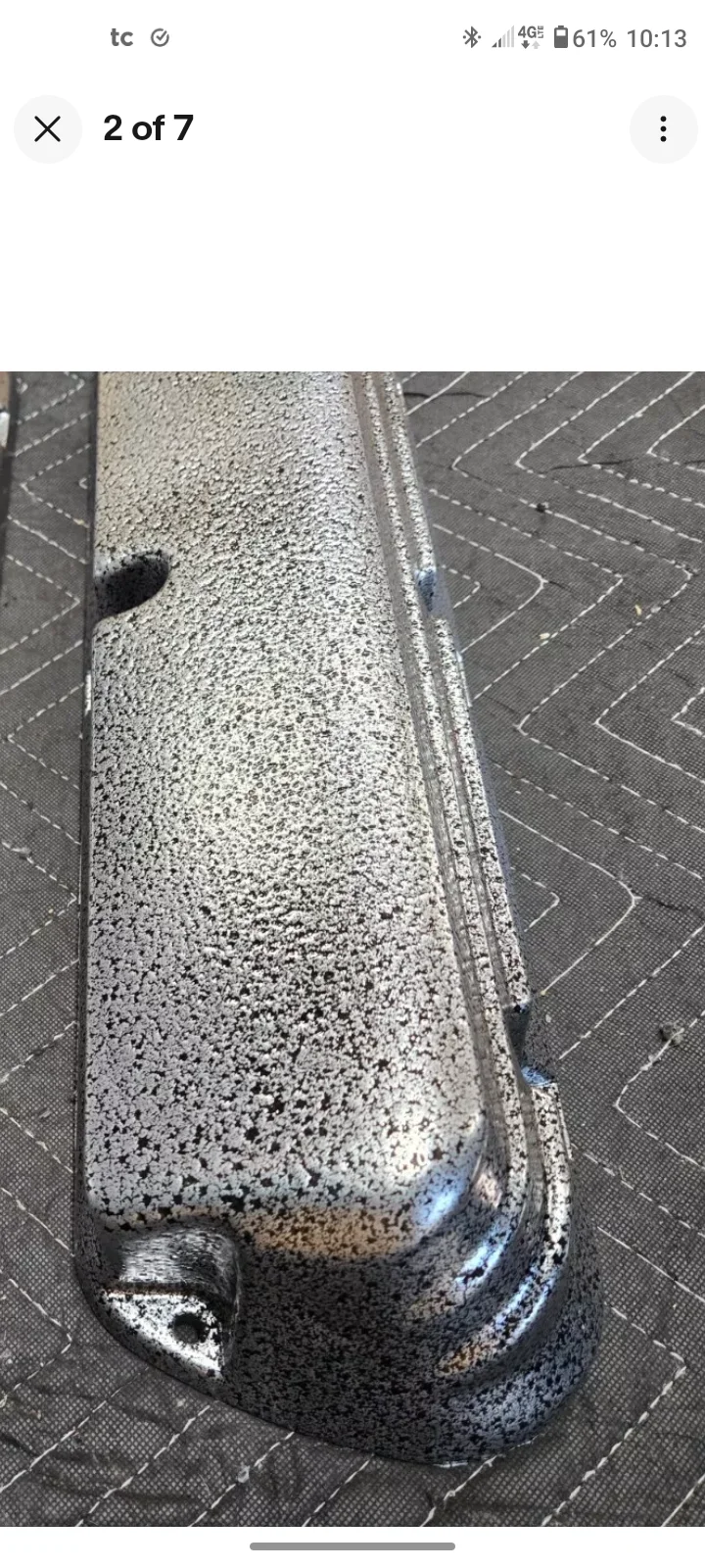

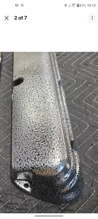

I certainly would not use those valve covers nor would i paint the intake to match them.
I'd just clean up what you have as well as possible and replicate the factory look.
I think the key for this look is making it look like nobody touched it.

I've thought about that as well. I can definitely put the valve covers on my modded notch or just sell them. But it is hideous everywhere.
I mean the valve covers have surface rust on them. I hate it. How am I suppose to remove that surface rust?
I have two spare original lower intakes and one spare upper. How do I effectively clean inside and outside?
Either you are bad at pics or that's not exactly "Hideous everywhere", lol.
It may not be up to your standard, but i bet there are quite a few guys around here that would take that engine bay over theirs.
It's probably going to take some research for each type of surface you need to treat based on how they were done in the factory.
I'm by no means a restoration expert, but there are ways to get rid of surface rust, assuming it's just surface rust.
There are also hundreds of stock intakes floating around, maybe just find the best one and swap it in.
I think you just need to take one part at a time. It could be slow and time consuming, but with a car that low in mileage, i think it could be worth it.

The injectors can be removed and taken to have ultrasonically cleaned which will clean the outside as well and they will look brand new.
The injector rails have some surface rust on them but I would think they would clean up with some 0000 steel wool and some WD40. Worst case is see what it would cost to get them rechromed.
Pull the valve covers and have them hot tanked, wash with soapy water (Dawn) & let dry, wipe them down with brake cleaner & let dry, and then shoot them with the appropriate color of gray.
Paint on the block and heads - pretty sure the factory color was grey and then in some where in late 1992 or early 1993 when they quit painting them from the factory altogether.
I wouldn’t bother with an Accufab TB on a stock intake manifold. The restriction is the lower. Nothing to gain performance wise and in hand the Accufab is a jewel that will look out of place.
You’d be surprised what elbow grease, new fasteners and some paint/powdercoat can do.

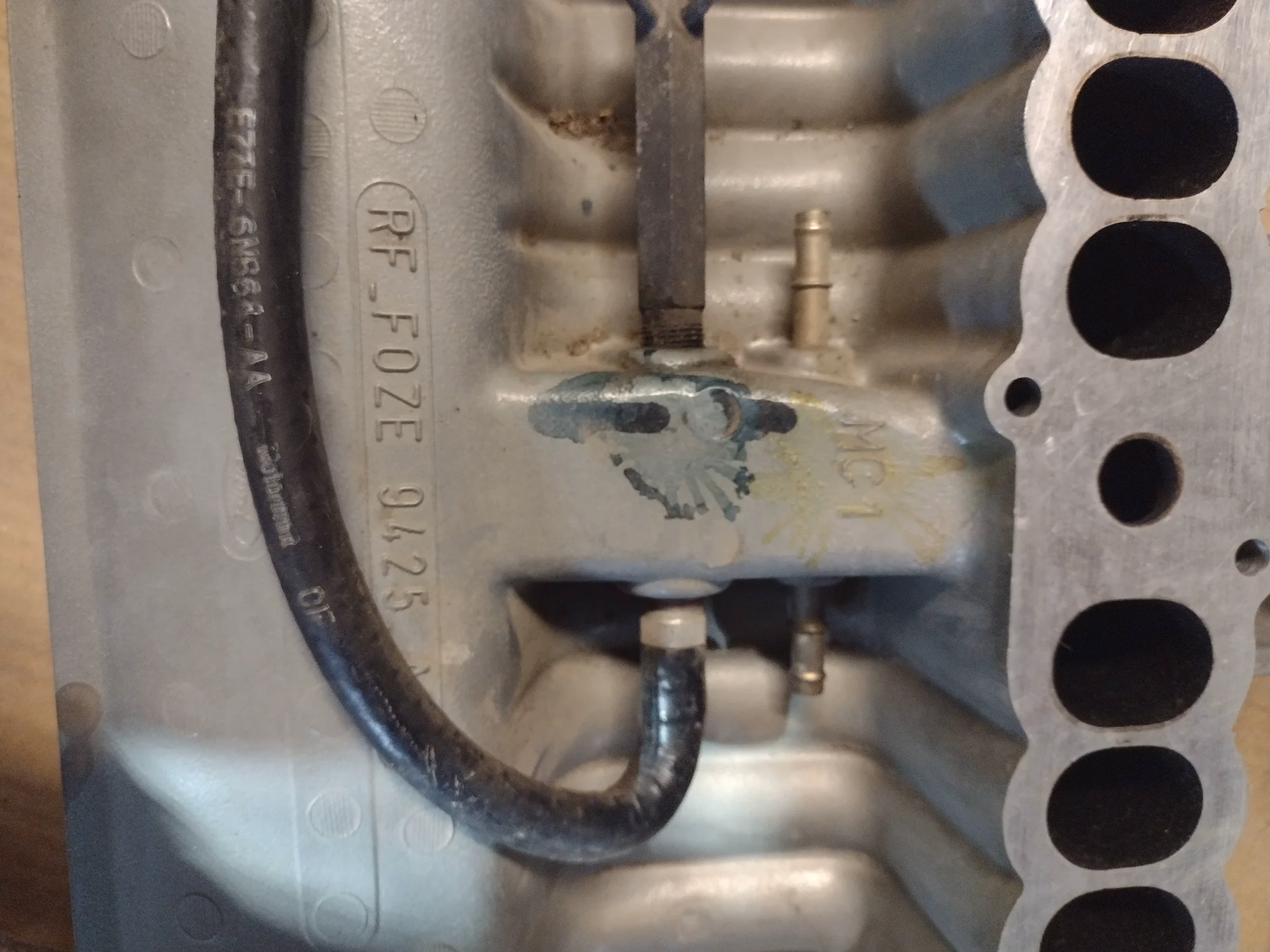

Also I found a pretty clean stock upper intake manifold, but might be an 86 HO unit. It comes with the stock throttle body as well. Is there much difference from the 87-93 manifolds?
The E6SE intake is not considered a HO intake. The difference is the inlet after the throttle body. It's a little narrower. This intake also came on later 5.0 non-HP engines. 1986 throttle body would be smaller as well. I would steer clear
HO intakes were 87-93. The casting part numbers would be E7ZE, E8ZE and F0ZE,
Appreciate the information! Looks like my spare is a correct one for my setup. I'll have these powder coated and leave my original one.
