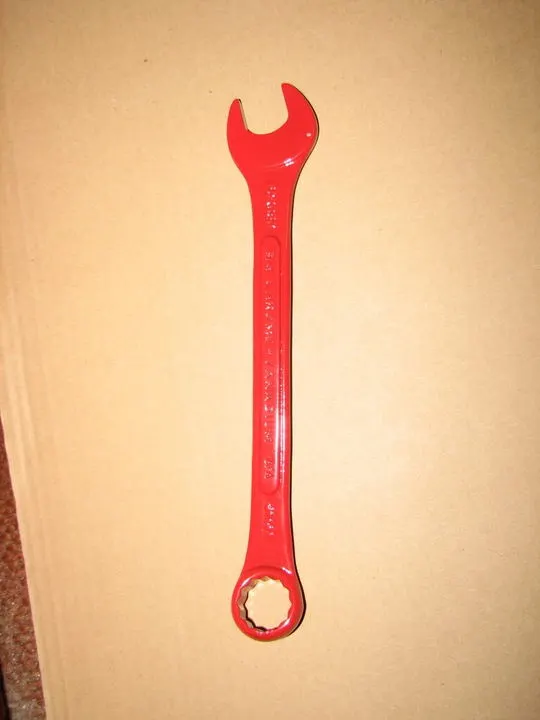

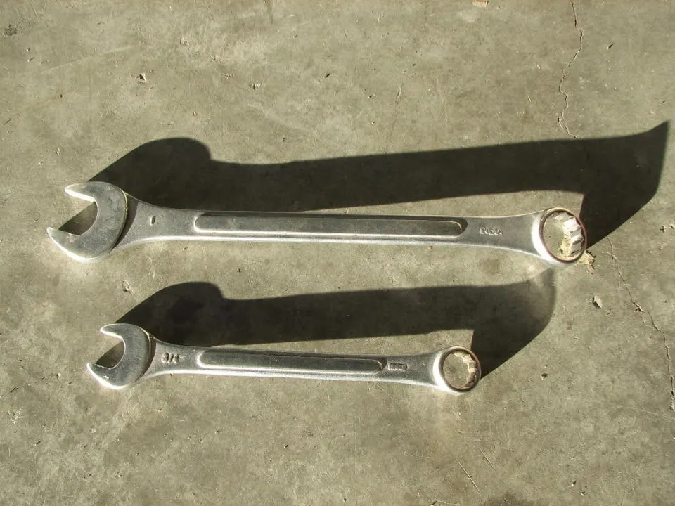

here's the before and after.....
i only had enough time to do one of the wrenches so both "after" pics are of the same wrench. i apologize for the out of focus pic. damn camera
I'll do the other wrench in yellow on monday.
i can see a couple of spots where the powder was applied to thin, and i also touched the wrench against the rack when i put it in the oven so i have a blank spot about the size of a pin head. other than that, i'm very happy with how it came out. i'll try to touch up the messed up spots on monday and see how that comes out.
thanx for the help!!!
i think i'm going to need a bigger oven

You'll be better off re-coating the entire thing. If you try to touch up one spot, you're going to end up with some powder 'dusted' in other areas, and when it cures it'll end up grainy like overspray. Also you'll have to warm up the wrench prior to recoating. Bring it to a little over 150* and then spray it. It'll help the powder stick, otherwise it'll be a bitch.

You could scuff it, but it's not necessary. Just wipe it off to be free of dust, then warm it up so that it's 150 degrees or so. At that point, take it out of the oven, then just shoot more powder on it and cure it like normal. The full 15-20 minutes.

just pulled the wrench from the oven after coat #2........LOOKS GREAT!! all of the areas that were thin before now look good, the spot that i knicked on the oven rack the first....that spot looks good. i'm EXTREMELY happy with how it came out.

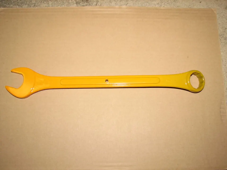

just tried using the yellow. it's MUCH harder to get a good coverage. at least it was for me. i ended up doing a double coat again. the second coat us cooling now so i'll see how it turned out and post up a pic in the morning. do you find certain colors are harder to use than others? do you find a different quality from one brand to another? hopefully coat #2 took care of the issues from coat #1.

this wrench turned out like crap!! i had it hanging from the closed end (the same way i did the red one) when i coated it. that end just would NOT coat very well. even after two coats it's extremely light. it's almost like the powder wouldn't stick? a large portion of the wrench is very thin on powder. i'll try scuffing it with sand paper this morning and reshoot for a 3rd coat. don't know what happened on this one?????? i think i'll just blame it on HF colors
is it possible that i applied the 2nd coat to early? i applied the 1st coat, baked it, let cool down most of the way, then applied the 2nd coat. should i let it cool completely, then ad a 2nd coat?
is it safe to assume that with these basic colors, i should not need to apply a second coat? or is 2 thin coats better than one thicker one?

You've got to be darn sure that you get proper coverage over everything. Sometimes it'll look like you did but after looking at different angles under good light you'll notice you missed a little. This is especially true at corners and lips/edges and with metallic colors. I'd say to take a picture after spraying it but unless it's extremely obvious it'll be tough to tell from a picture where exactly to point out the areas low on powder. It's trial and error at this point, don't worry. Good news is you can re-shoot it and cure it again with no worries. While you're at it why not do some other parts so you can work on spraying technique? Won't hurt.
Post up a pic of the finish?

i knew when it was going on that it was going on different than the red. i don't know if i didn't prep this piece as well or what was going on. it didn't matter how much powder i threw at it, there were areas it just wouldn't coat properly. so i went ahead with the first coat and just planned on doing a second figuring it would even itself out. SURPRISE! it did not. i would take a pic and post it up for you to take a look at but i've already hit it with some 600 grit, have my gun ready to go, and once it warms up a bit i'm going to shoot it again.

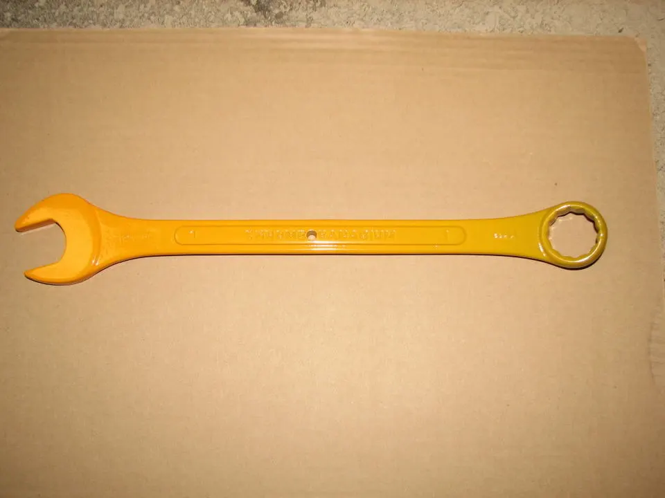

here's a couple of pics of how it turned out.....
on the right side of each pic, you can see the powder is a bit thin. i know why this happened and that will be corrected on the next job. other than that, the job came out very good....IMHO
