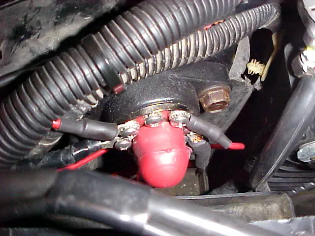

Like a lot of you guys, I have way too many powered accessories! Which, of course, includes a bunch of power wires, cluttering up my engine bay and/or fuse panel. For example, I have: one wire for the alarm, one for my Ipod controller, one for my power amp/subwoofer, one for my external T-Rex fuel pump, and finally one for my Crane ignition box!! That is too many wires, with three directly on my battery, and two on the starter solenoid. It looked like crap, to put it plainly. It needed to be cleaned up, and with my 1st show approaching, now was the time.

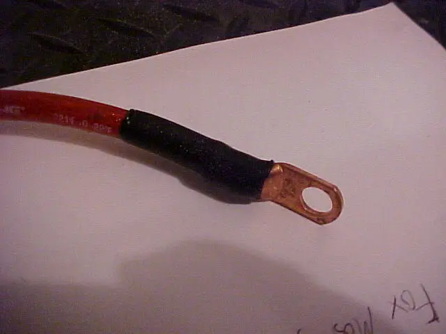

Next I fabbed up a nice large gauge cable. I did use the blingy type of audio cable, simply because I had some on hand, and it was going to be hidden, in the fender well, for the most part. I used heavy duty copper terminals, soldered in place, with a torch. I also used a really good quality glue infused heat shrink tubing. I want this setup to last, function well, and be indestructable! Here is the cable:

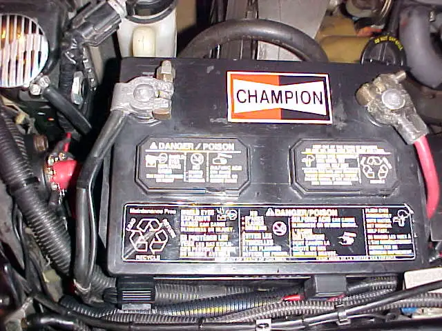

Anyway, I found another spot, bolted to the radiator header panel, in front of the battery, towards the front of the car. This necessititated lengthening all of my power wires, save one, which was a major PITA, considering that all of my cables were hidden in split loom, heat shrunk etc. etc! Here is where it ended up:
Note the desired end product, of nothing wired up to the battery, except for the positive and negative cables, as it should be. Although it can't be seen, due to the coil cover, there is nothing 'extra' cluttering up my solenoid, either.

I used on of those red boots off of a one wire alternator, just to insulate the connection. It was not necessary, but I tend to incorporate a lot of overkill in my projects! I tested it out, and so far so good, everything powered up just fine!
ps. The battery is a custom made, high powered Interstate battery. Interstate dealers generally don't stock the MTP (high power) 58 series, for some reason. They all have 58R's with reverse terminals, though?! Strange. Anyway, the custom order didn't cost any more, and it comes through finished in plain black. A couple of eBay Champion stickers later, and it really complements the look, underhood, with ties to Champion being the original battery supplier to Saleen.
