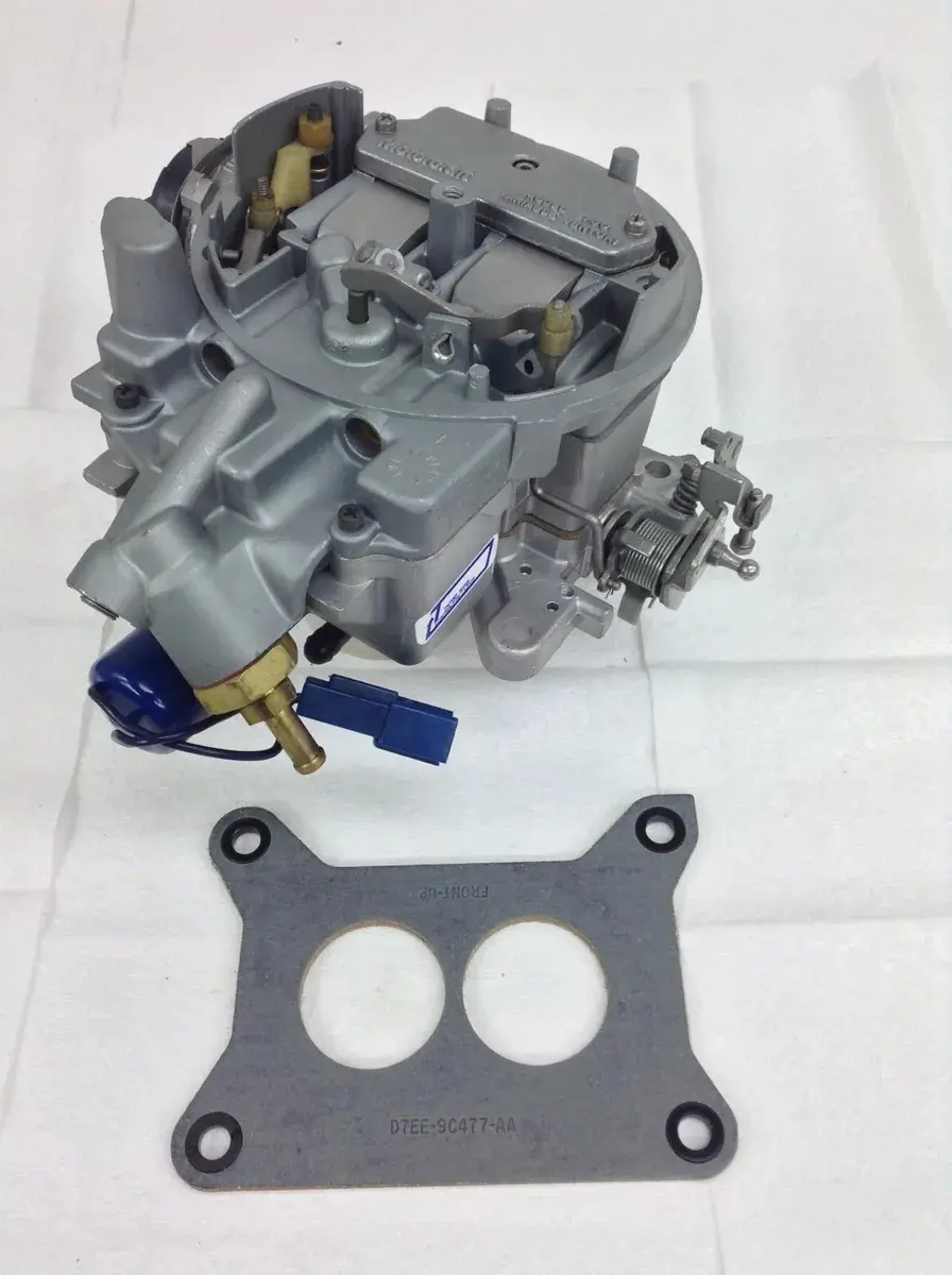

Had to screenshot your video, but it looks like you've got the Cali only Variable Venturi carb..... :confused:
Just looking at different pics, I think they'll swap right in place of the variable venturi carb you have. It would make sense from a manufacturing standpoint as they would've had to cast a special manifold just for Cali cars in addition to the "special" carburetor. By having the carb mount match it would save them money. So I'd give an educated guess that it's a simple swap.
Variable Venturi carb with gasket:
2150 carburetor with gasket and EGR plate:
The gaskets look identical to me.....

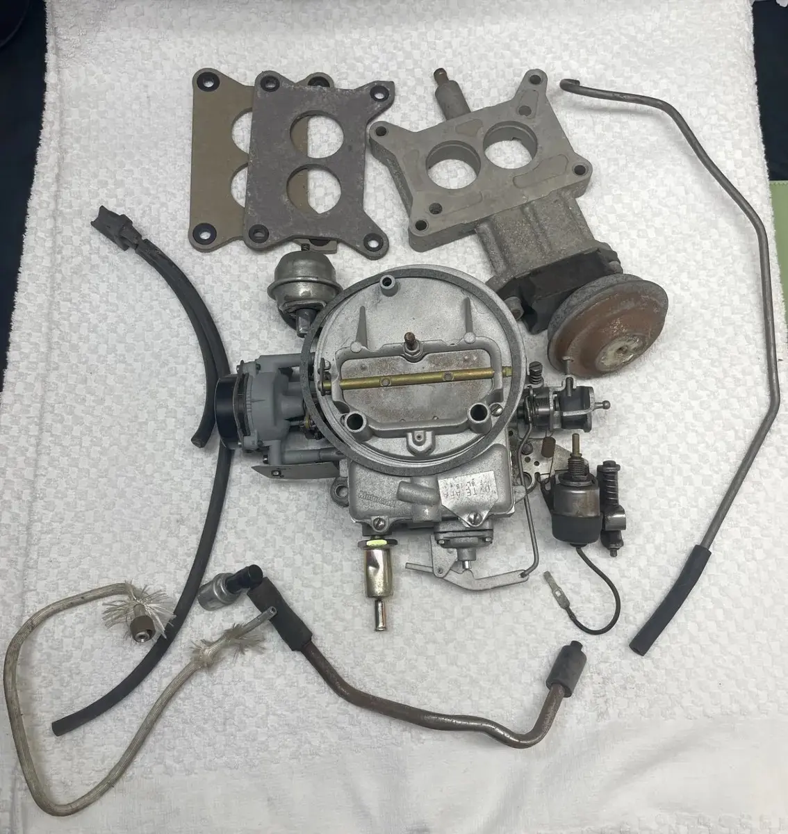

Hey my bad, carb came yesterday and I can confirm a 2100 does not fit on a 2.8L. It is blocked by the EGR and valve covers. I'm in the process of returning it but I put the old one back on and it still cranked right up. It Idles nicely at ~550rpm but putting it in gear or applying throttle too fast stalls it. It's clearly a lean issue and I'm trying to figure that out. My valves are not lashed because I definitely hear lifters but I don't think that makes it too lean. Nevertheless, this weekend I have new valve cover gaskets so ill take them off and get that out of the way. I was messing with the pcv valve and it seemed that plugging it with my finger made it run more smoothly and when I removed my finger it stalled the engine. I'm not sure where to test for lean condition other then maybe buying a fuel pressure tester and running it from the line to the carb. Also maybe a jet in the carb could be clogged I guess? I don't know. Anyway here are some pics :D

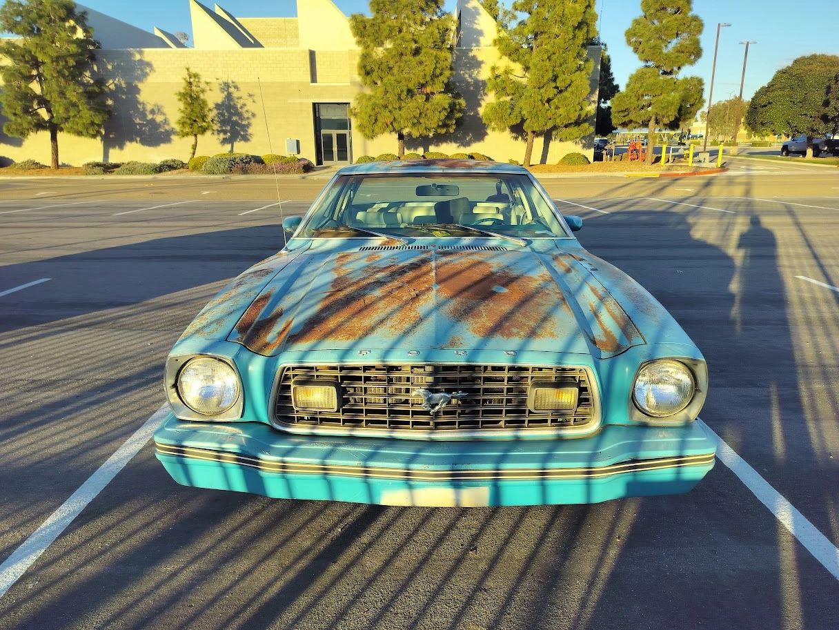

That is a cool ass color!
If it were mine:
Wheels, brakes, suspension, window tint, clear coat or shine juice.
I wouldn't change a thing as far as paint and body goes.
Oh, and it needs a boosted stroker and the driveline to handle it. :D

Wonder why you ran into clearance issues. From the pics I've seen it looked like either the 2100 or the 2150 would most likely be a direct replacement. And it seems that others have done it with no issues to speak of - at least that's my understanding from different posts in different forums I've seen....:shrug:
I think it's meant for a small block but it gets blocked by the egr because of the fuel filter location on a 2100/50. I'm trying to figure out the surrounding air/fuel issues before replacing a potentially functional carb. also I got the accelerator pump working by zip-tying the linkage together so she does squirt fuel down the carb now
So you are one of those "patina" guys? :ack: J/K :)
Not on [every] car but c'mon... Nobody can paint Robin's Egg blue anymore and the parts that are left can be buffed to a high shine. Lightly block sand the rust and seal it.
The [grill] on that car is what makes it. :nice:
Just gotta get that "fk with me an be sorry" rumble. :D
