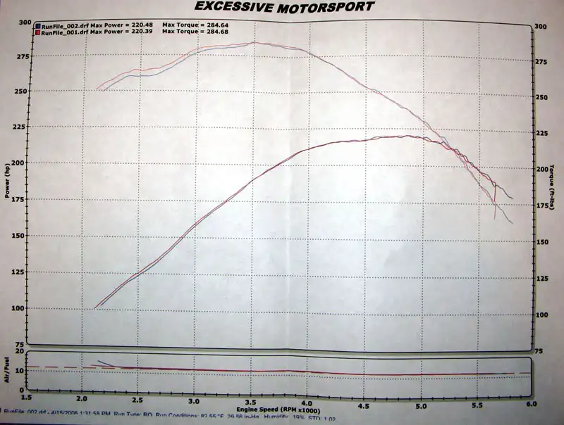

Im just looking for a realistic gain from a few parts Im putting on the stang.
So far Ive put down 220rwhp and 284rwtq. That was with the following parts.

Im thinking I should be somewhere around 240rwhp and 300+rwtq. :shrug:
Here is my last dyno sheet.
Really only gains will come as a result of the increas in maf diameter and intake...however you may have acutally offset the increase by going too large on the headers...I would be surprised if you saw any increase in HP or tq of more than 10-15.
Your guess seems about right, i would go with more base timing and 93 octane you can safely run 14* or so (every car is different) Keep advancing till it knocks and then back it down slightly.

The larger headers seems to have lost a bit of low end torque but it picked up a bit on the top end.
Ill be getting it dynoed once Its all back together. My shop is having a 3 pulls w/ AF for $50 deal.
