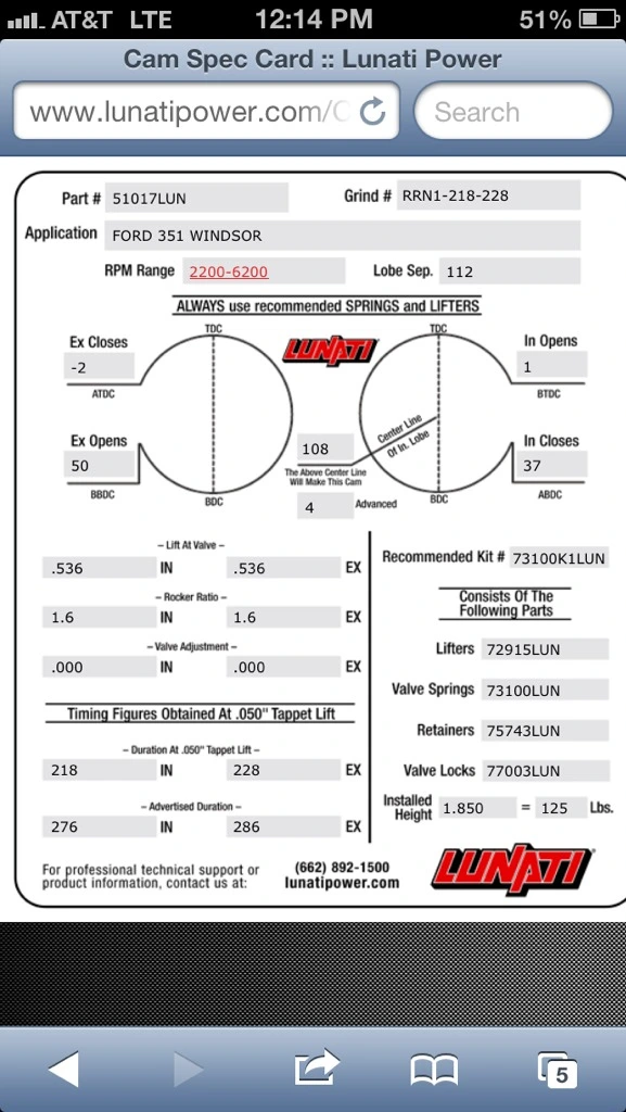

Lunati RRN1 218-228 - What do you think about this thing on the street with 3.55 gears (had stock gears when I had the motor in) ?
Pistons and rods . I have Ross racing flat top .030 over pistons and eagle H beam forged 5.400 rods . I want to order a bearing kit and a SCAT stroker crank .
With my old motor I have edlebrock performers with 2.02 valves and springs for the cam I have .
Would this combo work 331 with these heads and cam ? How would drivability be ? Should I sell the cam in favor for let's say a comp xe270?

Brainstorm number 1000000 - What about this cam , 1.6rr with twisted wedge heads on a stock bottom end ? too much duration to even bother or is it worth a shot

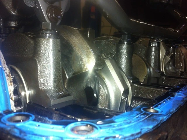

Rick the old motor I had was a stock crank , 5.400 rods , and custom Ross pistons and it broke the crank and the first journal a year ago .. i still have the rods and pistons and was trying to get away with a budget build .
The motor I bought was second hand already built and the price I couldn't pass on it but in the long run it bit me ...
