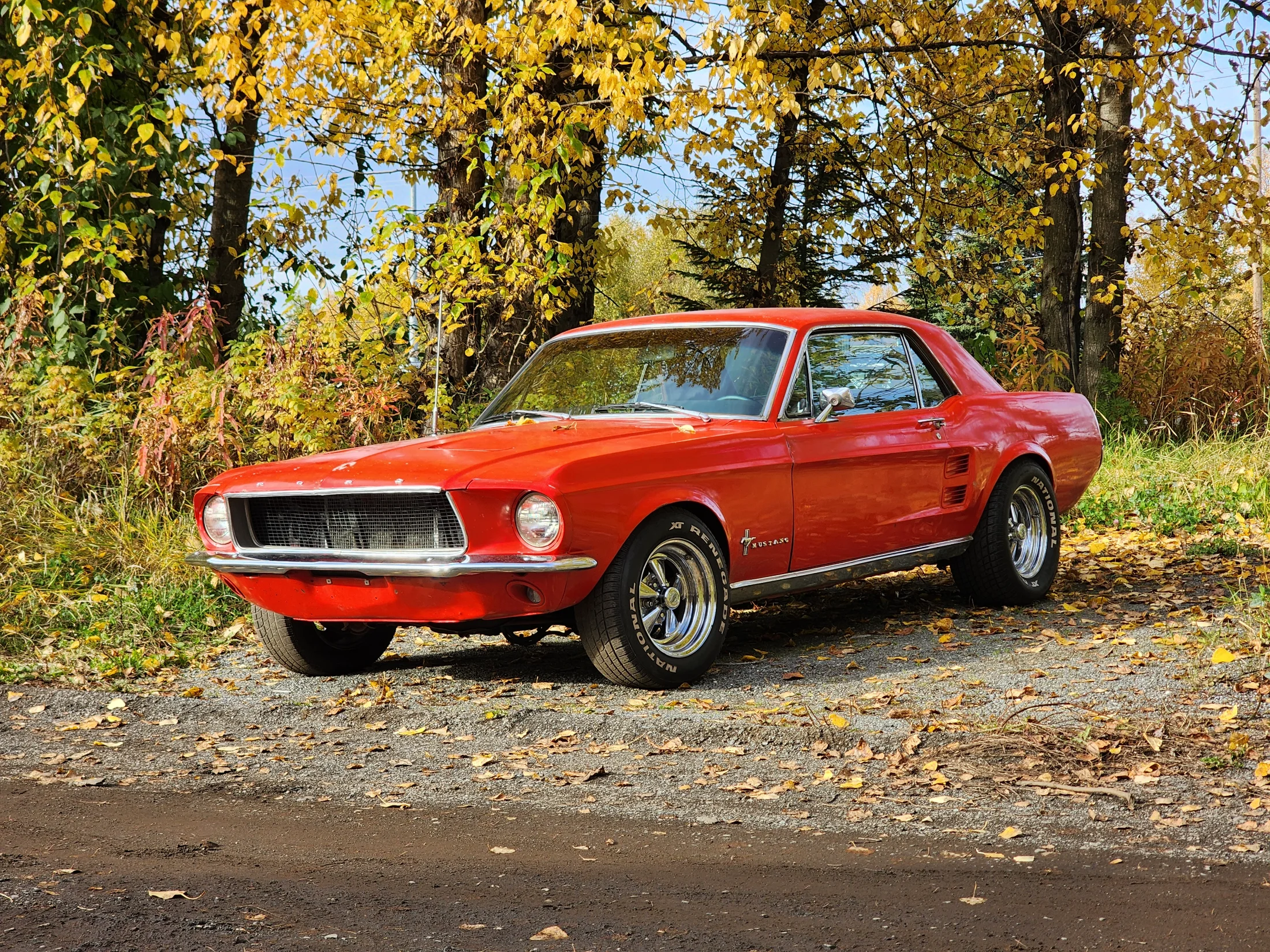

Hey! You got any pics of said car for what will be your progress thread? :nice:
Yeah here it is! I'll be doing body work and paint this winter as well.
