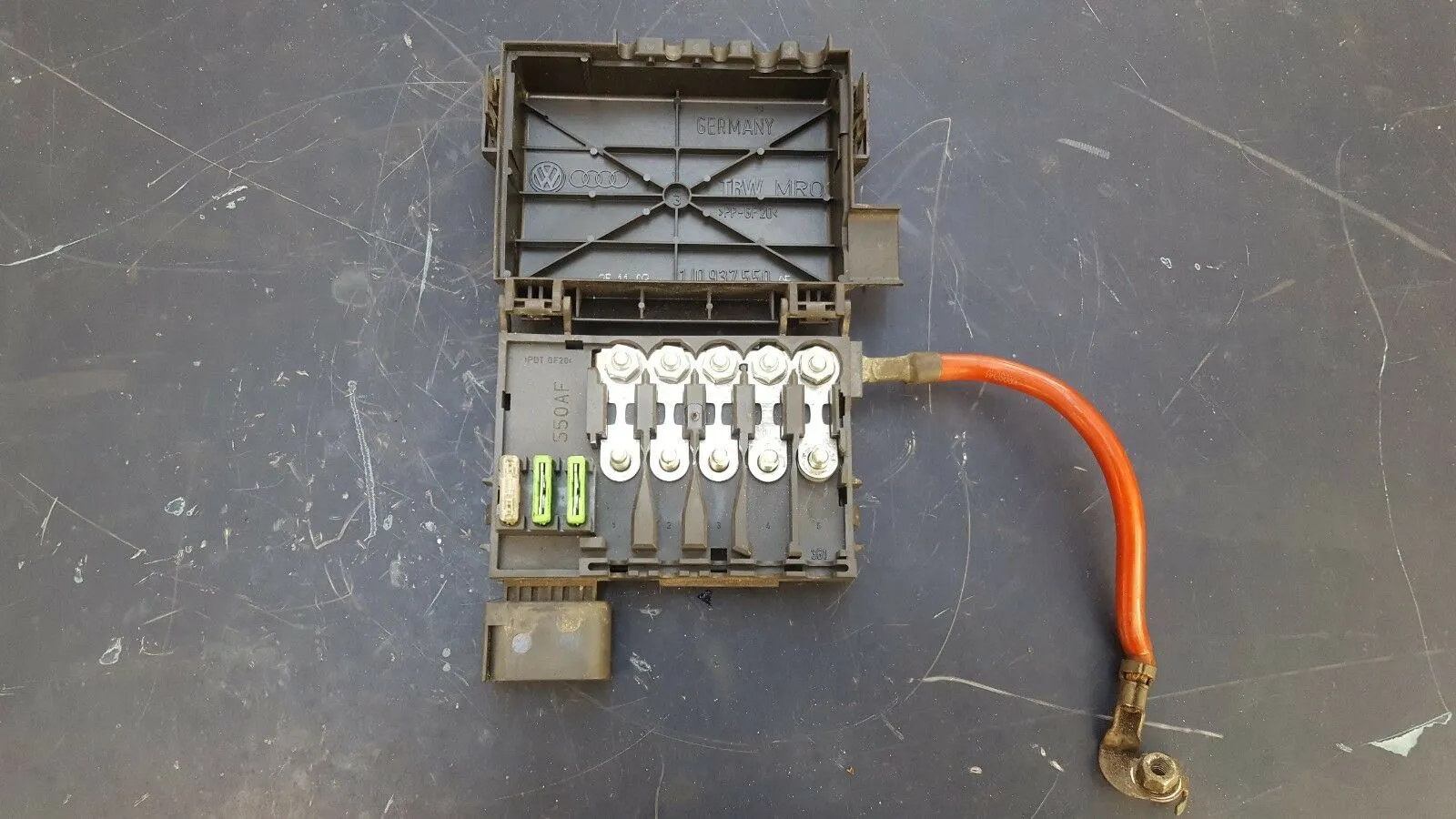

$5 @ Pick-N-Pull. Off an '01-'05 VW. Just sayin'.

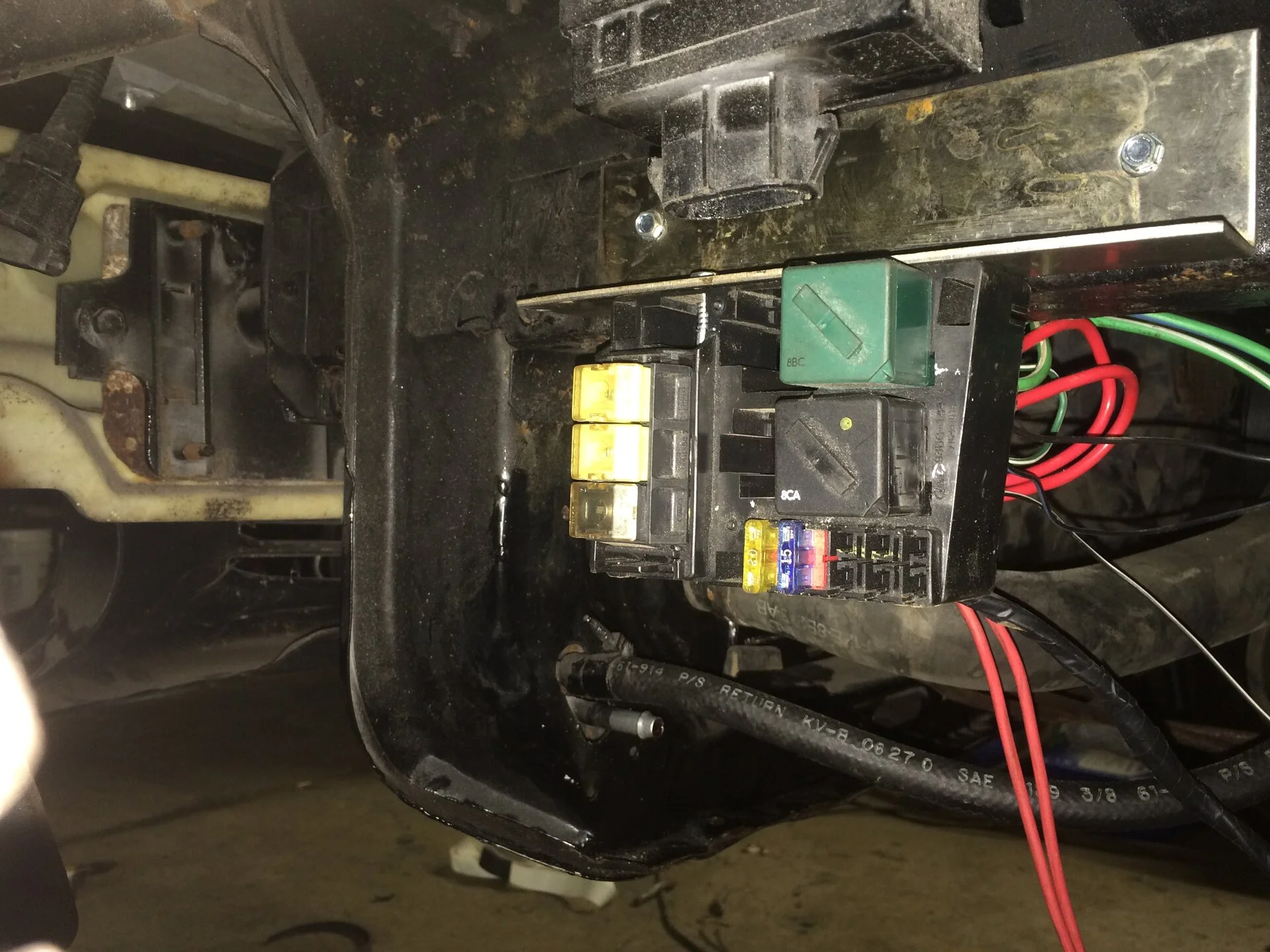

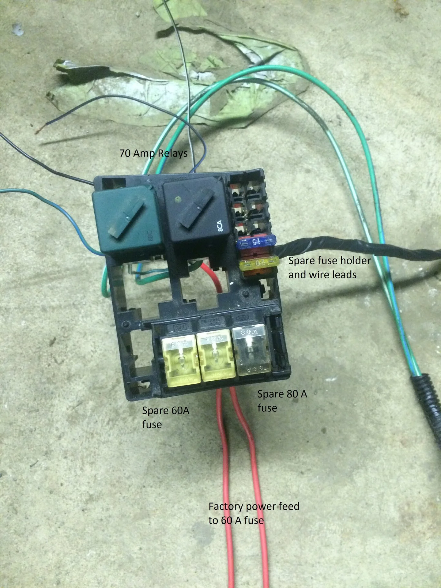

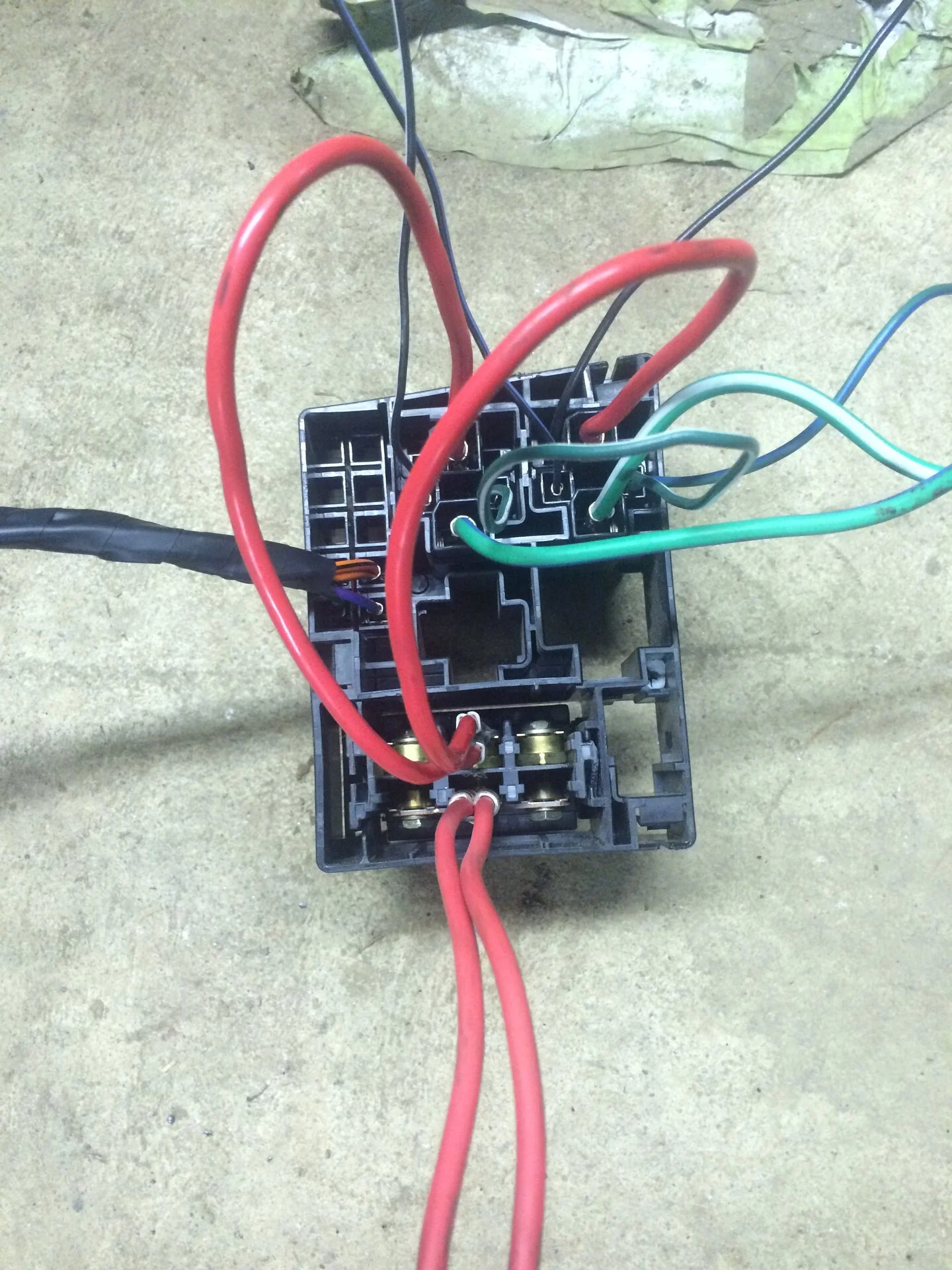

When I did my Contour fans I used the Contour fuse block with the relays. It gave me some spare fused circuits as well.
