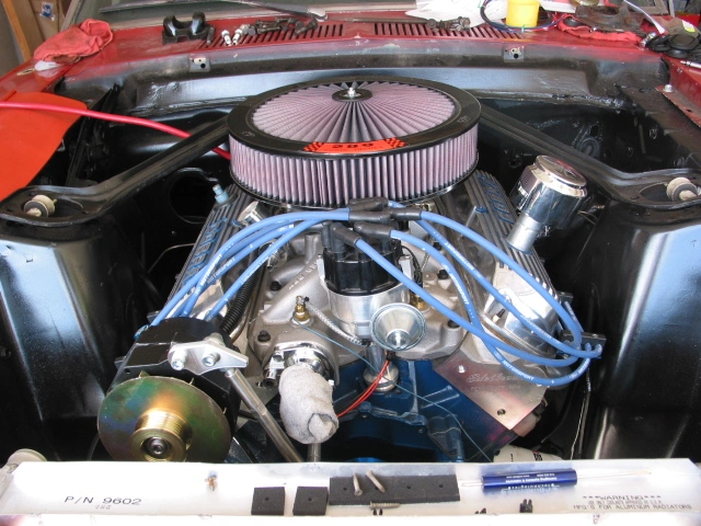

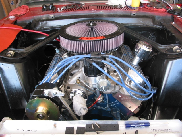

I just put a 140a PowerMaster in mine. Only problem is I cannot get the pulley off, even with an air powered impact wrench. That nut is TORQUED on there like crazy! So for now I'm going to have to live with the fugly gold colored pulley.
