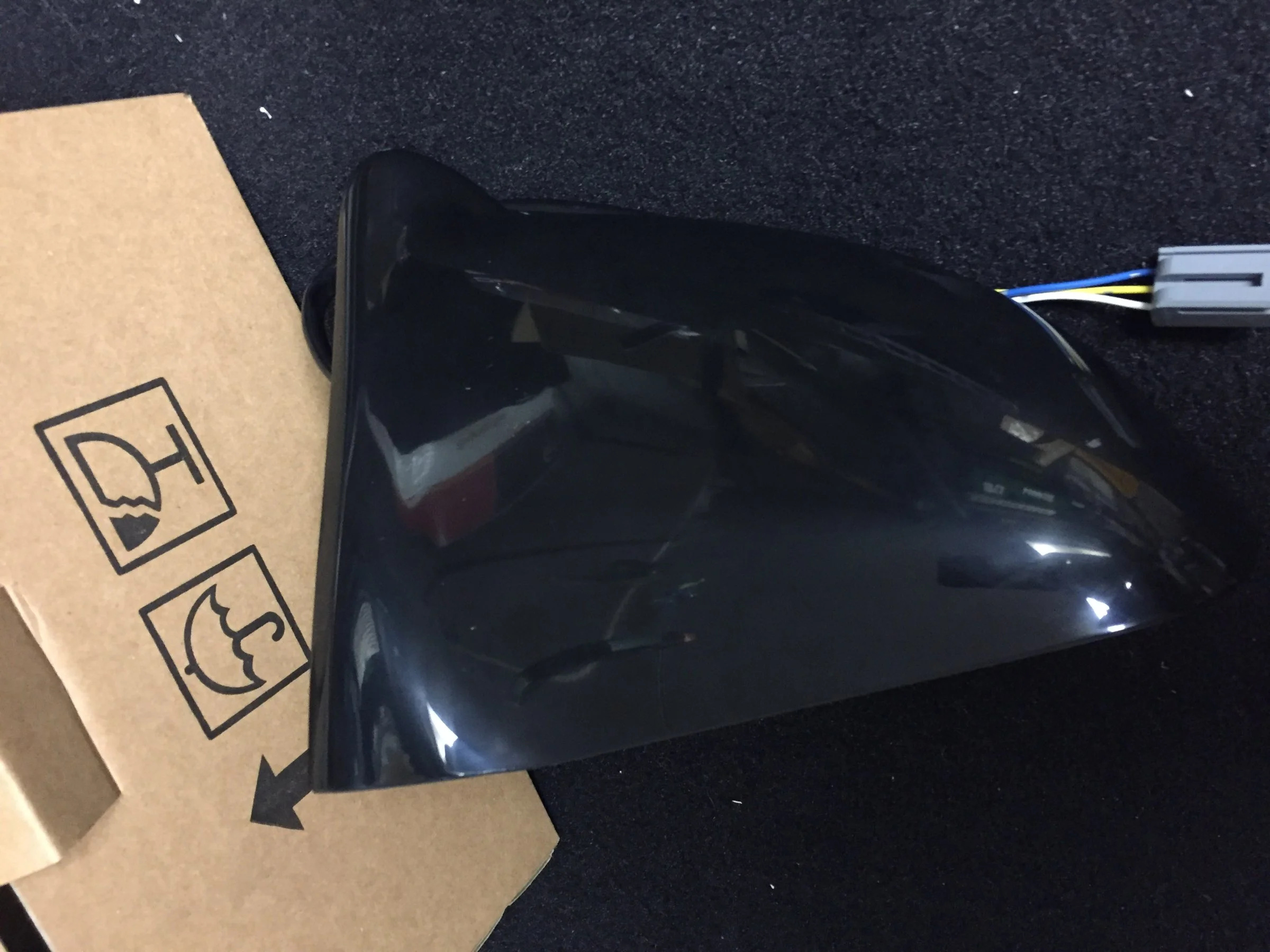

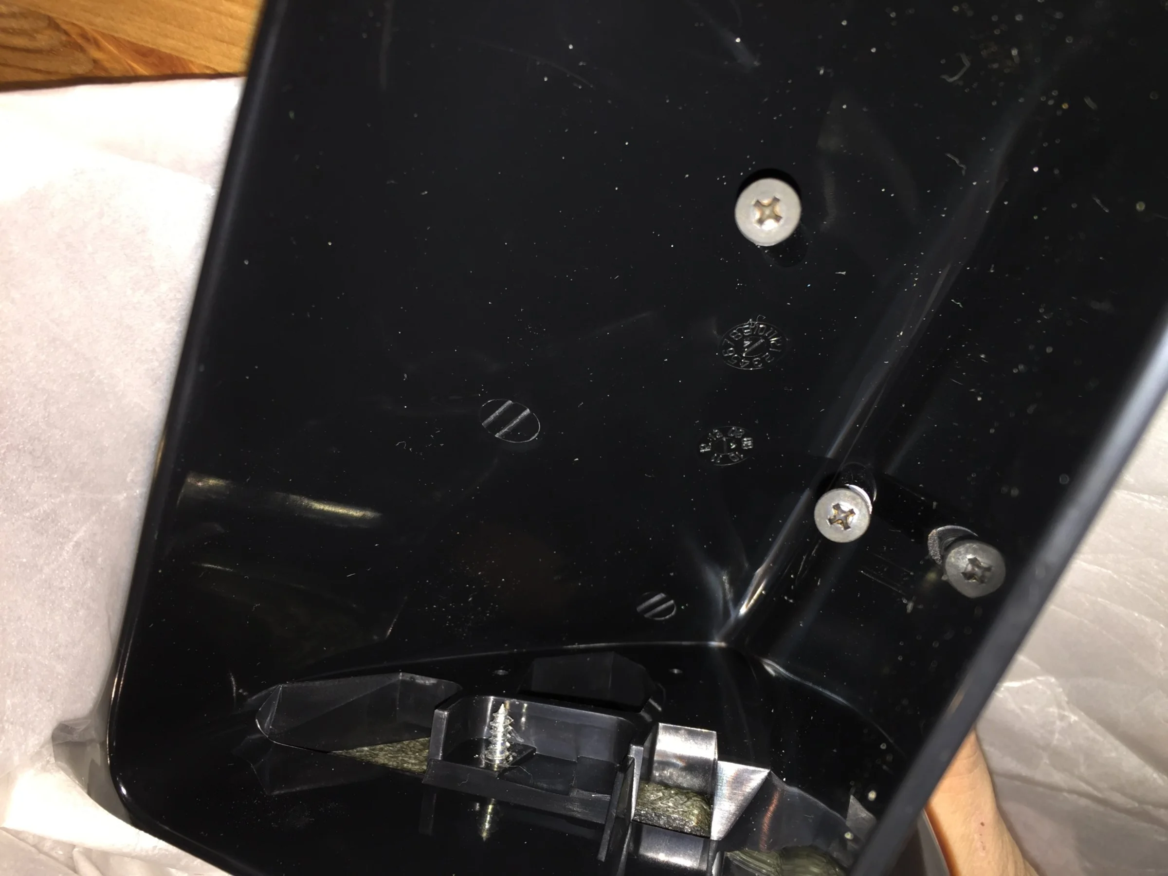

So I ended up buying the above mirror. I figure $36 was worth a shot.

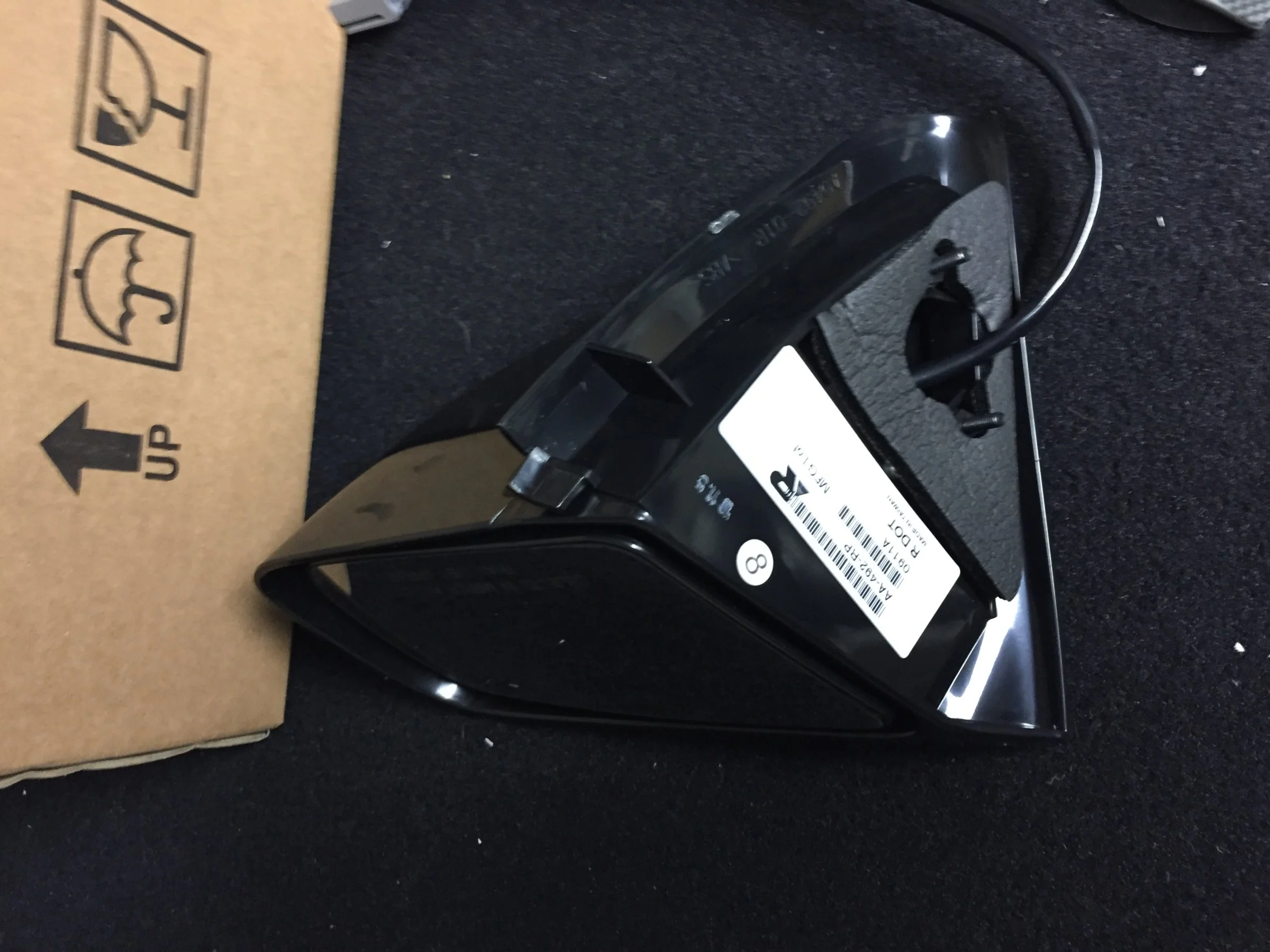

Initial impression. Not bad. The housings are shiny as hell, but it looks to be molded correctly. It just has a modern cheap plastic feel to it.
However, looks like they use the same mirror motor mounting bracket and motor setup. I'll confirm when I pull it apart. I'm basically going to take the guts out of this and put it in my existing housing.
As soon as I get a 9v battery to jog the mirror over, I'll disassemble and post pics.
I'm sure the housing is fine but I'm just very overly anal about originality and prefer to keep my housing.

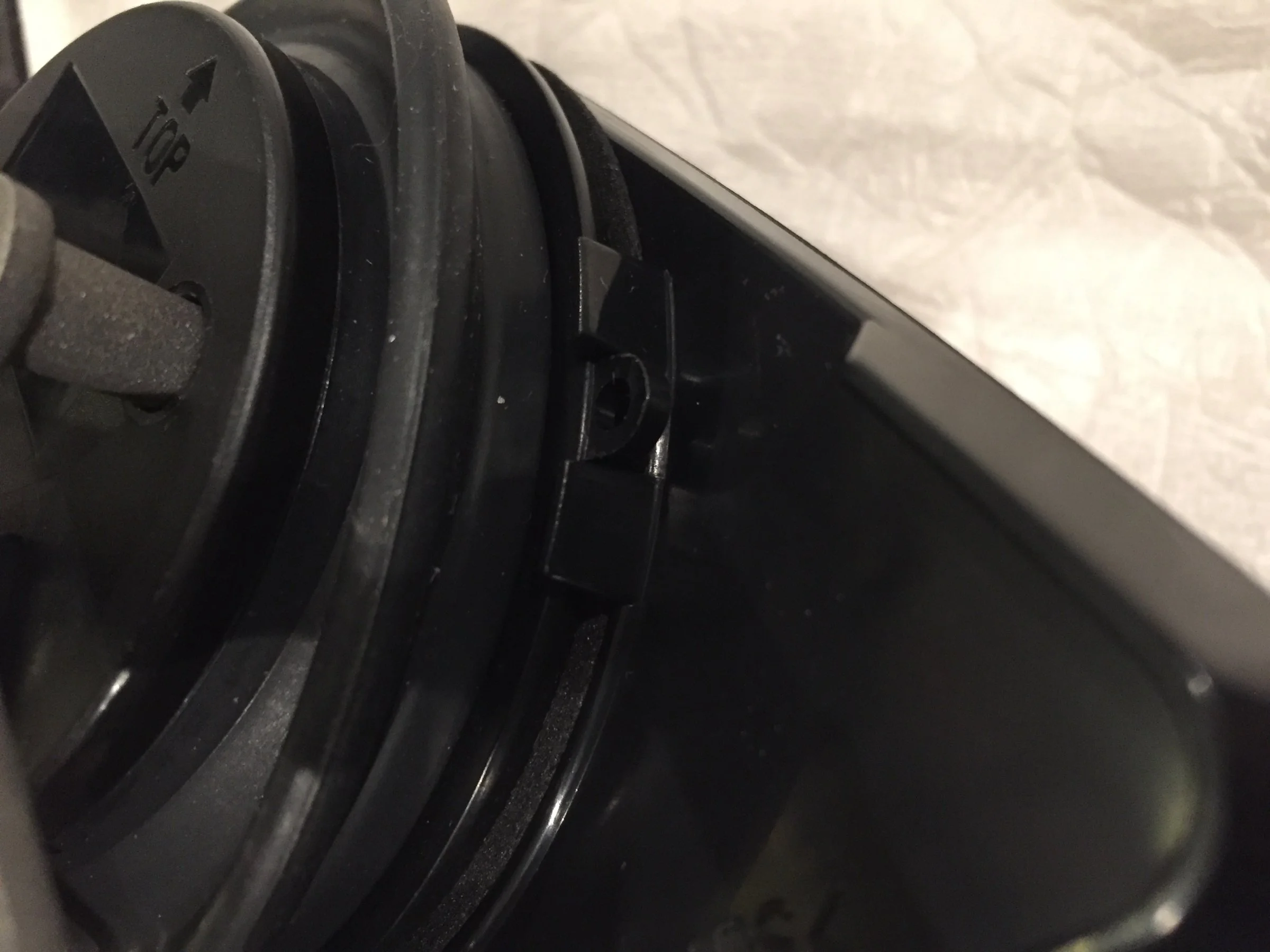

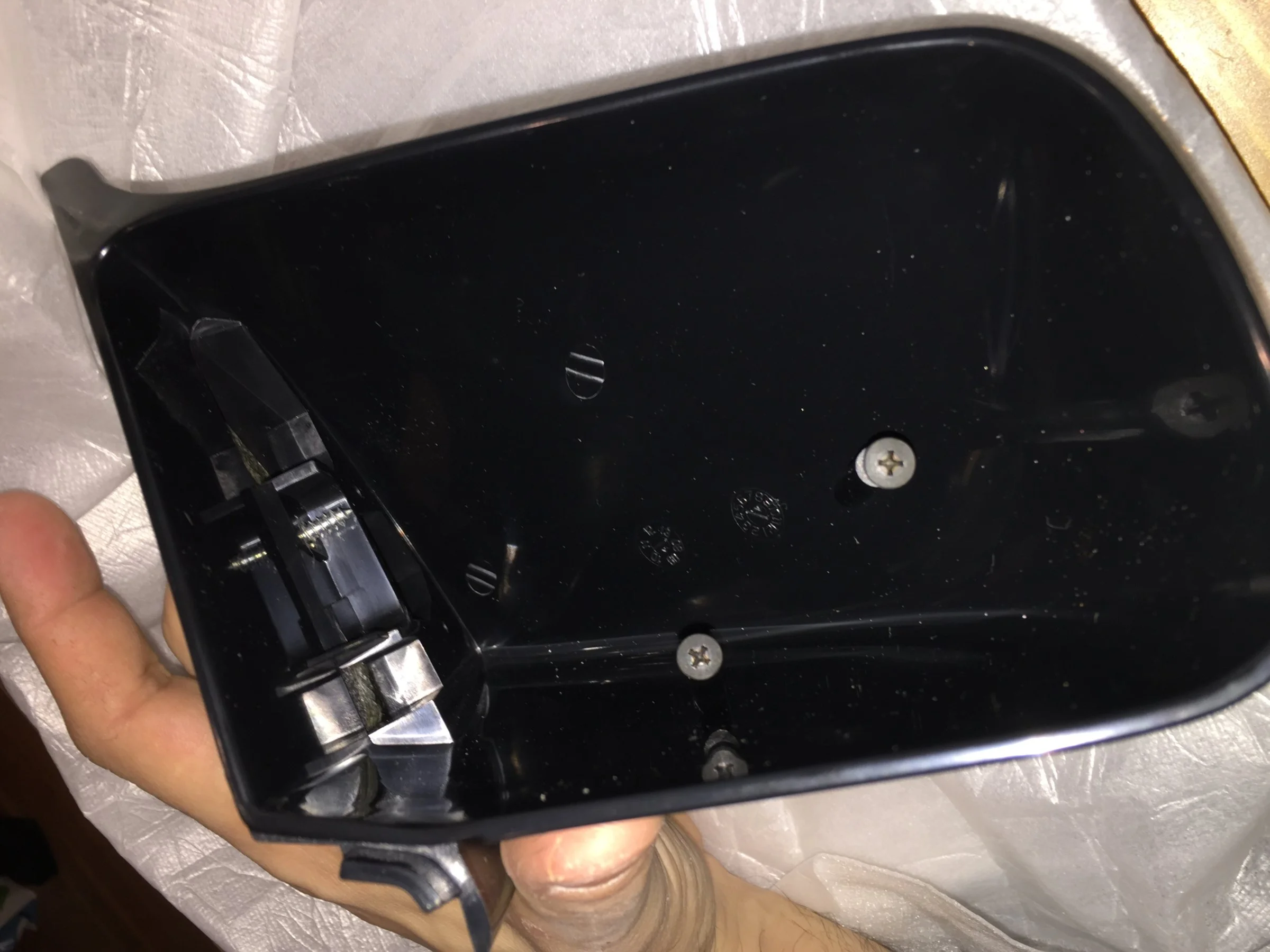

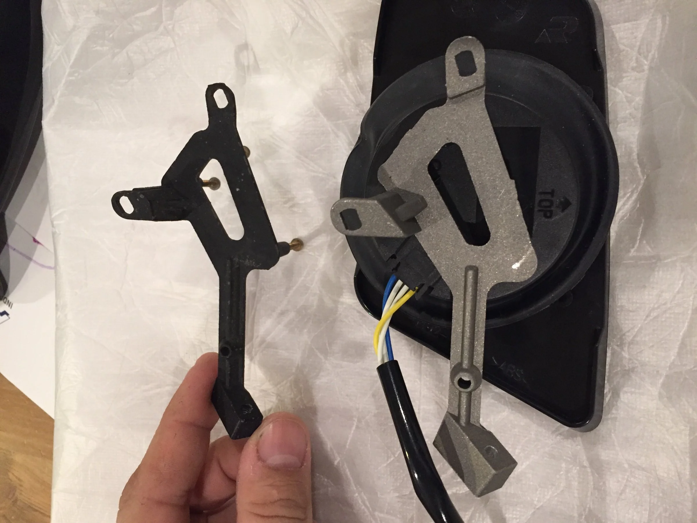

So I pulled it apart. This mirror is pretty much identical to the oem mirror.
I was able to install the original motor support bracket in the new housing
The motor also features clip on mirror style attachments as well as the old post mounting method...so I could put the original mirror on if this one delaminates
So basically for $37 you can buy that mirror and swap it into your original housing. This comes in handy if your mirrors are painted, as mine are to match all the window trim/moldings.
The new housings aren't all that bad. Just very, very glossy.
As for the motor, it's a Chinese copy of the original. It's Very silent! Given that any replacement motor you find will likely be Chinese made, this is your best option really.
So, $37 shipped times 2...take the parts you want, or install the entire thing. Your call.
