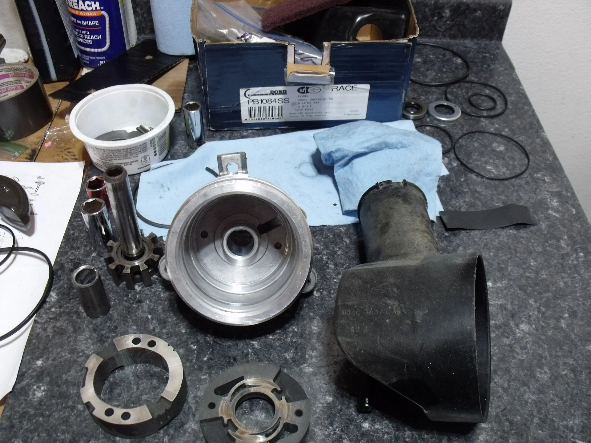

This is a motorcraft pump ( could be the original to the car).. I was cleaning it up to possibly reuse and noticed a shaft leak so I was going to put a new seal on... The entire "kit" was $15 to my door with all of the orings, shaft seal and a new shaft bushing...
Wish me luck....

How did the rebuild go? What fluid did you end up going with?
Pump rebuild went well.. I could not have done it without the ford service manual... Certain steps were tricky..
One was compressing the internals, to be able to remove a large snap ring... My Spring compressor ( for heads) worked out great for it...

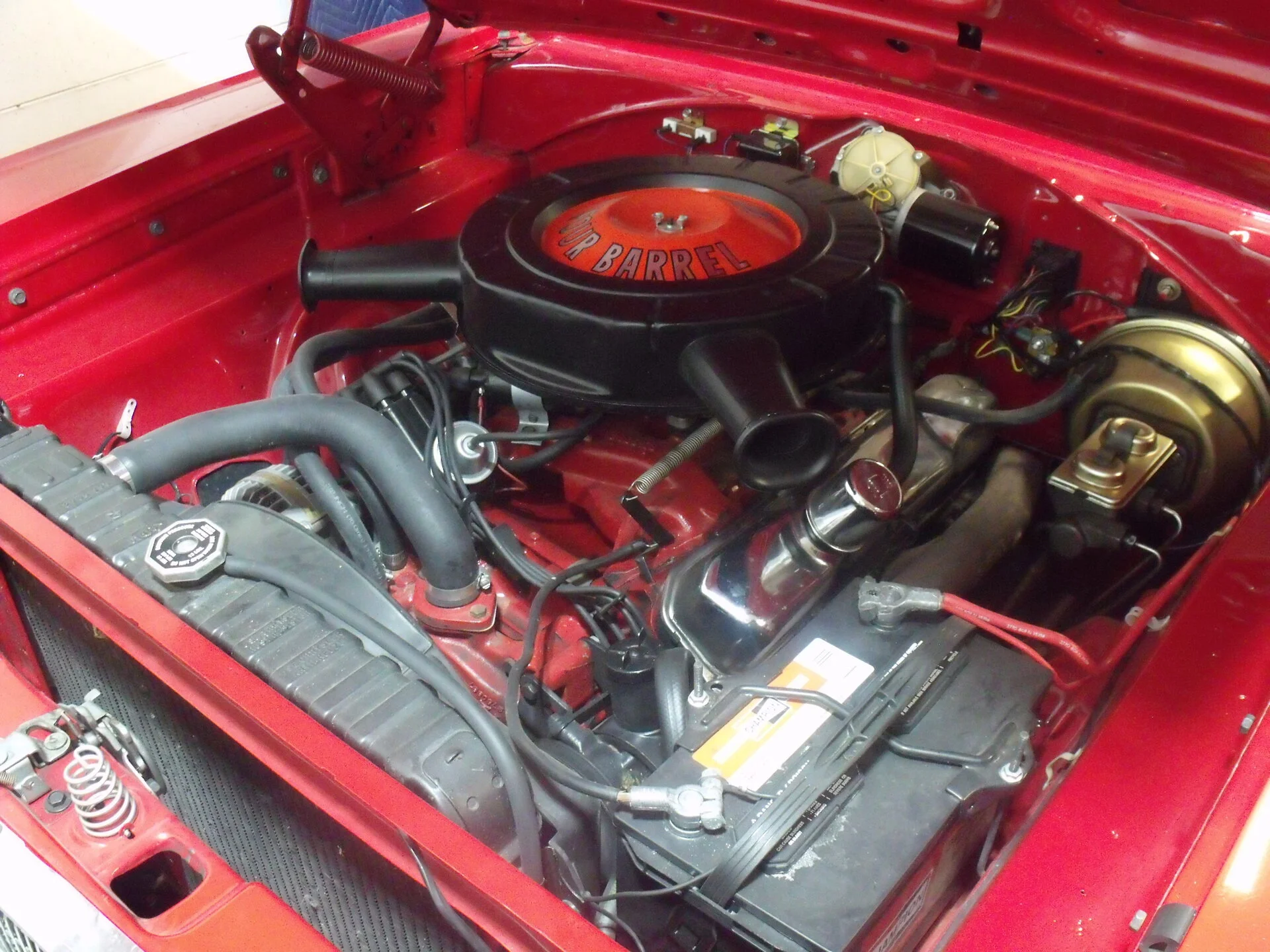

When I did my Dodge, I had bad results with PSF, and ended up changing it to Transmission fluid ( like was used when my dodge was new)... Worked much better with the trans fluid.... I cannot remember if I used Type F or Dexron though

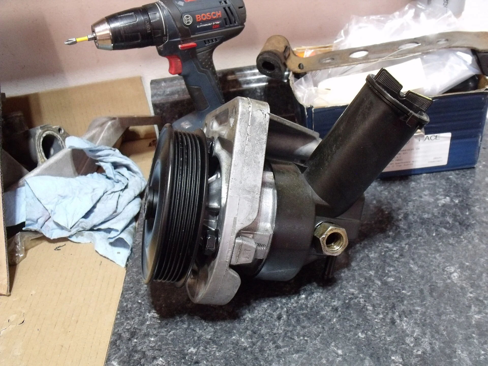

A pic of the finished product...
Oh, and about the service manual being a help.... It made sure I clocked all of the internal rotors and such in the correct way, not to mention installing them the " right side in".....
