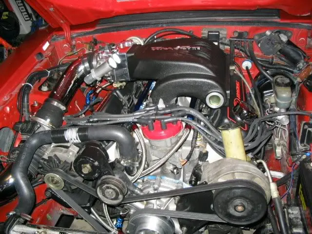

I have an 88 GT and removed my A/C, made a new power steering bracket and fitted for a new belt, I have about 1/2" clearance between fan pulley and the altenator and didn't use another idler pulley.

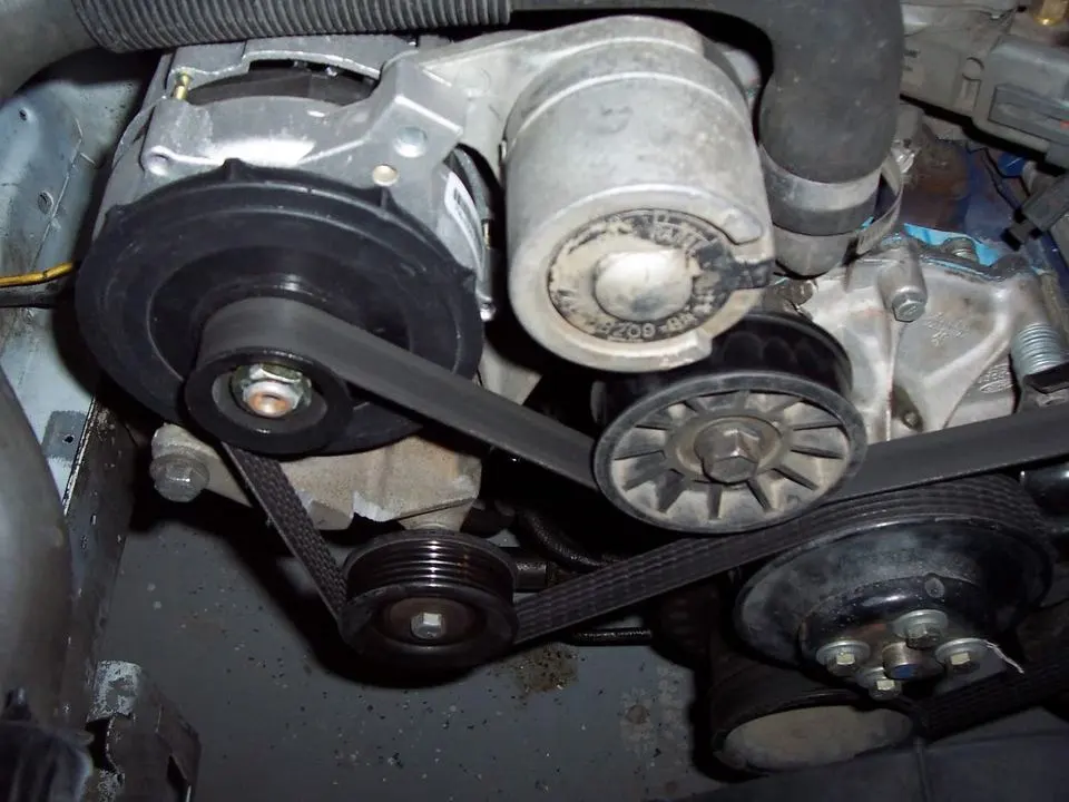

i removed my ac and smog and got a tensioner off ebay...that was all it cost me....like $12 i reused the stock bracket to main tain the correct spacing so the pullies would line up......and no u cant use the stock tensioner once the a/c is removed besides u can drop a goodamount of front end weight.....
ok this one is showing the line up of the pullies

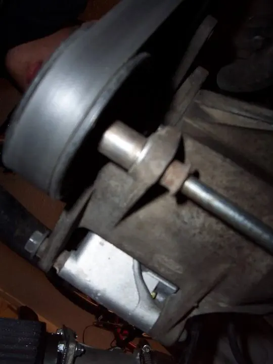

and this one shows the temp. bracket i made to keep the pump form moving

that singe bolt with washers for correct pully alignment is all that mounts it, that lil pos scrap i used was just to keep it from giving in under belt tension, think of it as a stablizer bar...

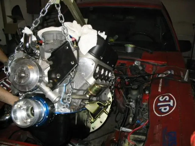

i think it is the FMS delete kit. he did use the little power steering bracket(that holds the A/C and pump together) to bolt it to the head. looks like this without the pump on
