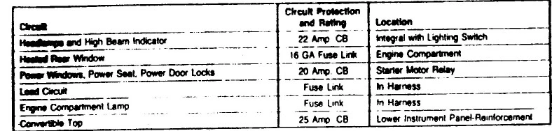

you should have a 20 amp circuit breaker that controls the power seats,windows and door locks located at the starter relay...according to my haynes manual...
it will look like this
Is this in the fuse box? If so, I changed it and it didn't work. Any other ideas?
according to the manual it states the location is the starter motor relay which is the solenoid and i believe thats it you may be able to remove solenoid and have it tested...i know autozone tests solenoids but i don't know if that breaker is part of the test but you can take it by there and check.... and can you post pics....
