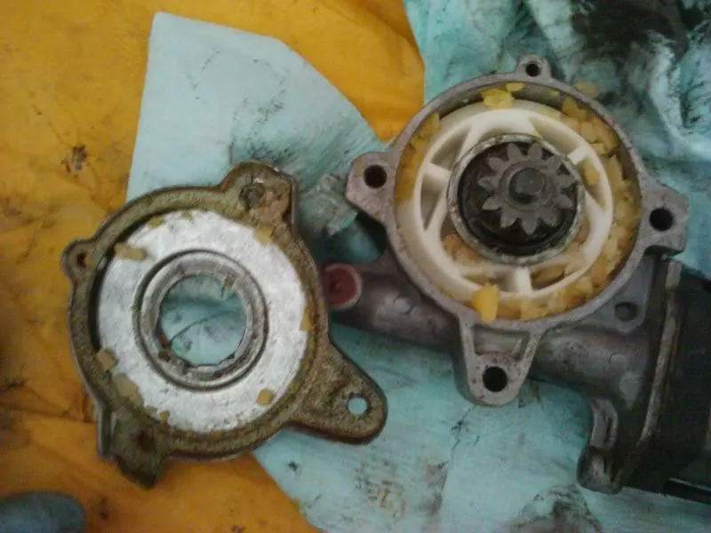

Had garlic.
Fixed it and now all is right with the world.

Eww that looks gross. Gratz on the fix.

yup thats what mine looked like.
