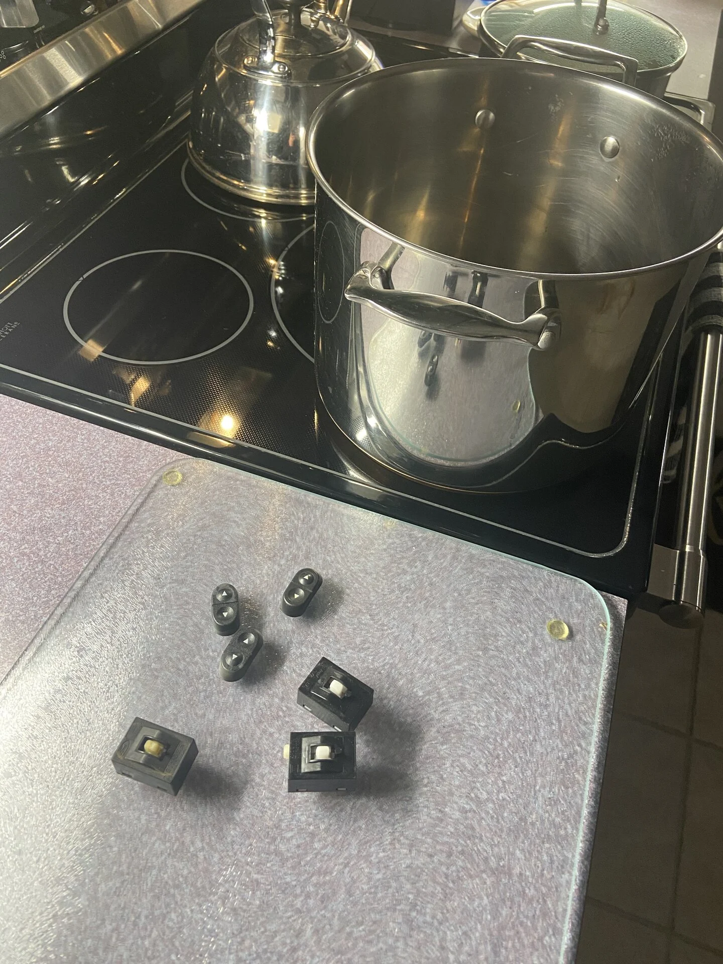

Wife is making dinner. Wants to know what these random parts are on her cutting board. She is beside herself.
I will make one good switch out of these three believe you me.

I shot some compressed air like what you clean a computer keyboard with into the best of the three followed by a small shot of silicone. Snapped the sharpest looking of the three buttons onto that switch and reinstalled on the passenger side. Works perfectly. Now the two new ones can go side by side on the drivers side and we should be in business.
Wait till she comes home one day and finds a set of valve covers in the dishwasher and a resilient film of engine sludge covering the inside. :shrug:
She'll forget all about the switches sitting on the counter. :nice:
