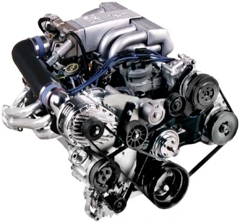

Thanks for the bigger pics. I stand by my earlier suggestion, lower the car back down to normal height and I bet everything will go together as it should.
EDIT: make sure you put the wheels and tires back on the car. The goal here is to "load" the suspension again with the wieght of the vehicle
hmm... take a look at this pic i found, look hard at where the alternator is placed, it looks like yours is in the right spot, check your kit for the piece they have shown there
i would also unload the suspension as suggested

does the pulley line up with the other pullies?
It looks to me like you have the alterantor on the wrong side of the bracket ? if this is the problem your alternator pulley will be set farther back then the others
It's on the right side. It fits between the main bracket and he supercharger bracket. The small ear of the alternator connects with the smog pump via a small twisted piece of metal called the "alternator stay". Pulleys line up the way it is now so we'll see.

Is it just me or does the alt pully not line up with the crank pully? I have no experience with the kit but iy looks like S&B is right and the alt needs to be on the front of the bracket :shrug:
Another stupid question, have you tried rotating the alt 180*?
You guys were right.
I used your advise guys. Came in from the crank side and put the car on ramps instead if jacks. It fit right in there. What worries me is that next time i put the car on jacks or on a lift for some reason, the sway bar will smash right into the bottom of the alternator. This doesn't seem to cool to me but at last it fits.
