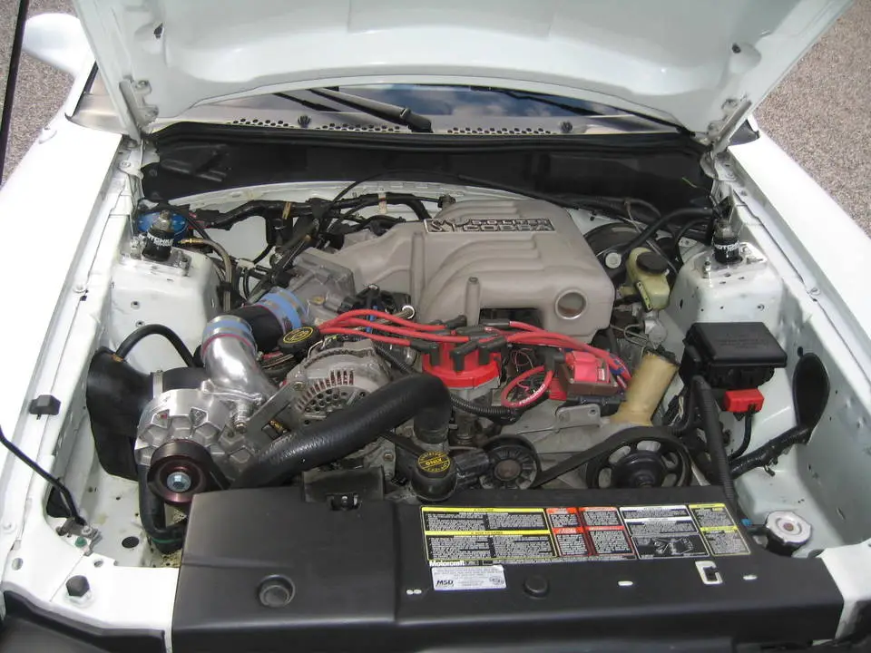

ive had my vortech on my car for over a year, and i had bought the boostmaster pipe and never installed it because it looked like too much work. ive had the tranny out for a couple weeks and decided to work on installing it, and it wont fit. I tried everything to make it fit, and i eventually gave up after destroying my inner liner by cutting half of it off. the only way it could have fit is if it went through the wheel well, and then it would rub on the top of my tire. so where is the best place to buy the afm powerpipe to get a somewhat good deal?
if your talking about the upr boostmaster pipe i went through the same sh-t trying to get it to work, but their pipe is for fox cars, not 94-95 even though they claim it is. i ended up going with the afm powerpipe, which is specific to 94-95. sorry i didn't reply sooner, i could have saved u all the headache u just went through.
